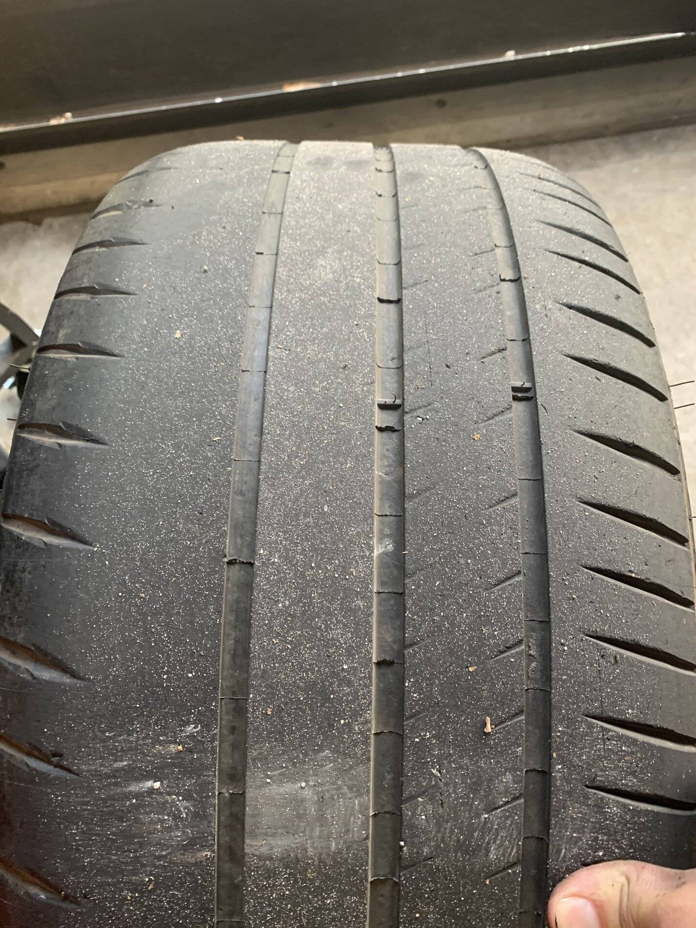

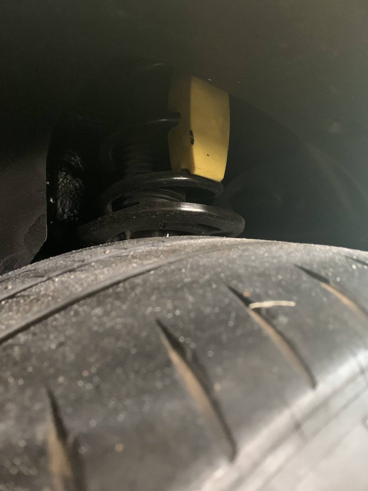

I picked up a 2019 GT350 with 2600 miles as a Ford CPO a few days ago. I noticed at the dealer the tires were quite worn and chalked it up to previous owner driving it as intended. On further inspection at home, I found the front driver side spring still had its shipping spacer installed!
looking further, I found that all four tires are worn similarly as though there’s positive camber. Would having these spacers for 2600 miles cause this sort of wear?I’m pretty upset that not only did the original dealer and owner not pick up on this, but also the Ford CPO inspection missed this. IMO, I’m entitled to a pro rated set of tires (maybe 15% left on outside tread) and damper recalibration at the least. What’s the best way to approach this with the dealer?
looking further, I found that all four tires are worn similarly as though there’s positive camber. Would having these spacers for 2600 hundred miles cause this sort of wear?I’m pretty upset that not only did the original dealer and owner not pick up on this, but also the Ford CPO inspection missed this. IMO, I’m entitled to a pro rated set of tires (maybe 15% left on outside tread) and damper recalibration at the least. What’s the best way to approach this with the dealer?

I have never heard of a base model having shipping spacers. The R model had them because it was so low and could not get on the trucks without having the spacers to lift them up.A base model having it, that would be unique.
Definitely a spacer there as you can see in the picture. The tire wear doesn’t add up either. Should be wearing the interior with a factory set up, but all four are worn on the exterior. The 2019 supplement mentions the spacers, but doesn’t distinguish between 350/350R.
