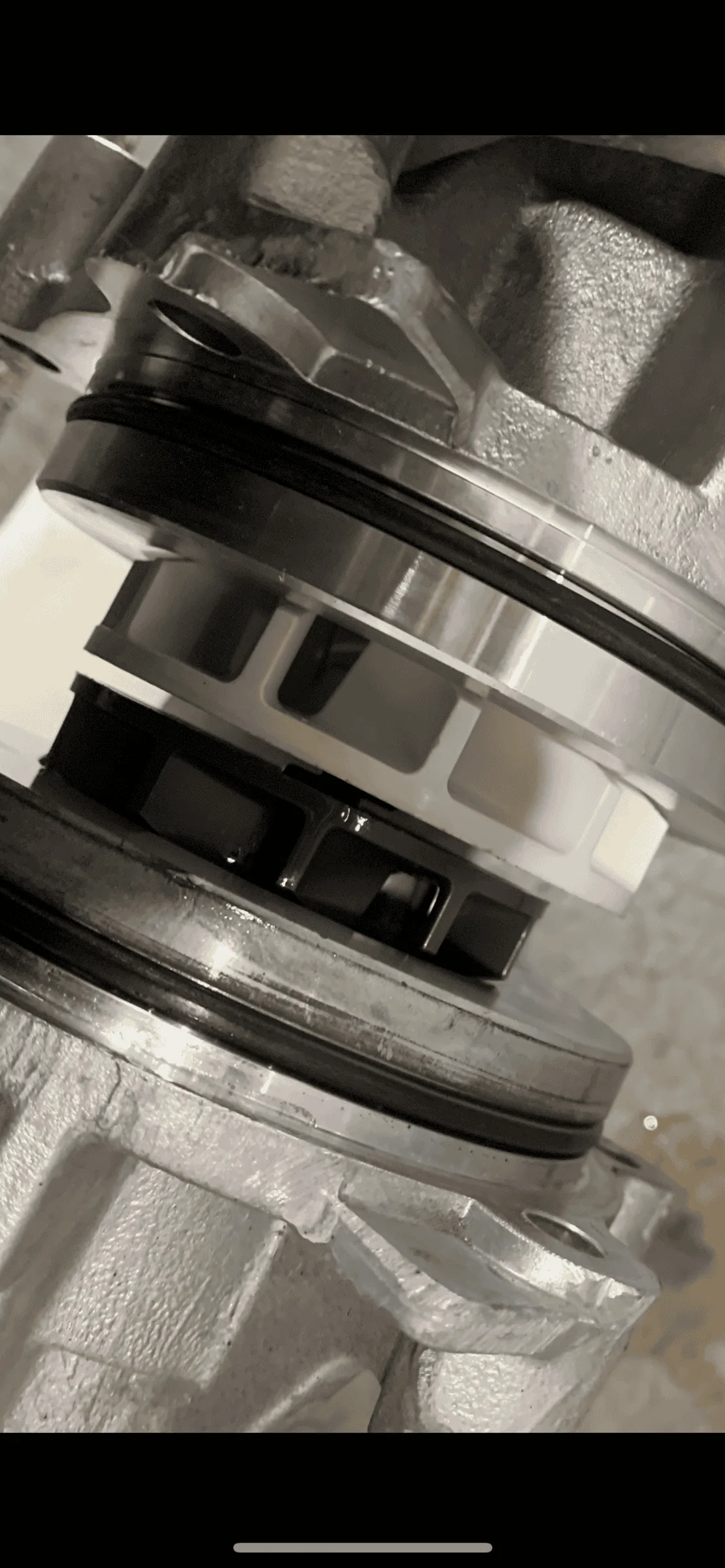

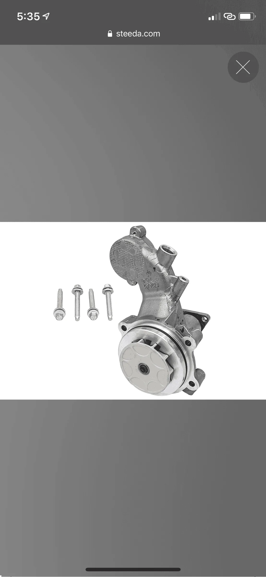

it looks like from the pictures the Ford performance gen 2 water pump has a plastic impeller.
Interesting as there hasn't been any mention of a revised impeller. I wonder if that is a heavy duty composite material that maybe won't implode like the earlier factory assembled plastic impellers?
Has anyone who may be following this thread purchased a Gen 2 FP water pump to confirm the impeller type?

I purchased 1 about a month ago. Car is definitely running cooler, 10-15 avg but to be fair I did do a more involved burp procedure. The impeller is much bigger than the OEM one but it’s still plastic. Came with all hardware and a new pulley. No complaints.
