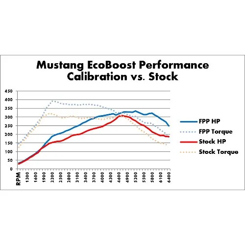

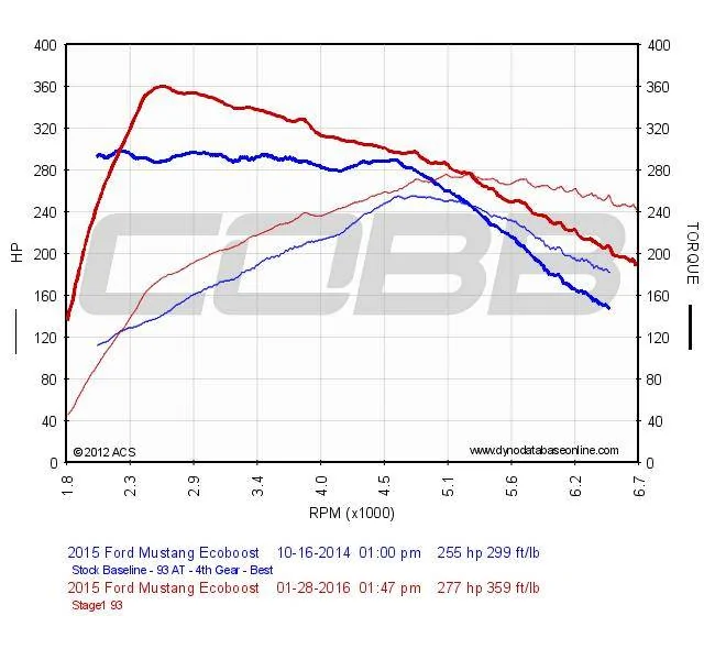

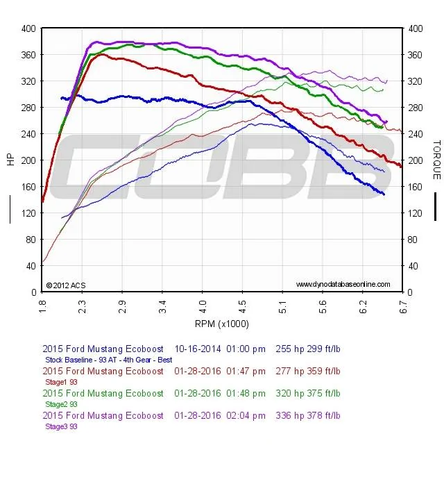

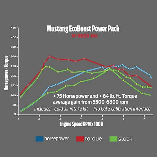

People say the Cobb stage 1 is basically FP tune, heres some dyno graphs and ford charts I use 93 octane anyway. One last question. Cobb stage 3 requires Turbo back exhaust. (Is mine considered turbo back)? If I use a CVFab 3.0 catted Downpipe, running into 2.5 inch Roush Y pipe, then stock 2.25 piping then goes into my 2.5 AWE touring axle back., is the 2.25 pipe going to be massively restrictive? or should be fine and still considered turbo back.
Ford perf link 91+ octane
https://performanceparts.ford.com/part/M-9603-M4
Cobb stage 93 octane (there's a 91 map too) he said, for when you cant find 93 octane.
https://www.cobbtuning.com/ford-mustang-ecoboost-stage-power-packages/

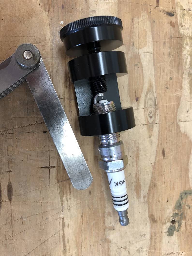

My NGK 6510's came gapped at .035. I slowly and care fully closed the gap until I was at .028. There was one I had to open the gap a bit on and not going near the center electrode with small needle nose pliers opened the gap.

You don’t want to touch the electrode at all really right? You grabbed the top metal piece with pliers and pulled up? I will prob buy some plugs
Can you keep re gapping them every 10k oil changes? I’d rather do that than buy new all the time

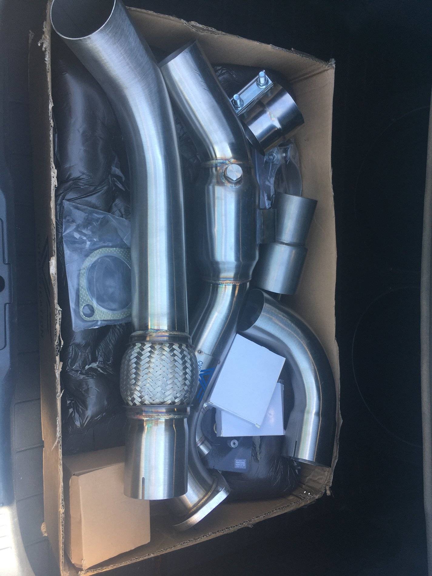

Installing cvfab catted dp later, I bought a 2.5 ID to 3.0 ID stainless reducer, should mate right over both pipes and some strong clamps for them.
