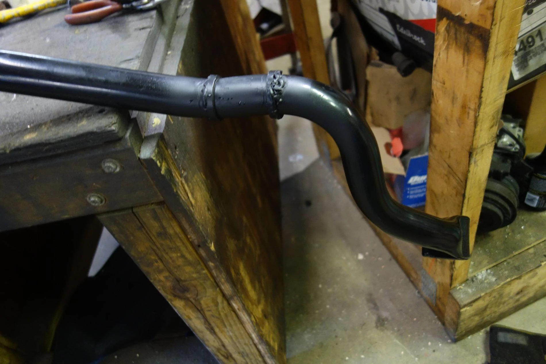

I had to weld in these collars for my setup because of the bushing moving on the bars. I know one collar was only needed but the tech did two per side.
I also used the outer holes. Car corners very well now.
