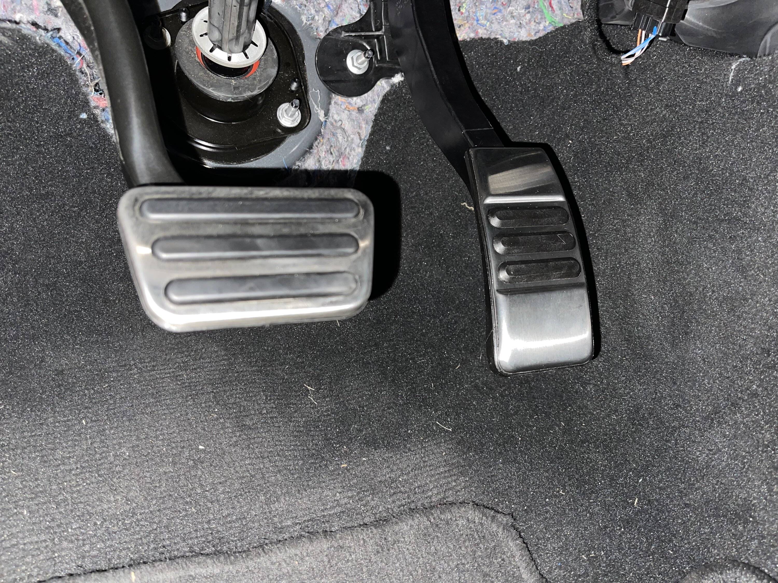

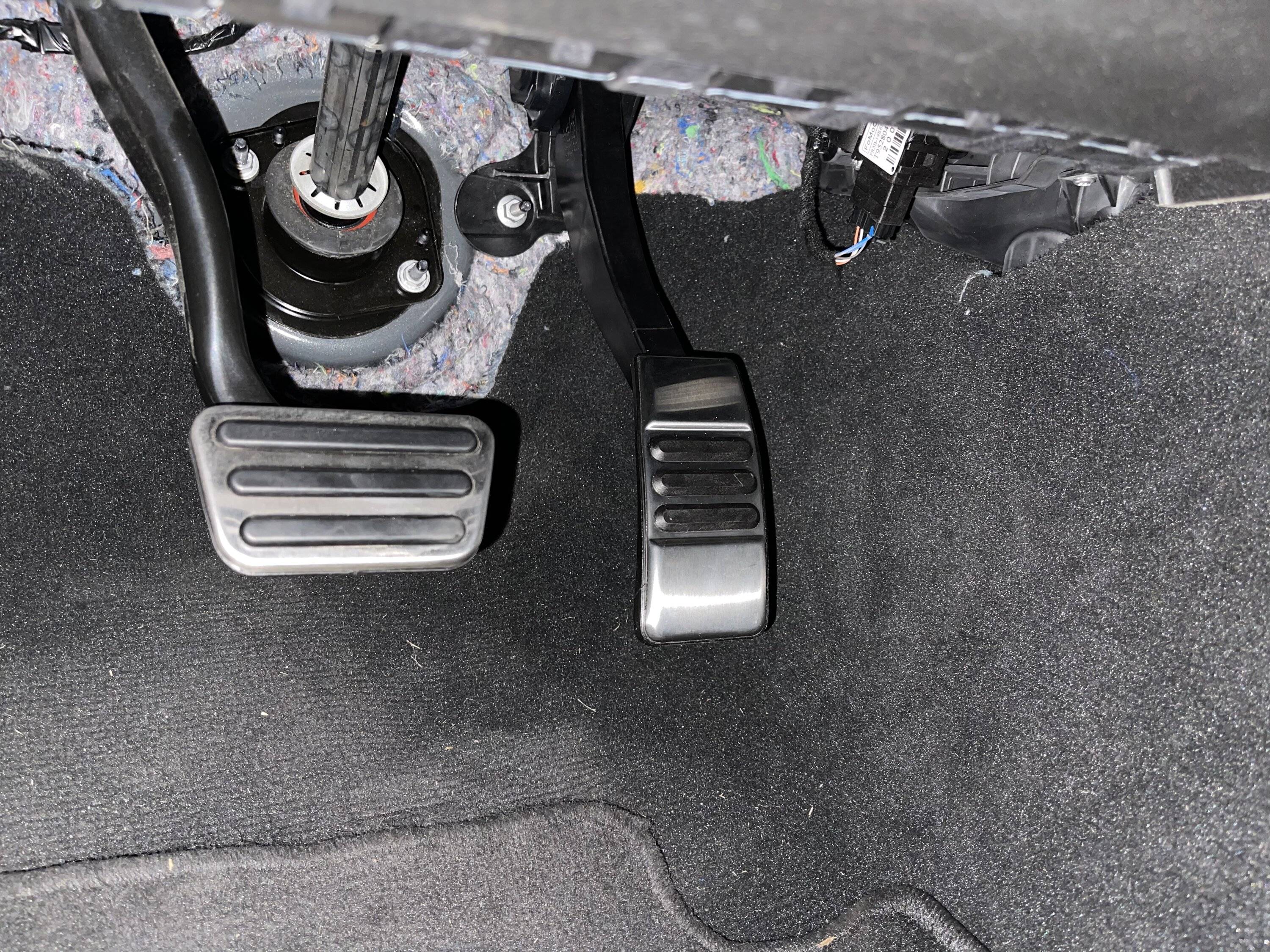

I was on the fence about this for quite some time…..but I figured why not, it’s just one more thing to change my base interior to something closer to a factory premium car…..I am happay with how this turned out….brake pedal was easier than I thought, but I did hurt myself with a pick a couple times trying to stretch the rubber around the steel brake pedal. gas pedal was difficult because of the hard to reach nuts.

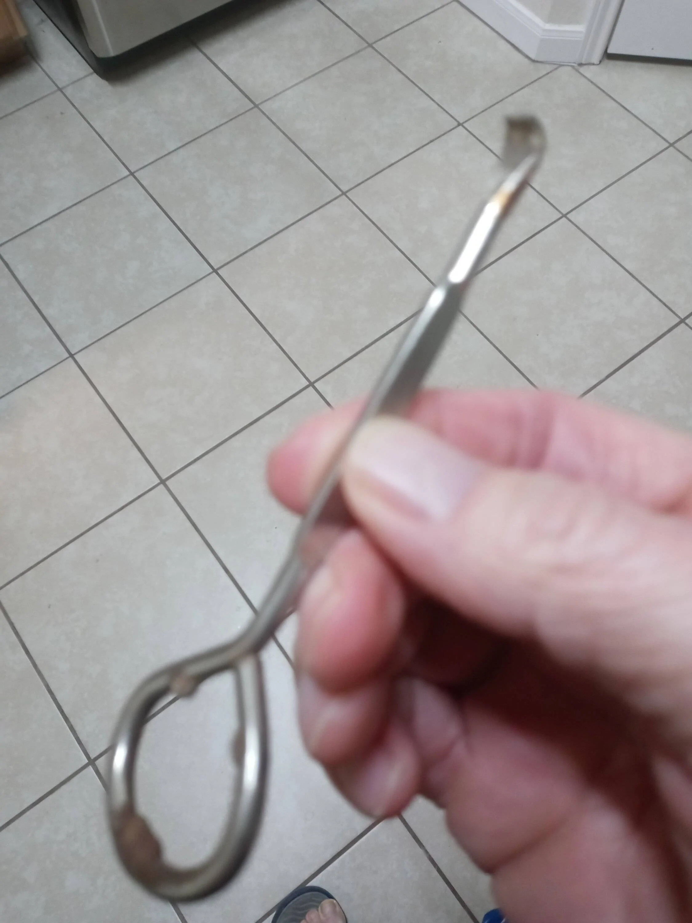

The brake pedal gave me a fit on the fourth side but after getting it on with a pimple popper, I ran across an old paint can opener in my drawer, if I ever do it again I think the hook end will be the perfect solution.

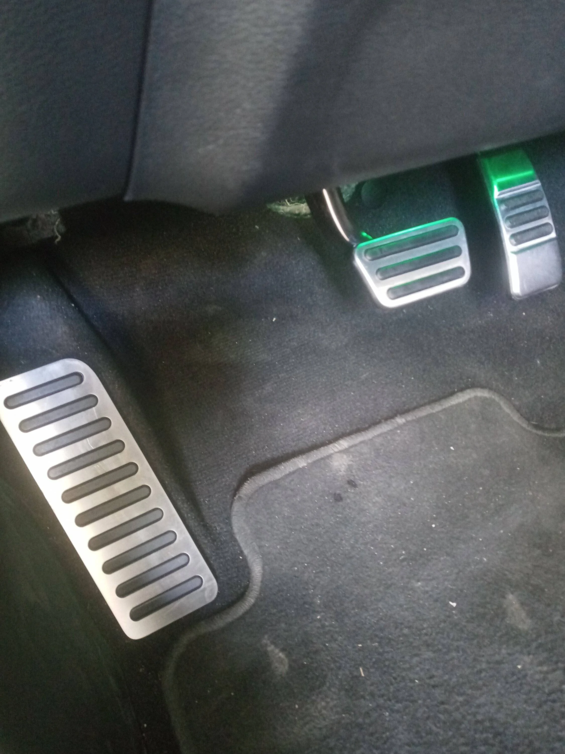

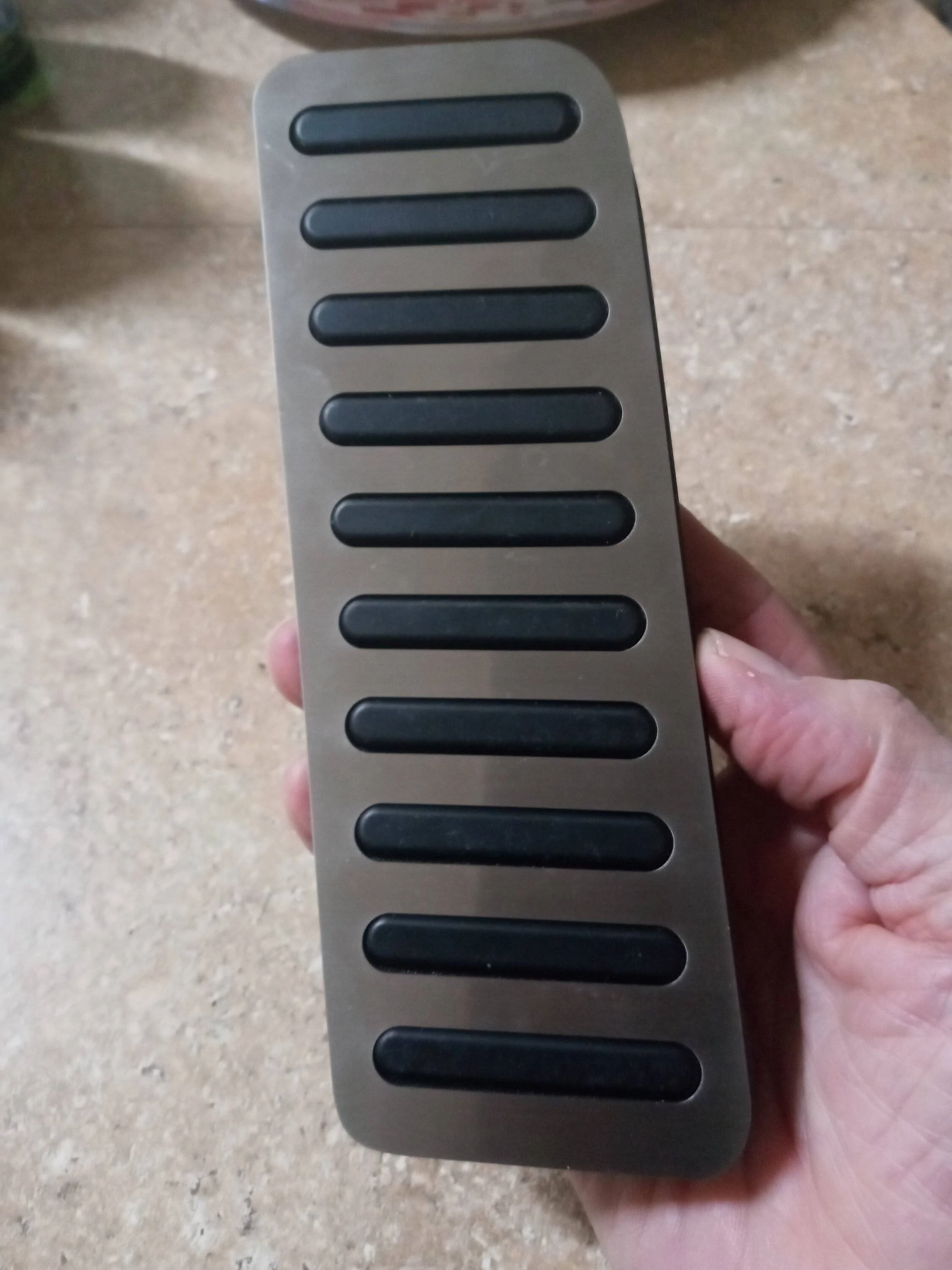

Oh, I also added the dead pedal brushed cover because it looked even worse after adding the premium pedals.

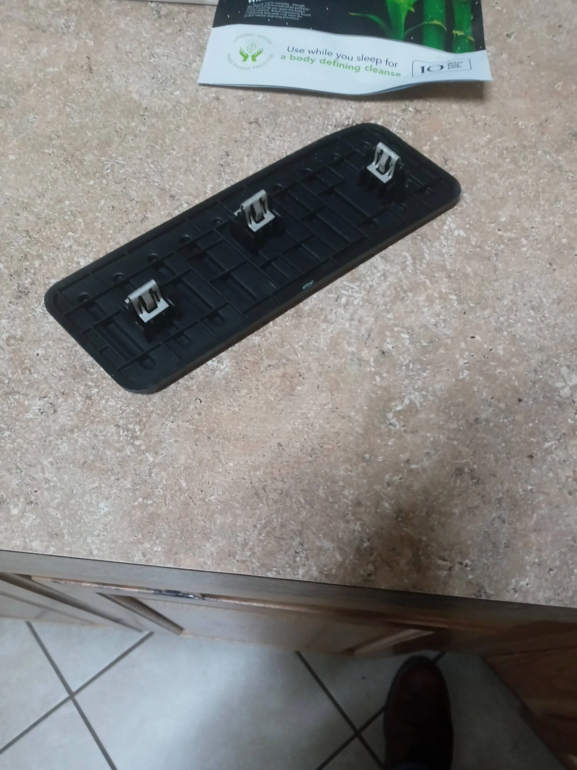

The dead pedal just snaps out with your fingers, which makes prepping it for the stick on cover much easier than when it's in the floorboard.

I haven't seen the 22 dead pedal, but mine is a 2020 and my woman's is a 2021 and they're identical.
If your dead pedal is plastic and just pops out using your fingers and looks like mine in my original pics, then it probably will.
