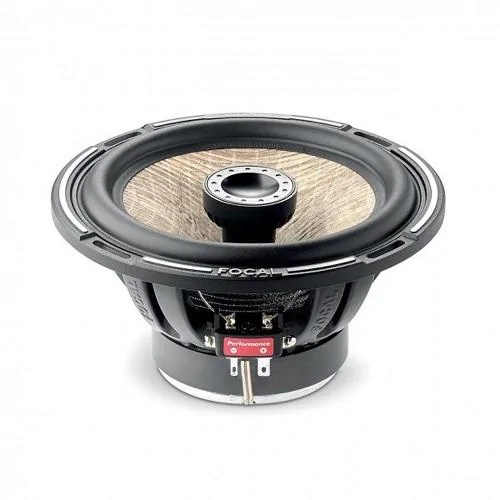

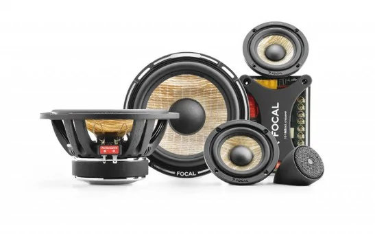

Anyone here running these Focal Flax Cone 3-Way Component speakers in their S550?
I'm contemplating upgrading my factory Shaker 9 speaker system with these Focals for a bit more clarity and fidelity.
Rear stage will be upgraded with the PC165F 2-way coaxials pictured below. All up, a ~$1k set of speakers.

You need fabricated mounting rings as the readily available mounting rings from Metra et. al. are too thick for the Mustang. The midbass will hit the door panel if you use them.
Just watch the entire series from 5StarCarStereo on youtube on the S550 Mustang. They install the Focal Flax 3-way set in there.
