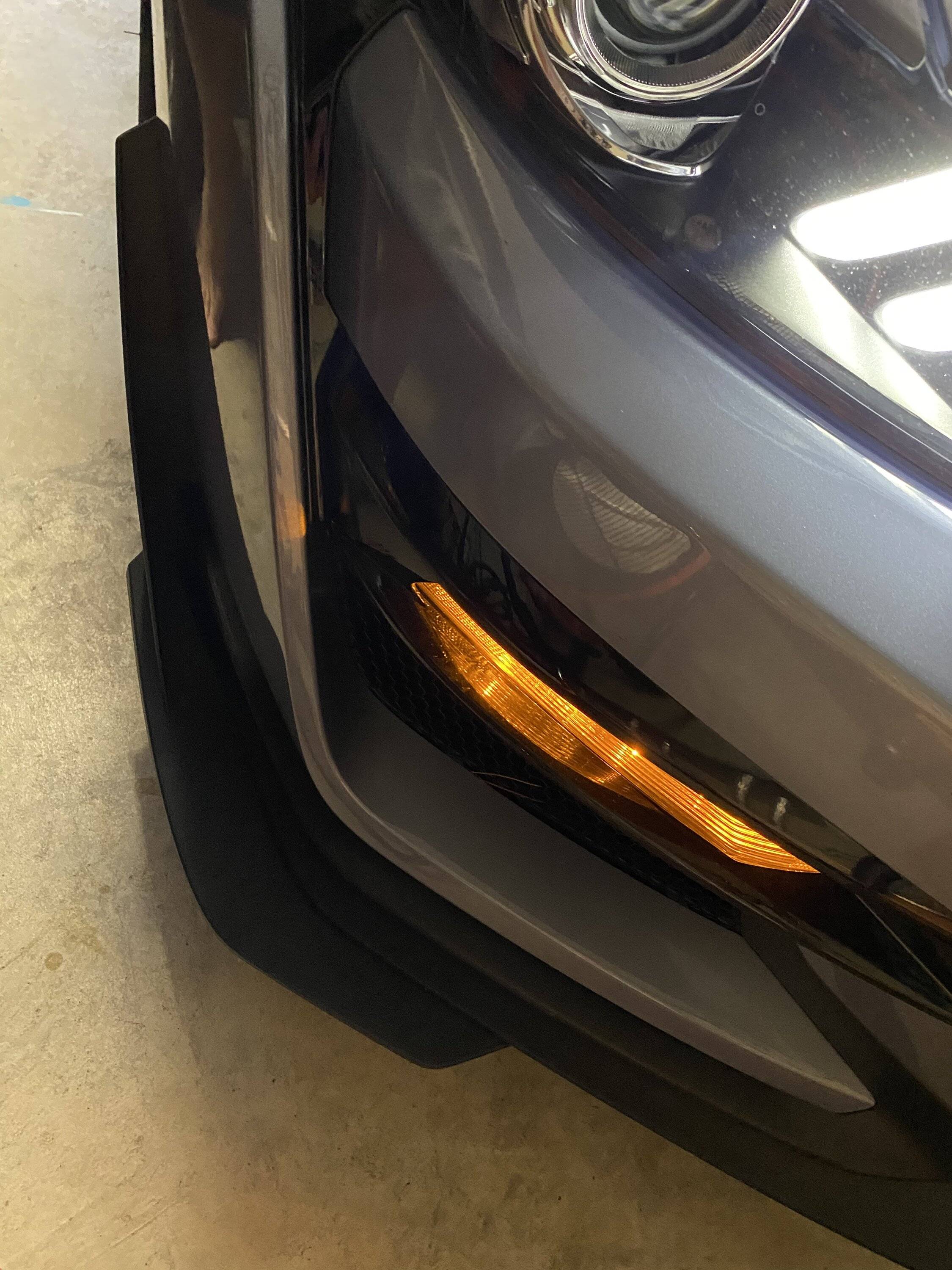

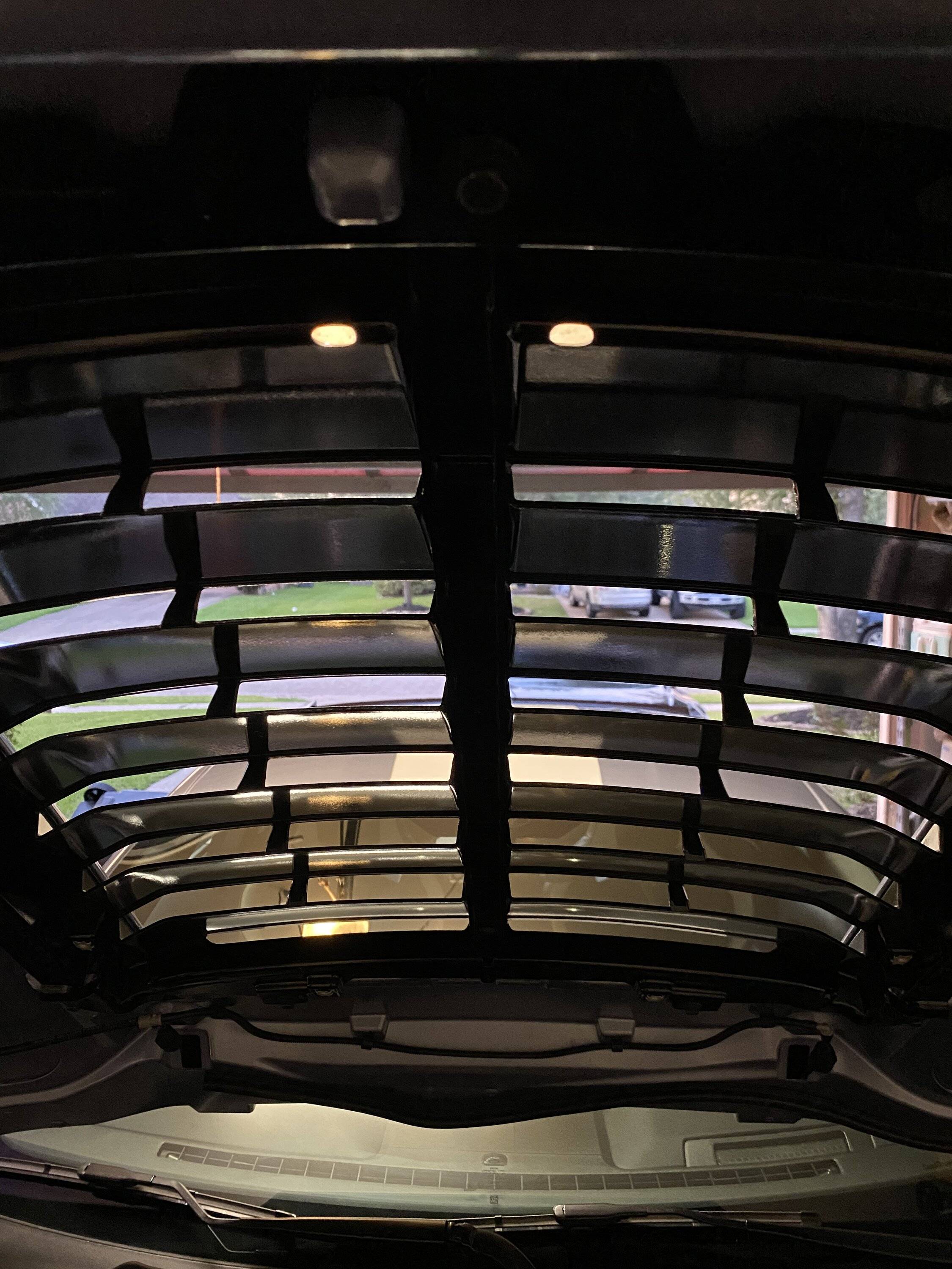

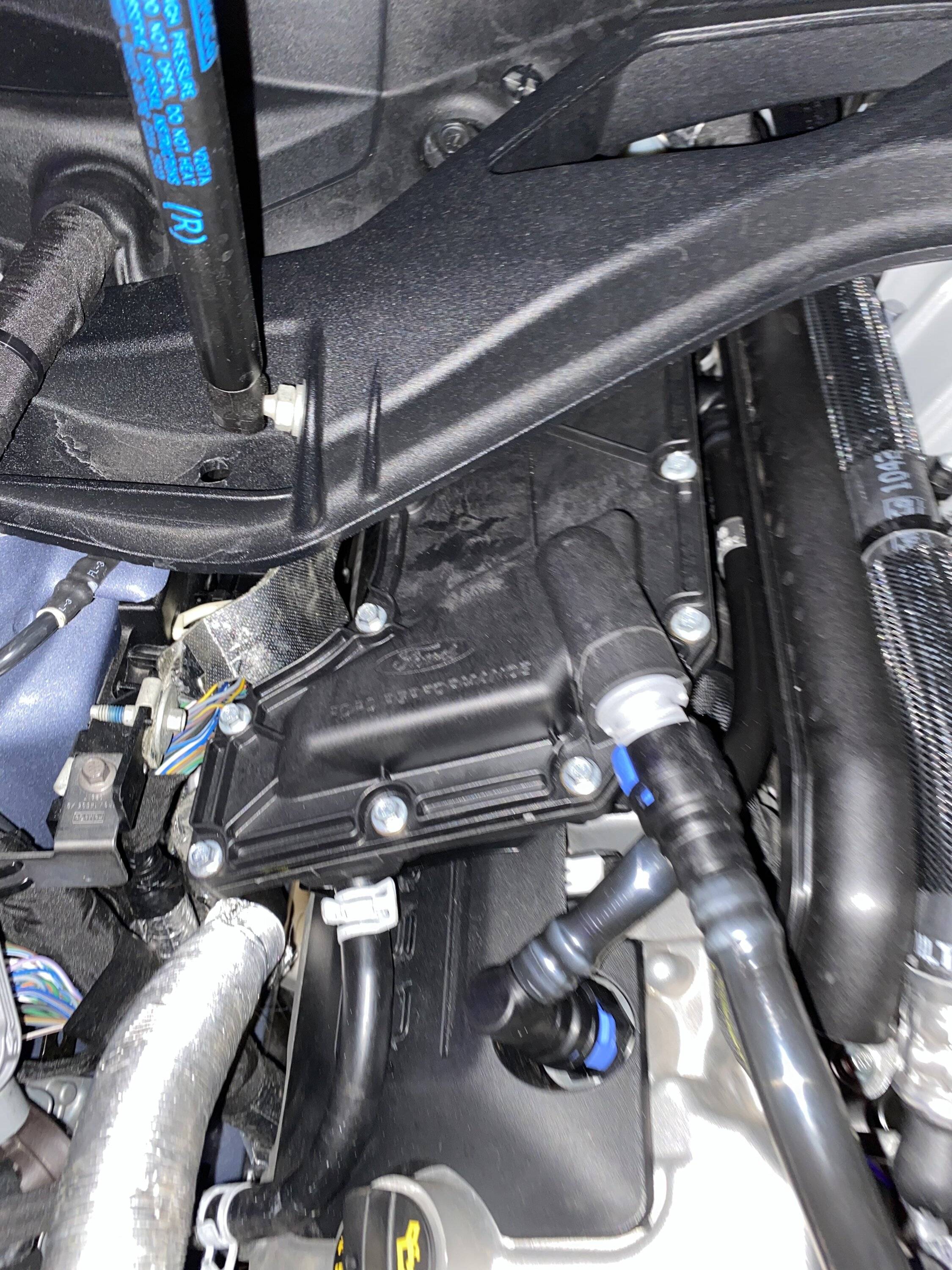

Not really but did use some tools. I did need one wrench for the jam nut on the 90 degree fitting for the oil separator.
Wickers on. Oil separator in. Rain tray removed. Not a bad job. Took me about 1.5 hours for all three.

The oil separator was standard Ford Racing instructions so they were good. The Wicker and Gurney Flap left something to be desired, but they are pretty self-explanatory if you are somewhat mechanically inclined.

What he said. The separator instructions are good. Wickers pretty self explanatory but the instructions did not make mention of the metal snap in clips that the smallest screws go into. You will see 4 square holes, 2 each side on the bottom of the front splitter they snap into. Just line the wicker up and make note of the 6 screws in the fender well, 3 each side, and the 8 screws, 4 each side, you remove from the bottom of the front splitter.

I installed the the wickers and oil separator on my 2020 so that learning curve helped a lot as far as my total instal time.
I too don’t recall the repositioning of the wires from the last install. I think that’s a new step. It moves that wiring harness a little away from the metal 90 degree fitting installed on the valve cover for the oil separator.
