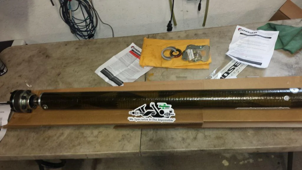

Pretty sure the confusion is coming from free-revving response VS in-gear response. It (driveshaft) won't do anything for free-revving response.

I had over 50 passes on the car and my 60 foot times were just about identical after I got enough seat time. I took the car to the track twice after I installed the DS and I could not improve my time over my best passes. It was my experience with one. I am not opposed to them, but if I am going to spend a grand on a speed part, it had better show a return with no effort.

Curious, how does a ds increase throttle response? Push on pedal, engine revs...never heard drivetrain being part of the equation...?
My experience w/ Al shafts is that they're good for a tenth or so depending on application. Noticeable reduction in NVH, however.
CF ds is too rich for this po' boy.
Less rotational mass has something to do with it.
I also have a lighter flywheel so the combo is really helping spin the engine faster.
I'm not sure why the shift effort was reduced unless something was wrong with my OEM driveshaft - it felt clunky before.
