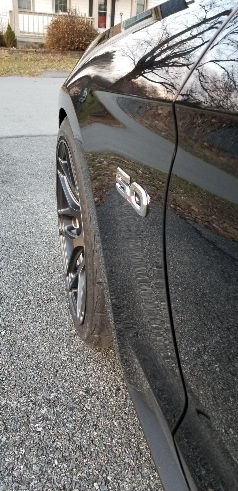

I think a 9.5 would be a perfect fit for a 275, there is just a tiny bit of stretch on my 10 wheels with them. I think my next set of tires I'll probably go with 285's now that I know they will not rub anywhere.
Sorry for not knowing but what does this mean "there is just a tiny bit of stretch?"
Nagare
Feb 1, 2017
58
4,037
2,256
Ft Lauderdale
2017 Lightning Blue V6
Fit almost perfect but no rim protection.
Braski
Feb 4, 2015
79
2,084
959
Lancaster, PA
Traded 2015 Blk GT Prem PP on 2019 Corvette GS 2LT M7
Stretch is when he wheel is slightly wider than the tire. Supposedly it's ideal for handling but I prefer the look of flush or even a little bulge. Bulge happens when the tire is wider than the wheel.
