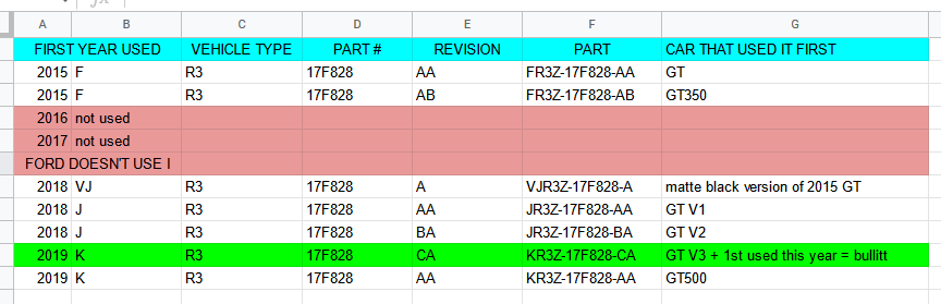

the data table below is what the data has produced.

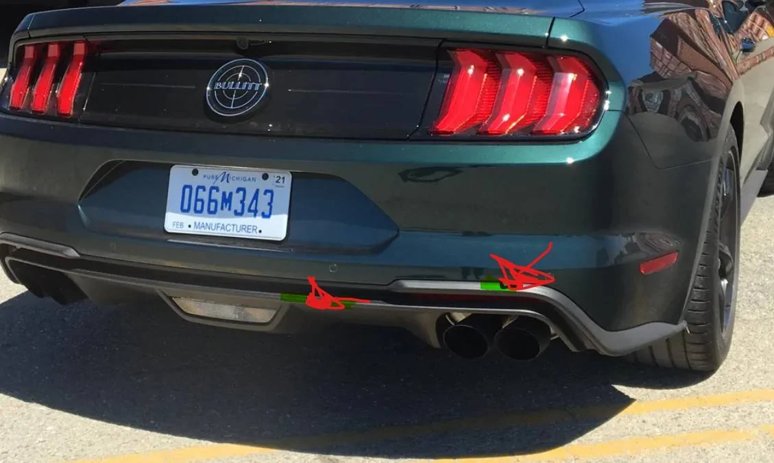

what are the parts number for the bullitt
rear diffuser
i need these two parts

That is a single piece!
KR3Z-17F828-CA (as mentioned above).
Take your VIN to your Ford dealers parts department, they can help.
They can also convert that part number to a FINIS code for ordering in the UK.

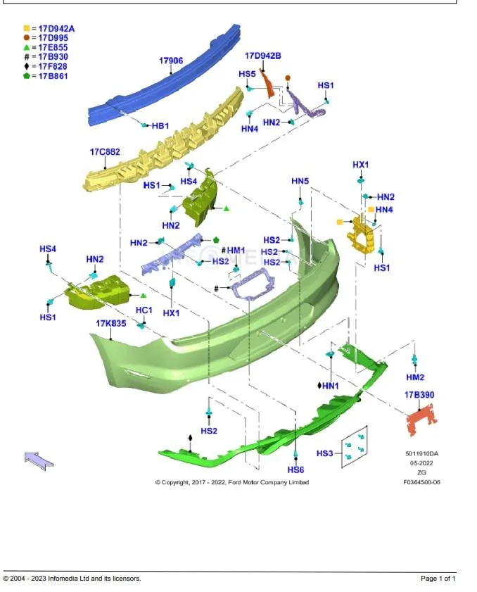

ok been ringing up ford
they sent me a illusration of the piece, but on the bullitt there are reflectors on both sides and two adjoining pieces and relector in the centre
another conversation i was told the piece was
2263535 oem: KR3B-17F954-CASYZ9 (BUMPER EXTENSION)

The reflectors and the reverse & fog light in the center are seperate parts.
