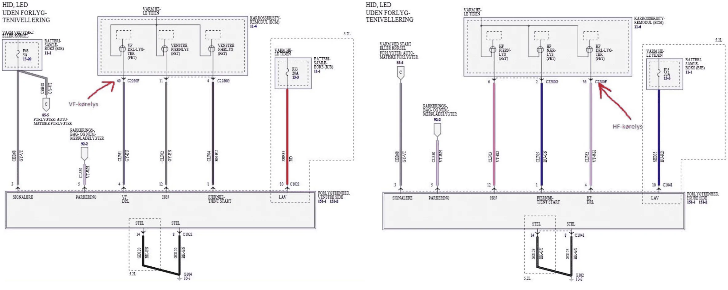

The vinyl on the headlight to hide the orange marker is a solution yes but it looks cheap and not good to be honest.
This is the diagram for the export headlights
Don't mind the painted arrow and red text - it was for my own project when I got my car to get taillights to stay on even during daylight.
And I know the text is in Danish but it should e quite easy to translate and else throw me a DM and We'll figure it out :fingerscrossed:
Thank you so much! Now I just have to admit that I'm a complete idiot and need to start at square one to understand this lol

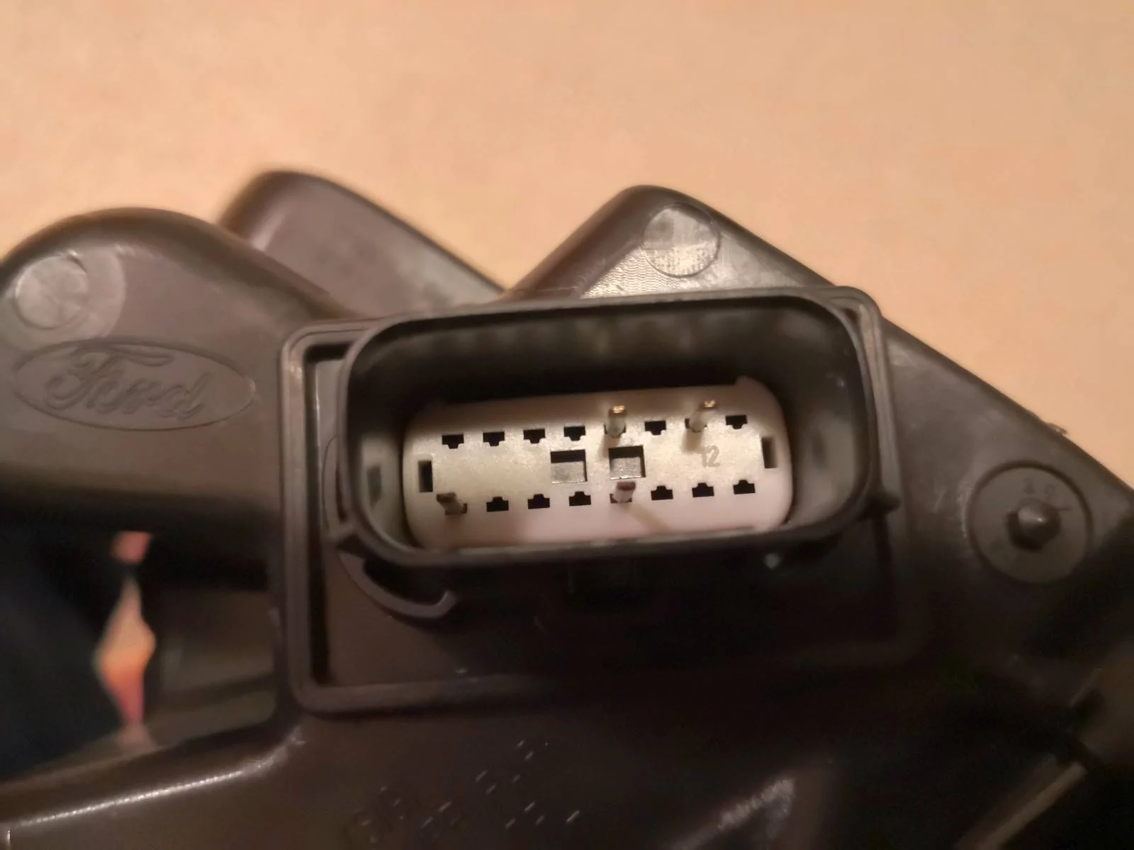

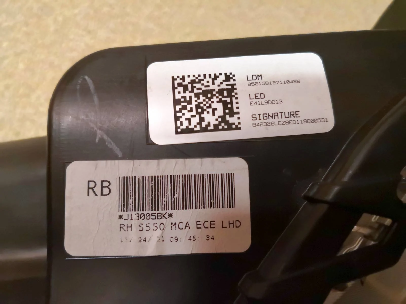

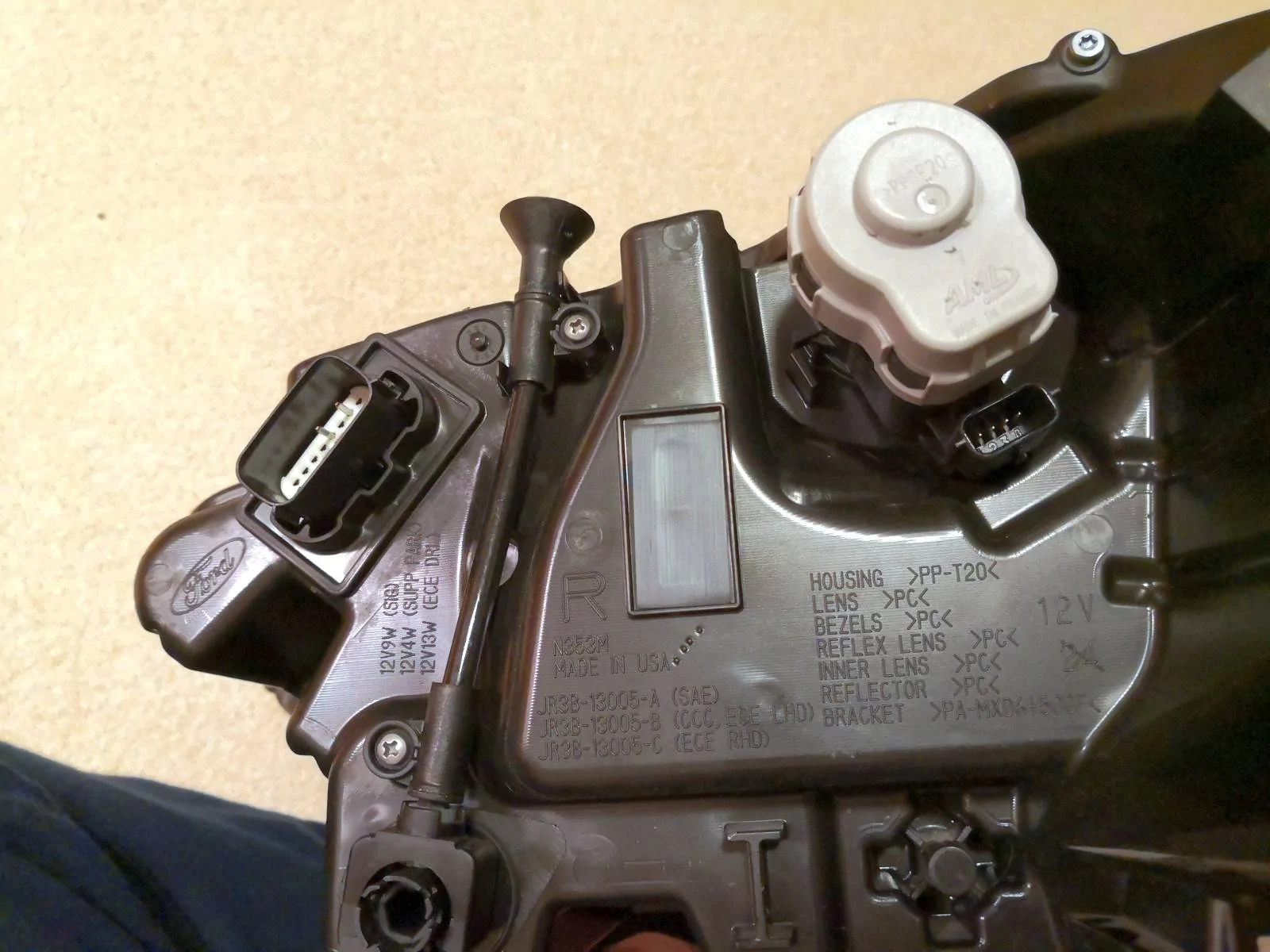

For what is worthy here are some pics of the right headlight of Euro LHD Mach 1. There are two connectors. The one on the right is four pin right under the white cap with "AML Made in France", it has the pin labeled 1-4, the other one is multi-pole with only 4 pins mounted and only one labeled 12.

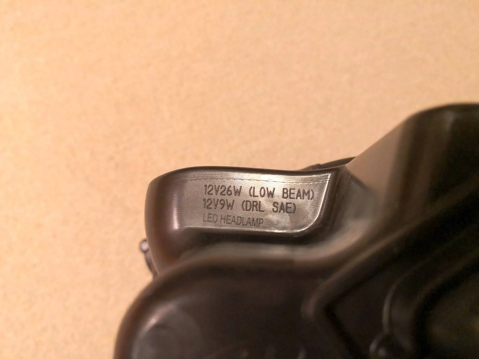

Apart from the different identifications lists and other text written on the light back, I found following light/sources descriptions:
(below the multipole white connector)
12V9W (SIG)
12V4W (SUPP PARK)
12V13W (ECE DRL)
(on the outer body mold)
12V26W (LOW BEAM)
12V9W (DRL SAE)
This one is strange, I would guess DRL SAE stands for the DRL in US, why do they put it on the Euro lights which seem to have its own DRL (ECE DRL).
Now the list is missing the high beam identification, plus it is not exactly clear how (if at all) these lists actually should relate to the connectors.
Any comments or pointers are appreciated.
