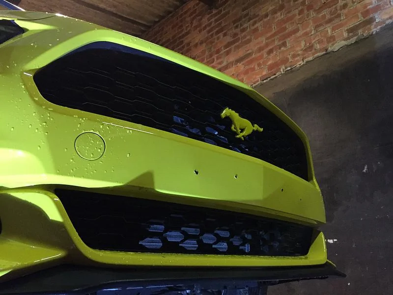

here's what happens without one :tsk:

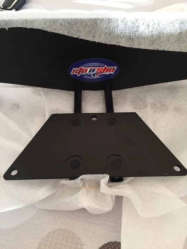

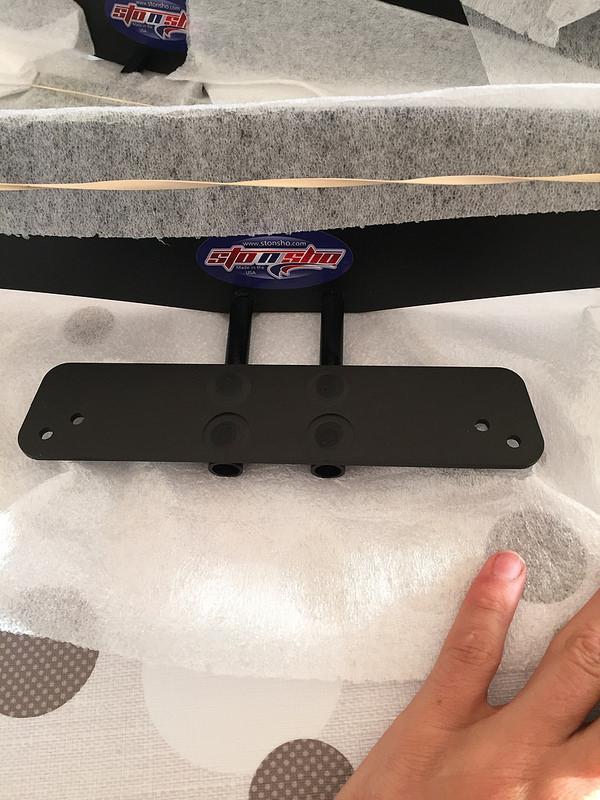

Also, for those interested, here's the difference between the EU GT MT and EU GT AT/EU EB
GT MT
GT AT / EB
