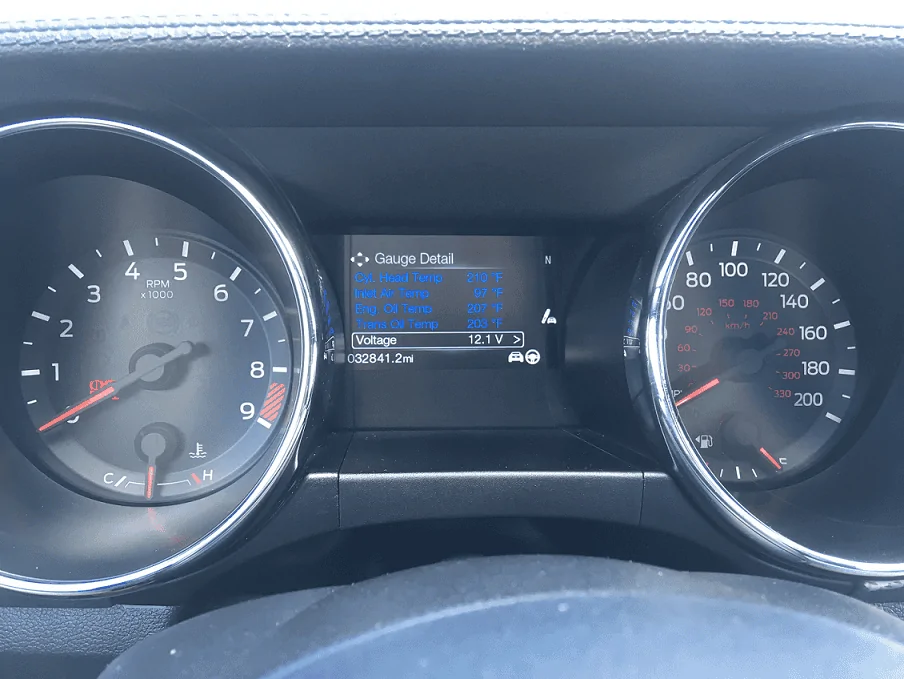

I recently installed a Mishimoto oil cooler and I have a temp sensor in the sandwich plate, which is supposed to have a 185* thermostatic valve on it such that, unless the oil reaches that temperature, it will bypass the oil cooler.
My oil temp gauge, driving on the highway in 6th, indicates 140-150*. If I drop to 5th, and run at the same speed (just at a higher RPM), I can get the oil to go to about 160-170 per my gauge. If I drop to 4th, running at the same speed (just a much higher RPM now), I can get the oil to cross 180, maybe hit 190. Can't tell exactly because it's an analogue gauge with 20* gaps between labeled tick marks. But if I switch back to 6th and cruise at the same speed, the temp drops fairly quickly back down to 140-150* (per the gauge). The temp never really goes lower than that once the engine is warmed. At idle, oil temps slowly climb but don't seem to cross 190*, as far as I've paid attention.
My understanding is that I should be around 180-220 degrees for oil, and ideally 212*. My Dodge Durango, if its oil temp gauge on the dash is legitimate vs. inferred (I have no idea), states 212* cruising on the highway. My Mustang's aftermarket gauge indicates 140-150* on the same drive, on the same day, just in the opposite direction.
I realize that putting the sensor in the oil pan might yield a different reading, but I'm a little concerned I'm seeing 140-150* when you'd think I'd be at at least 185* before the oil cooler ever sees any oil flow. What gives here? What am I not understanding? Or do I have a bad sandwhich plate or temp sensor? The gauges are made by Glowshift. Not god's gift to gauges, but I have no reason to believe the gauge is faulty at this point.
