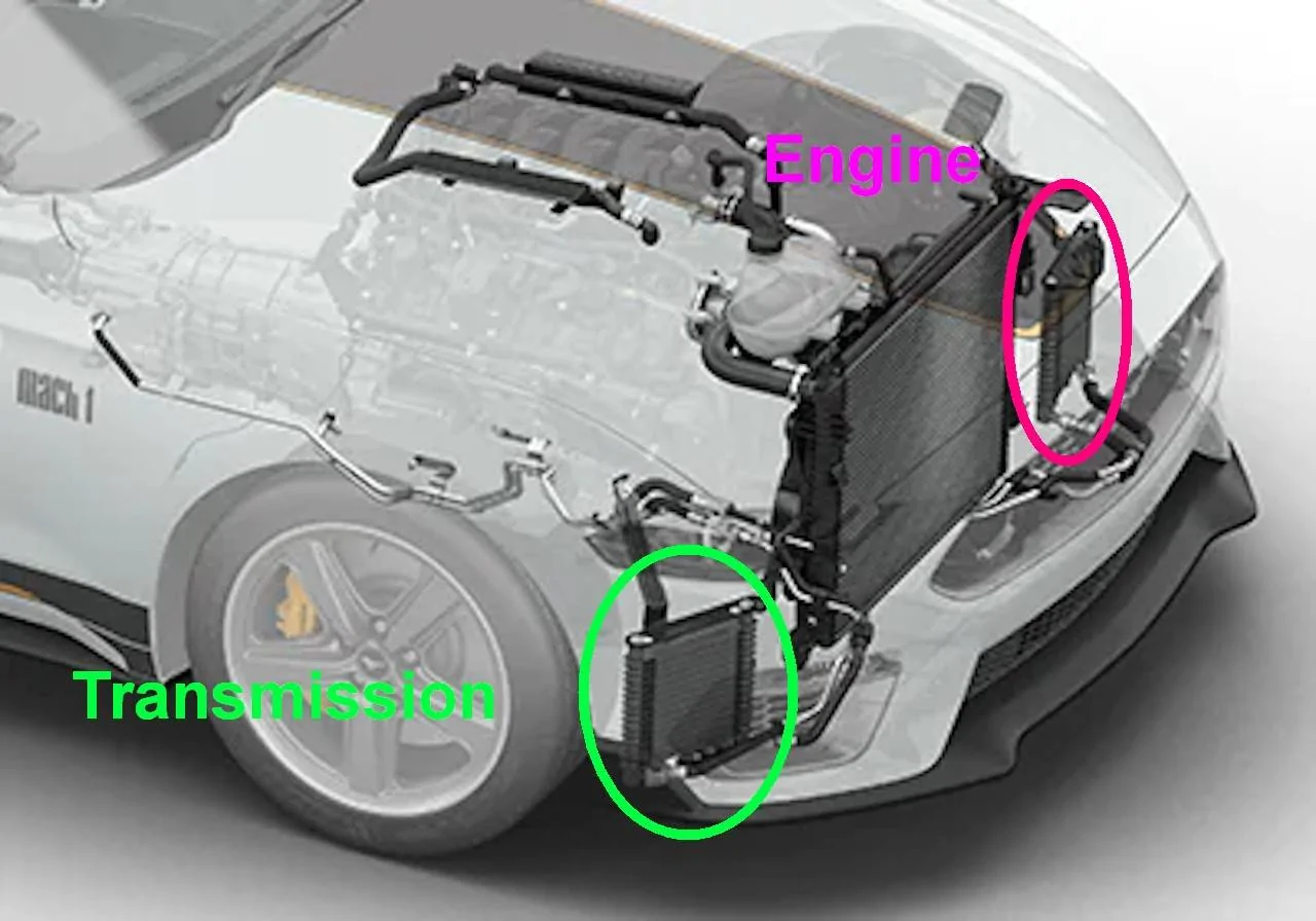

The way the external coolers (from the engine and the transmission) are positioned inside the bumper you can easily bust one without basically touching anything else (including the regular radiator). I am not saying it was the case with the OP's car, but I would not be surprised if it was.

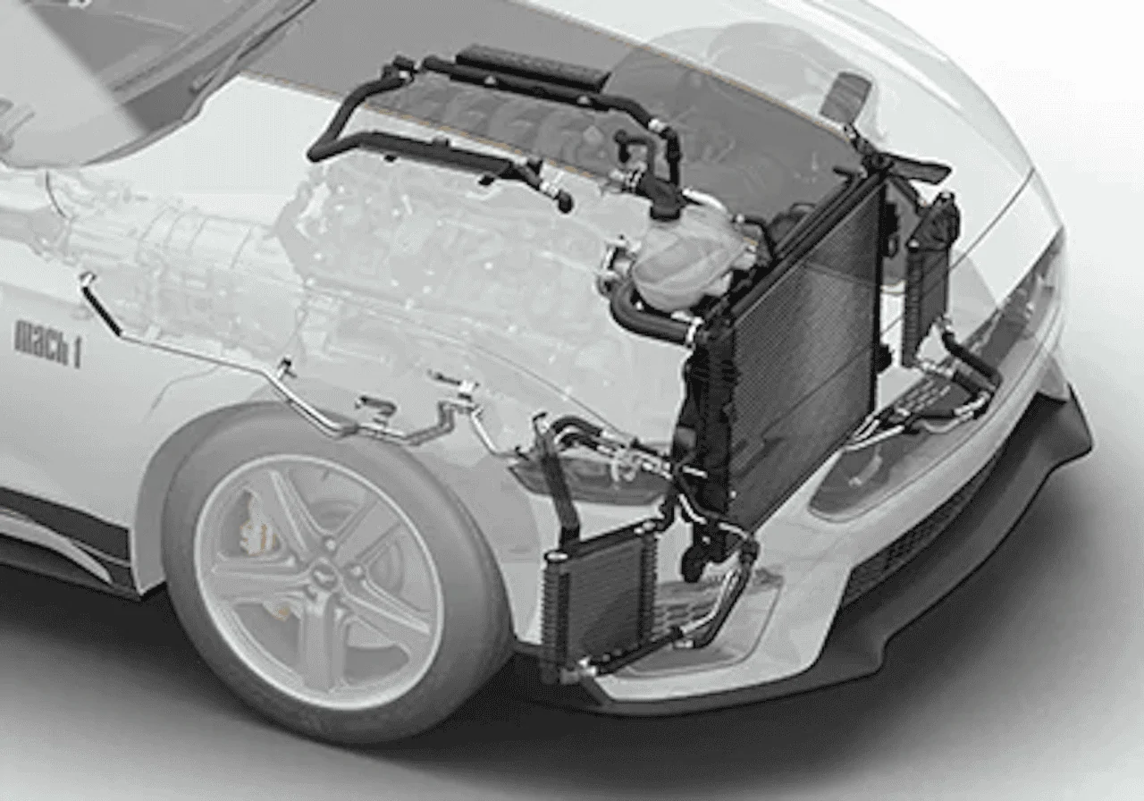

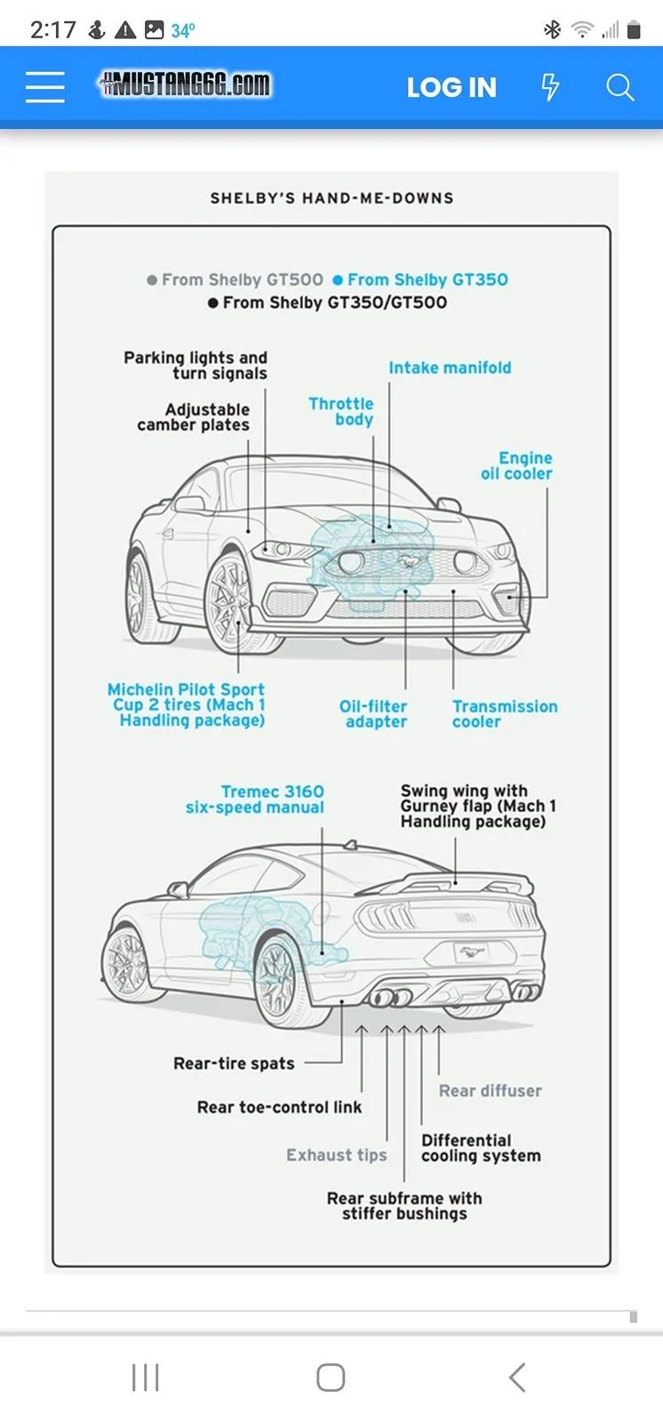

I forgot the Mach 1 gets a real oil cooler and not the fake coolant exchanger one that the GT gets. So yeah, it will be 100% fine post repair with zero risk of any real issues.

Mach 1 uses the Gt350 air to oil cooler. Issue with these is they get easily damaged due to location. Best route is to have ford service department pull a full repair history like others have suggested. I would pay attention to how many miles since repairs to cooler. If recent then I would be suspicious of reasons for selling (other related issues).

Do you have the original source for the image at the Top?

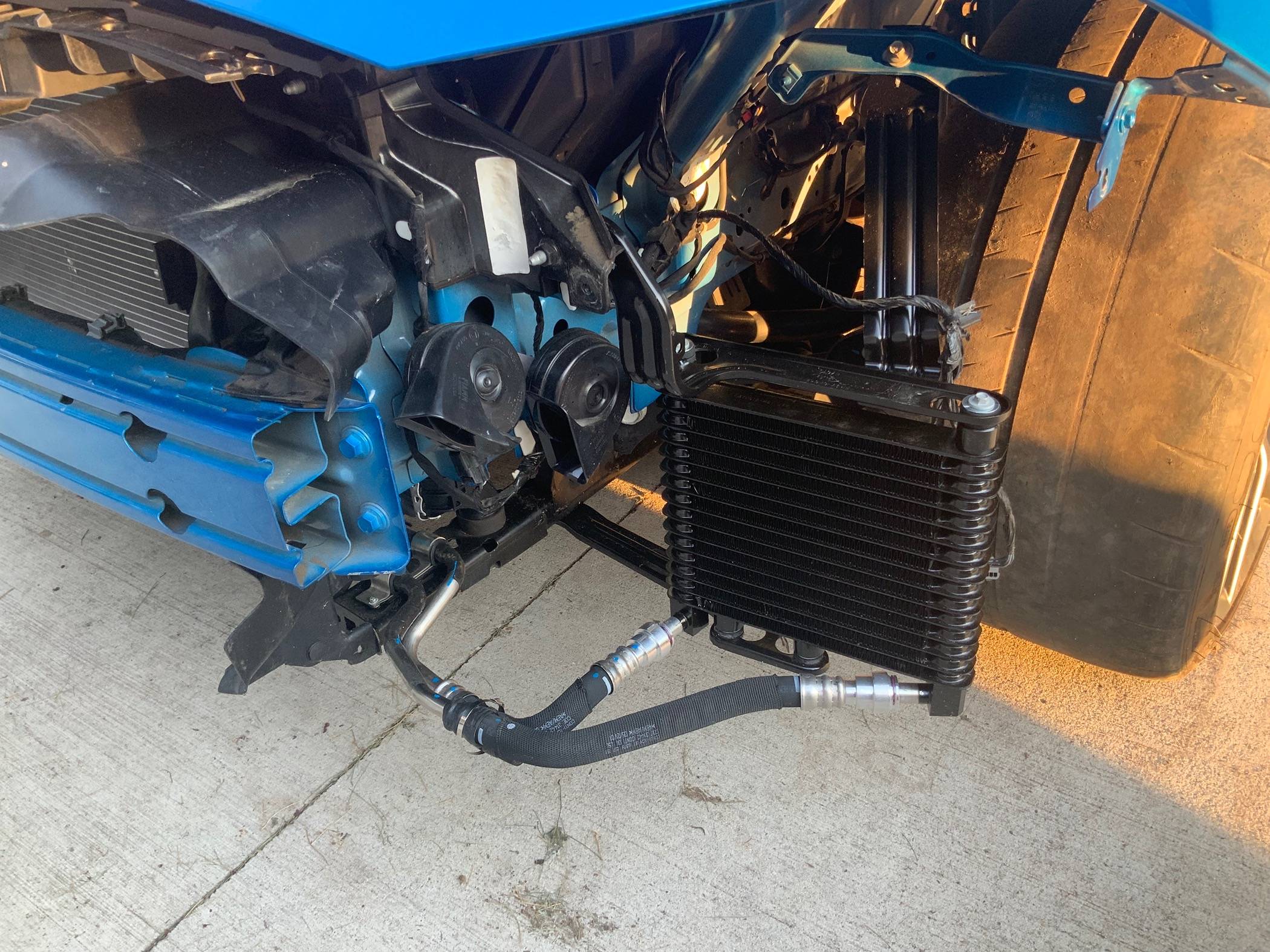

I had to replace my rear diff. cooler after a large brass valve flung up and bent and cracked the cooler. The fluid from the diff. fluid pump only comes on when the fluid reaches a set temp., and it is fairly low flow and pressure. I smelled it before I noticed any leak probably after the second time driving it after it happened. The read diffuser got wet, and only a few drops were noticeable until I dropped it. (the whole story is in one of my threads)
I checked the level and lost maybe a shot glass worth of diff. oil, lucky, but unlucky the coolers were on back order for 3 months. Patched the leak with JB Weld, and disconnected the pump until I was able to swap the new one in. This all happened the day after I got the Mach home, after driving 2900 miles from Granger Iowa. :explode:
If the oil cooler had a small leak from either something hitting it, or a connector issue, a puddle would be noticed before long. If it were catastrophic like that guy that rammed his bumper into a curb in an underground parking garage, you would smell it first, because it's going to spray oil on something hot or you'll see smoke. Even if the line came off completely, you would have a little time to shut it down after getting a whiff or seeing smoke, with 10 quarts.
It probably had a small leak that was spotted by a puddle on the ground. Was the car fax clean of collisions? A fender bender could cause an issue with any of the three coolers.
