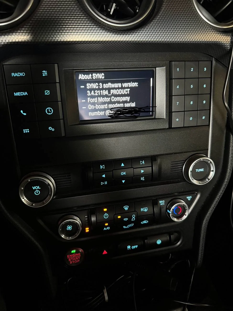

So if I have 3.4 on my 4 inch screen do you think I can just do it?
thirdoptik
Sep 1, 2021
71
United States
2018 Mustang GT - Performance Pack
It may be possible thru Forscan to enable it. There are some whove done it. I think I remember someone I chatted with who updated the APIM and the enabled the drive mode switch
