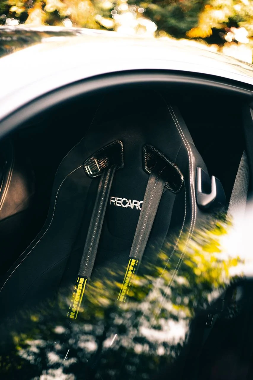

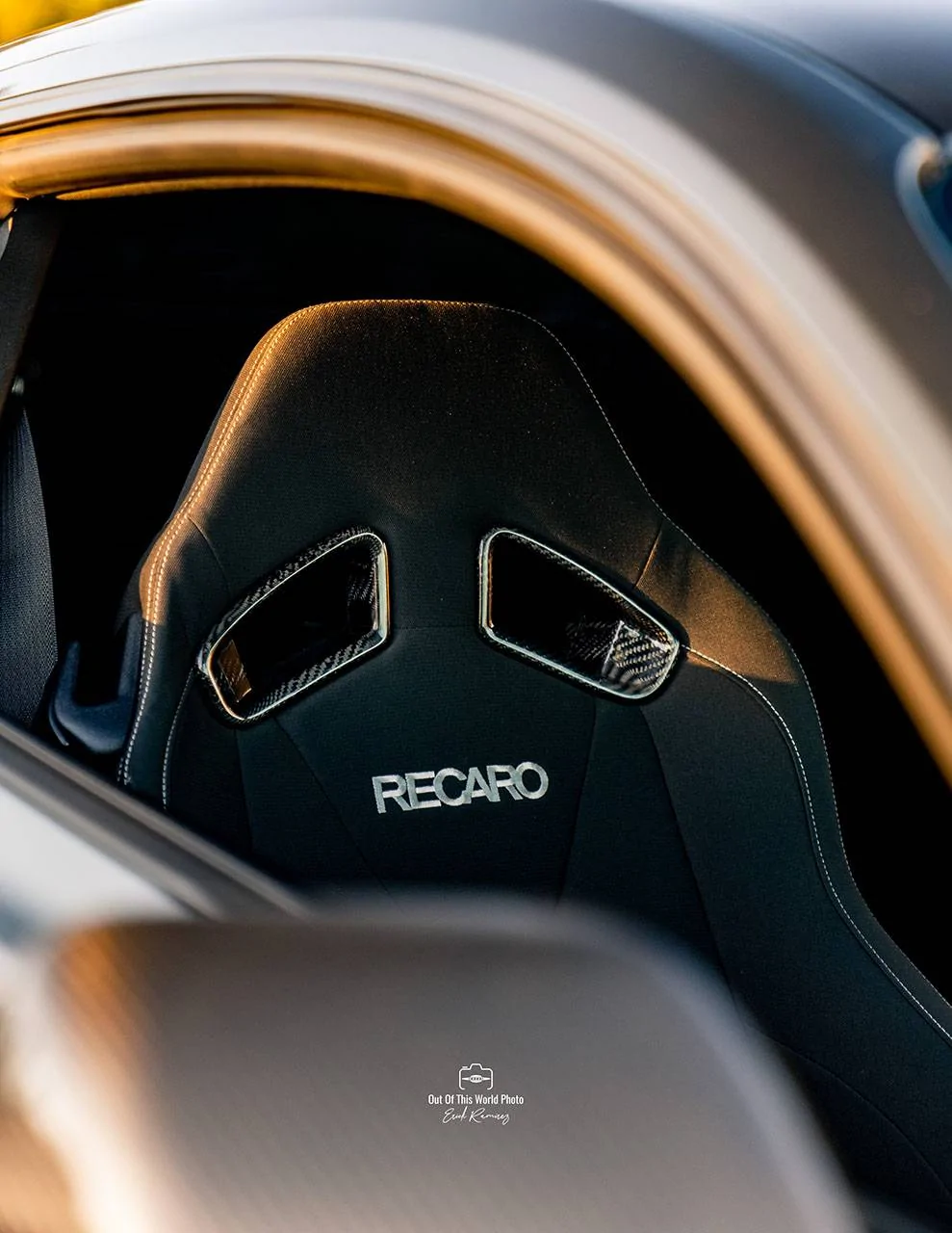

I have a Sparco in place of my driver's seat. I did the resistor thing to keep the airbag light off, and I pulled the harness from the stock seat to plug up for the seat belt and whatever else there was.
I would suggest trying to find a base seat out of a junk yard, ebay, etc and getting the harness of it. Then you can make the seat into an office chair or something like that lol.
I would love to get a set of the stock cloth Recaros to put in my car. At the time (2017) there were never any available second-hand and it ended up being cheaper for me to put the Sparco in. But I still would love to swap Recaros into both driver and passenger side.
Thanks man, I'm actually trying to find a wiring harness but all the dismantlers/junk yards want to sell the whole seat. The cheapest one I found was 300 per seat.
I just bought a Sparco QRT-Carbon and want to avoid the whole airbag light thing. I also don't want to cut my recaros as people are inquiring about them.
DM me if you wanna shoot an offer. It comes with the OEM inserts, the Carbon Fiber ones on the seat and I'm gonna throw in the schroth quick fit harness for free.
