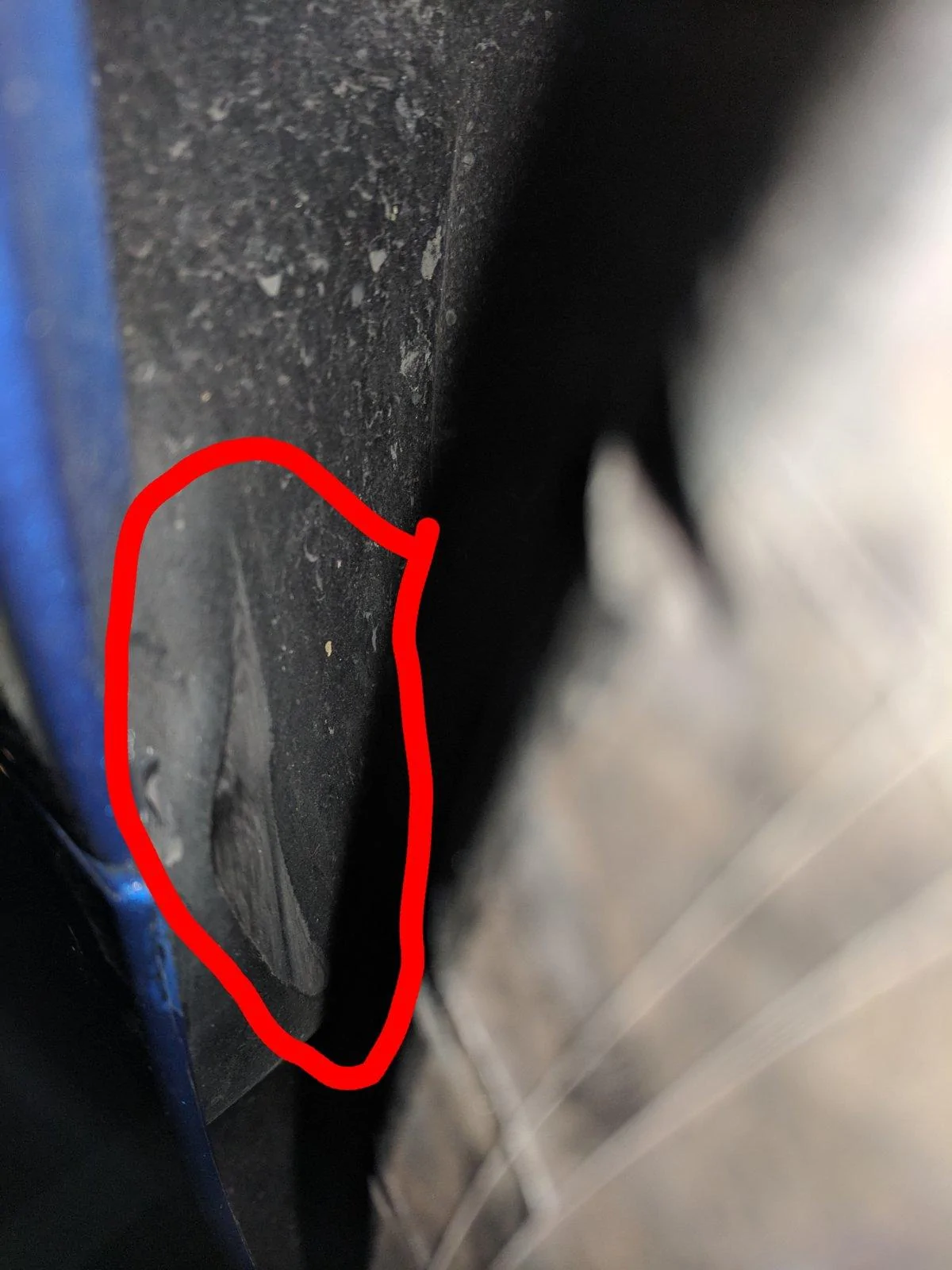

The OEM offset at the front is 30mm and the LMR rims are 20mm, so the front tire is shifted 10mm further out. It doesn't matter what springs you run with those wheels, the tires will hit when you go over a bump.
The good news is that more negative camber will increase the space at the top of the tire. If you increase the front camber up to around 1.8 or 2.0 degrees, it might just stop hitting.
