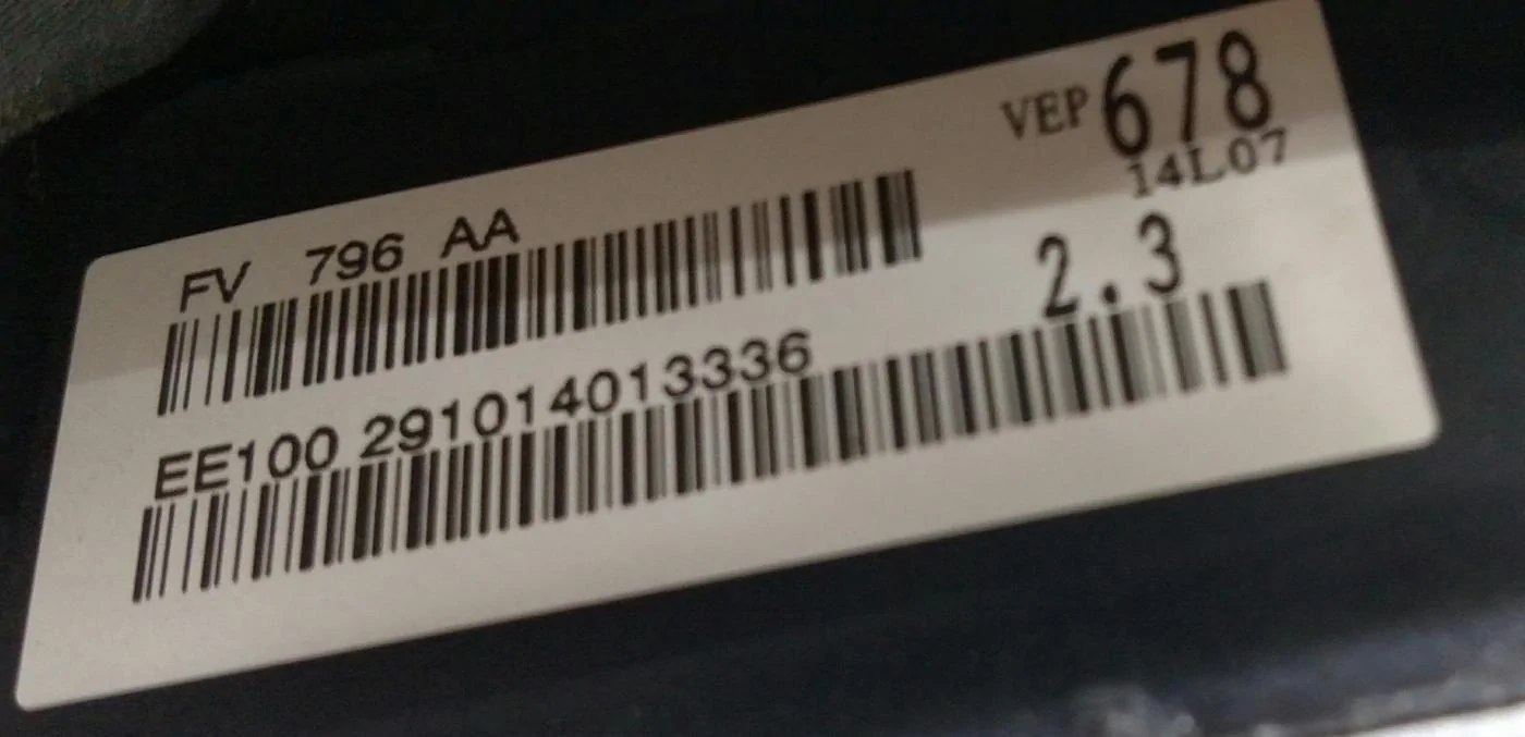

If the Mustang was built in May-2015 the Engine would be from around Feb-March 2015 which is around the time of the change to Cleveland. Can you take a picture of the engine build sticker on the front of the engine right under the plastic cover and post it?
My Mustang build date is Jan 5 2015 and the engine build date is 10-29-2014?
