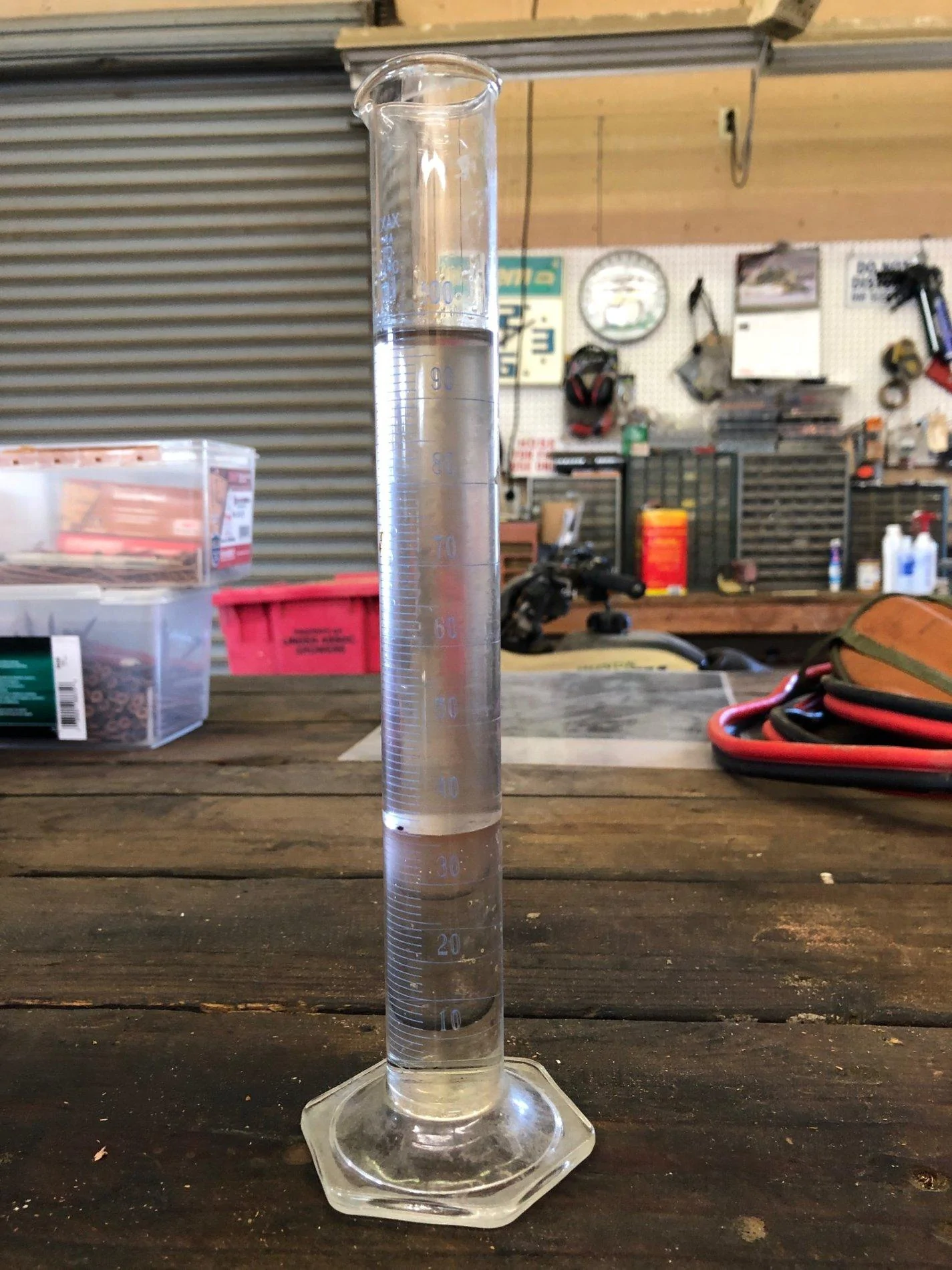

Lastly, a fuel may claim to be "E85", but that doesn't automatically mean its 85% ethonol mixed with 15% gasoline. The ethanol content can be as low as 70% where I live in Iowa and legally still be called "E85". I have a tester and my local stations that carry E85 in the summer time consistently have E85 on hand that test out to be at least 80% ethanol.
