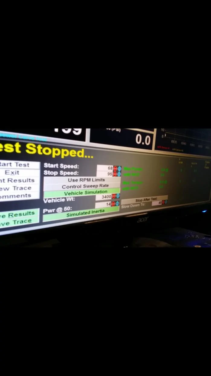

Here are the variables that he had put into the computer. What do you think? i suppose its a bad reading because of the false weight...i know nothing about a dyno so i apologize

No idea. I don't know how to operate them either. But i think there's more than just that begins the scenes

Having a lower weight than actual would make it read low if I'm thinking correctly right now.
Because if your car weighs 3800 and goes from 68-95 in 10 seconds it would make X amount of power. A 3400 pound car with X amount of power should go from 68-95 in less time since it weighs less but in this situation it's doing it in the same time, so it would make less power.
You could think the opposite too. If he did the same run but entered that your car weighed 8000pounds it would say it makes way more power because it would think an 8000 pound car is accelerating just as fast as yours, and for one to do that it would need a ton of power.

I'm just making sure he did it right because I thought that whatever weight he enters is how much resistance the rollers are applying I just don't want fudged numbers is all I'm saying

You're numbers look good. Don't worry about that.
