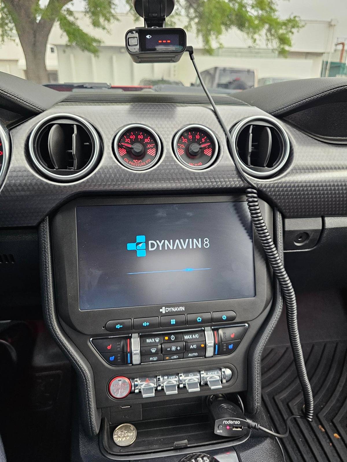

My new to me 2021 GT PP1 came with the 8" SYNC 3, but I decided to swap it out for a couple of reasons: speakers distorting when volume was past 20-22, USB port under the radio was very loose causing phone to disconnect, and I wanted a bigger screen. After doing some research, I went with the Dynavin over the Tesla style screen and others. I wanted to keep my toggle switches vs having them converted to soft buttons on the other radio options.

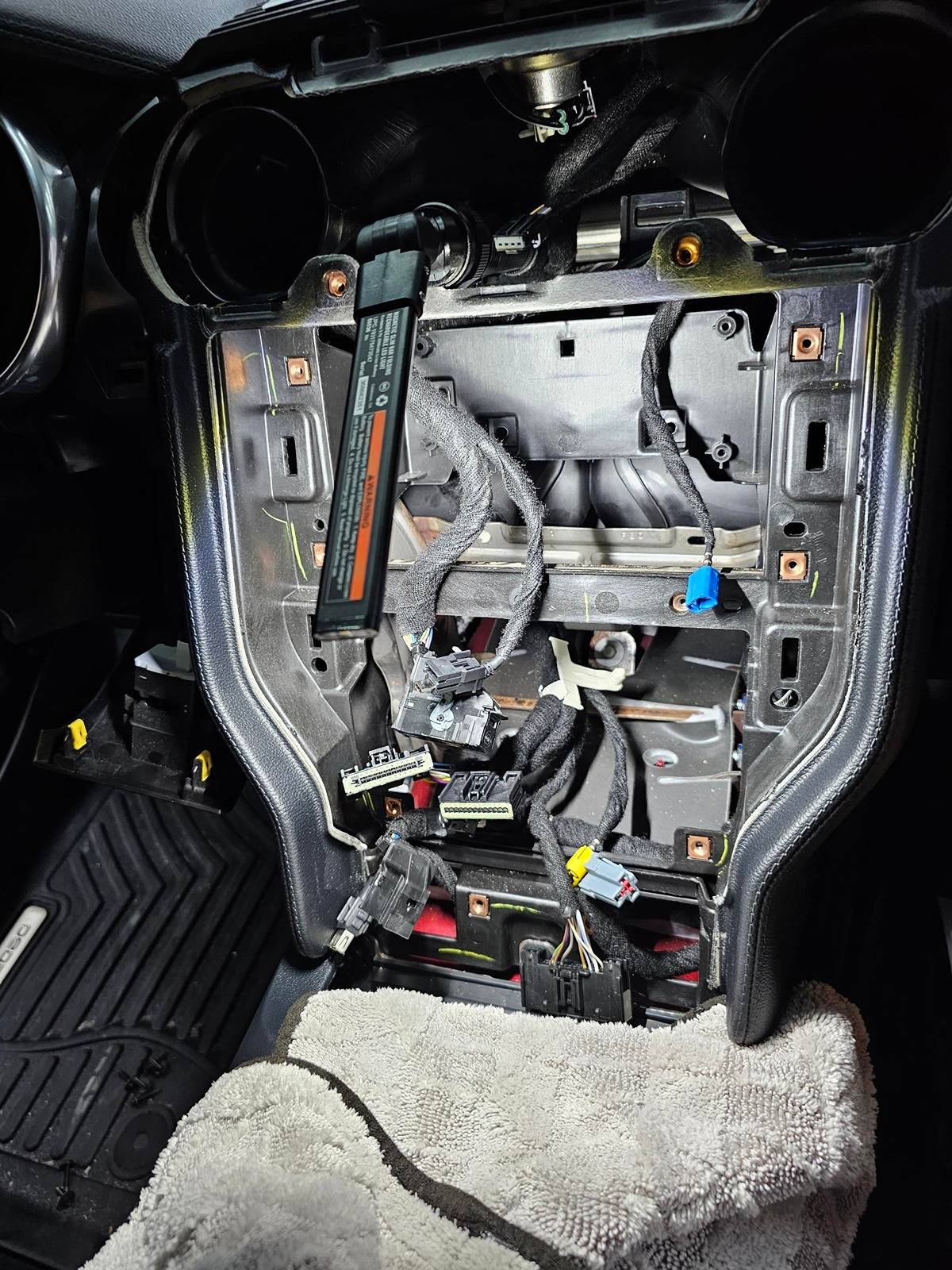

Install took me a little over 2 1/2 hours. I was taking my time, but to be honest, about an hour was spent researching where some of the plugs went, how to get some of the OEM connectors off, and which OEM plugs weren't needed on the new unit. Getting the panels off, most of the plugs used, etc. were well documented in their install video, but not all. There is also a PDF of the parts, wiring diagram, manual, etc. on their site. Unfortunately, I didn't find them beforehand. It would have shaved at least 30 minutes from my install.

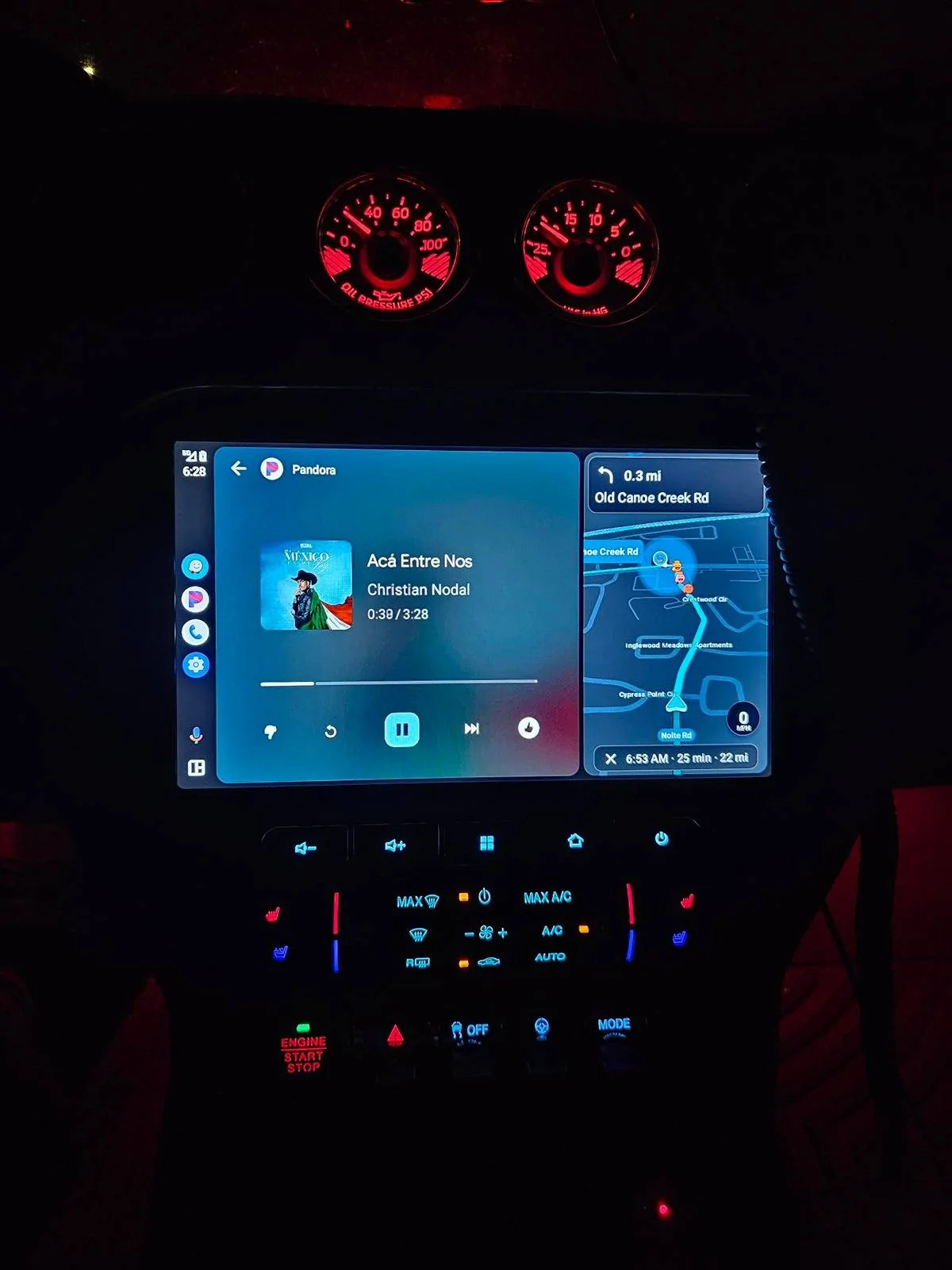

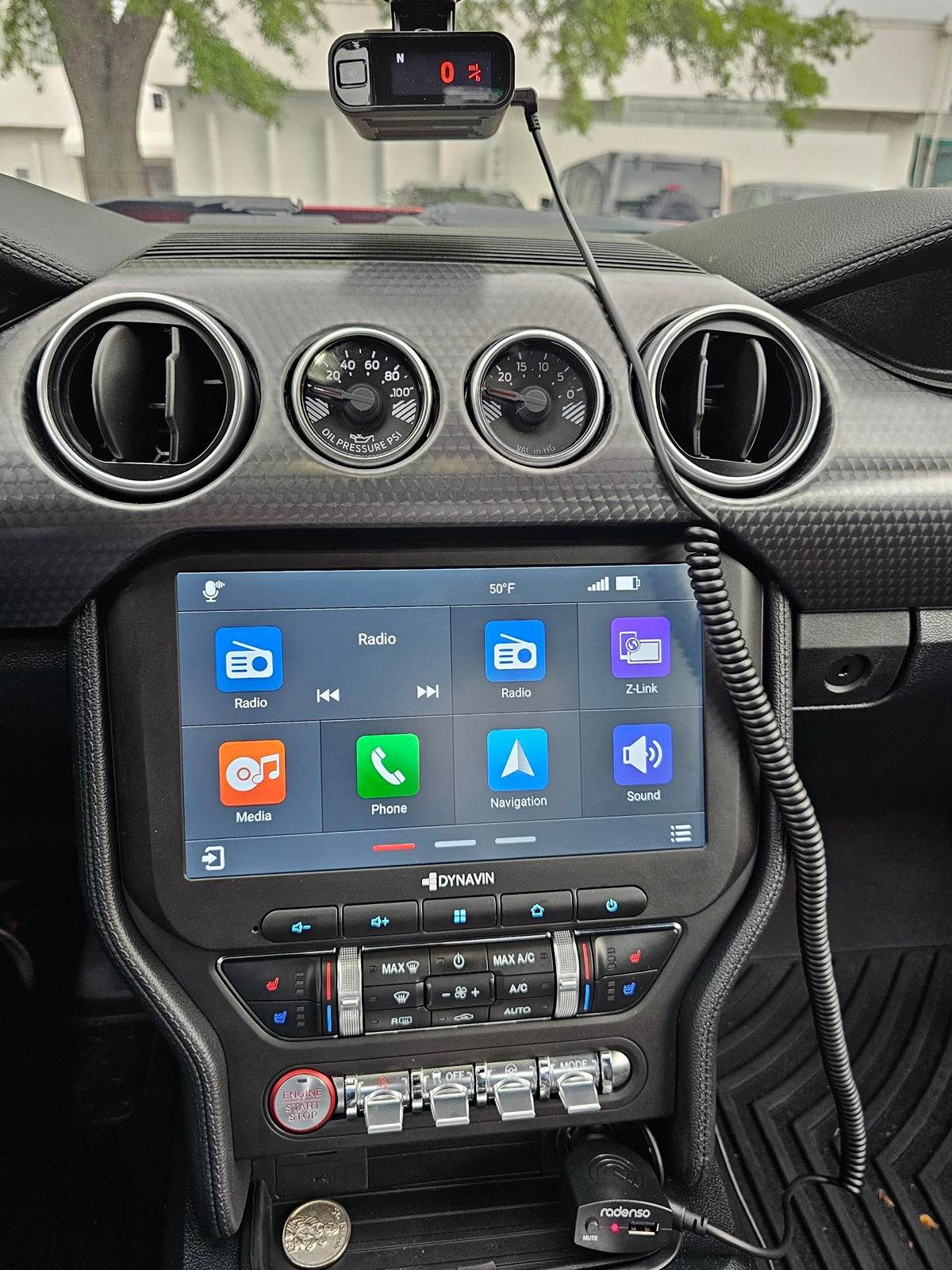

* Having a larger screen works great with Android Auto. Waze and Pandora work much better on a larger screen. Toggling between the two apps is as simple as tapping the one you want on the large (left) side of the screen. I can now click thumb up or down right from the main screen. On the OEM unit, I had to switch to Pandora completely to have that option. Much easier while driving.

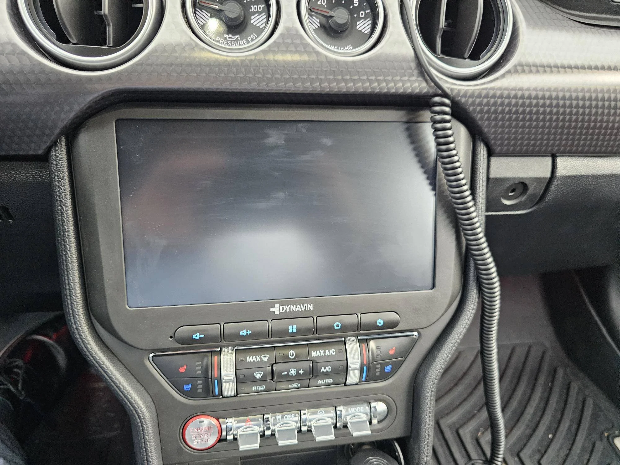

* Screen is easily washed out in the daytime. I have full tint even on my windshield and it still gets washed out. Brightness is set to full, but because the screen isn't recessed like the OEM one, light hits it easily. At night it looks great. I would not want to put this unit in a convertible.

2. I plugged in the OEM blue connector for the GPS into the back of the unit. This will not work. And I only noticed after I put her all back together. I'm pulling it this weekend to fix the FM radio issue (I have to plug OEM plug plug into the unit, per Jeff at Dynavin. This was no where to be found on their site or instructions)

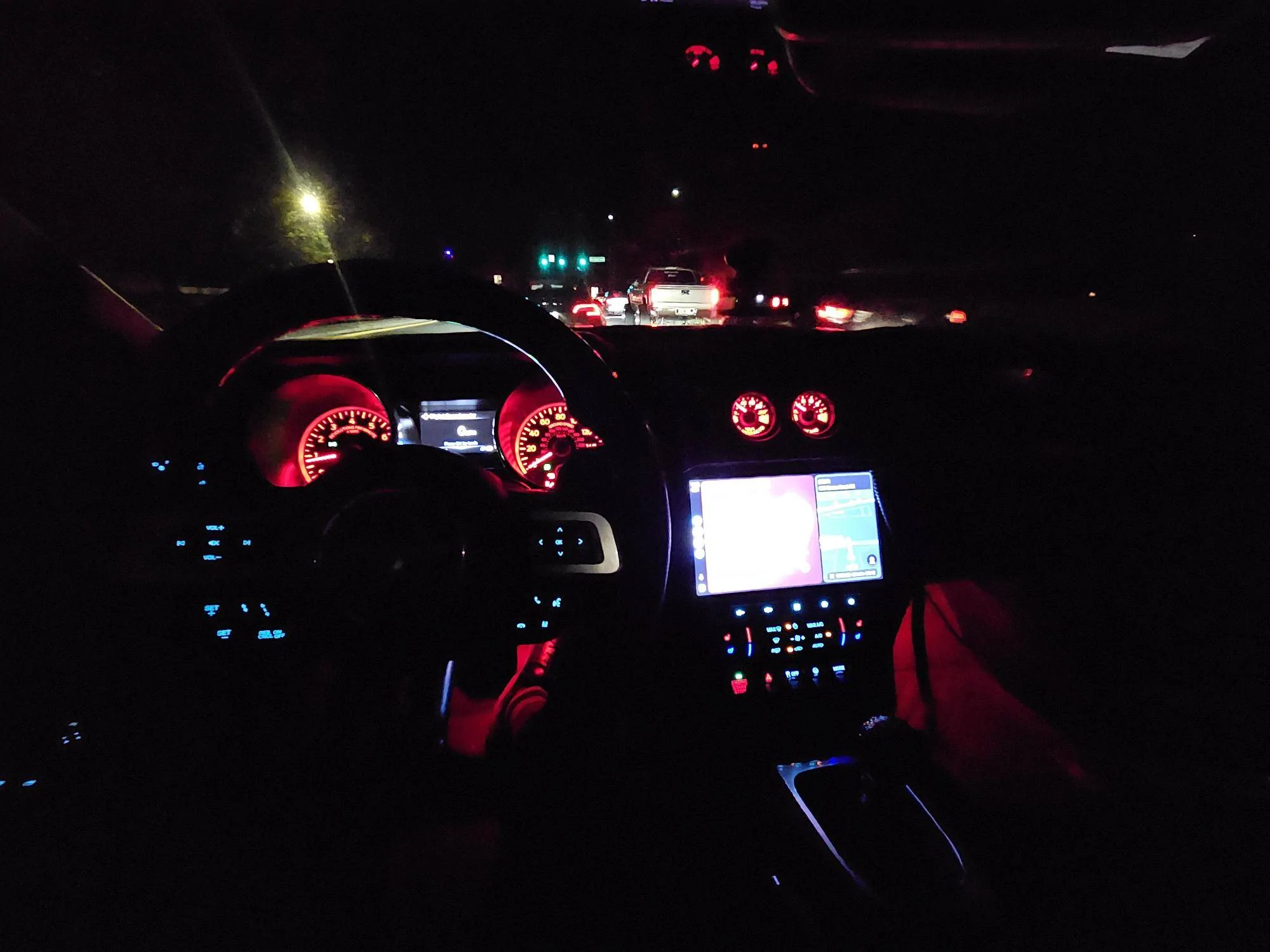

Some night time shots. Display looks great in lower light. I may need to re-tint my car a little darker...

Works great. Fast boot up. Sound is definitely better than OEM unit, but I did change all speakers to Hertz. The iGo Nav is decent. I would use it in a pinch if I had to, but I prefer Waze via Android Auto. I bought a Course Motorsport phone mount. Looks and works great. Now I don't have to have my phone in the cup holder or on the passenger seat. Highly recommend this mount.
