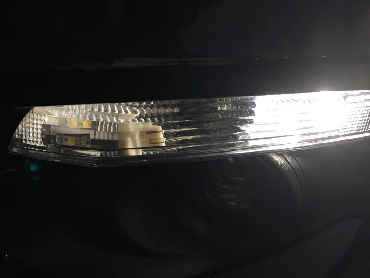

Finally contacted them, and they're sending replacements. Not sure if I should replace the passenger side as well, because I already taped it onto the harness. I hate just thinking about opening up the wheel well, scratching my forearms to hell messing around with it, and then buying a magnetic pickup stick, and then turning the wheel the other way, and repeating everything :tsk:

I understand the thread is a little old, but I just had the same problem. I saw the extendable magnet suggestion and figured I'd have this problem licked in an second. Now I'm not sure if this is an older batch or a newer batch of the switchbacks, but the leads are not magnetic. I ended up wadding up a bit of duct tape on the end of the magnet and was easily able to pull the light to the socket. From there needle nose pliers got it right out. Ended up taking three minutes instead of 30 seconds.
When I reinstalled the light I pressed firmly and felt a distinct click. My own fault for not seating it tight enough. Time to hit the gym I guess.
I hope this helps someone.
