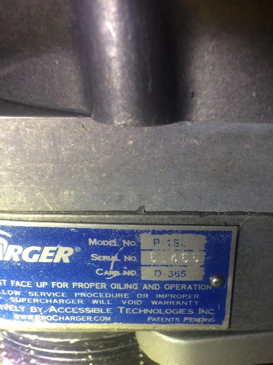

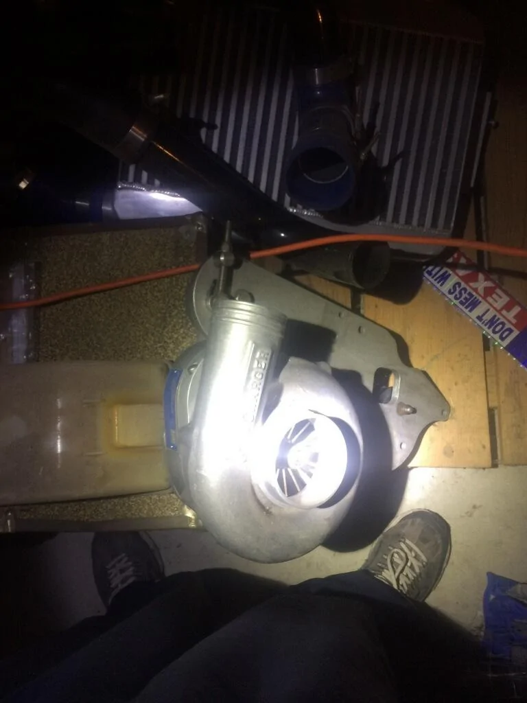

here are pics of it

Thats the #1 way to break a blower.
Unless you have ovens to the correct temp, and dry ice on the right parts.
Chances of getting her together witout upsetting the bearings is slim.
Also, thats a P1SC blower... (Not a P1SC1)
And it hasn't been used on any modern cars in our kits for a long while.
Its a lower power producing model.
Great for cars in the 250-550 hp range.
