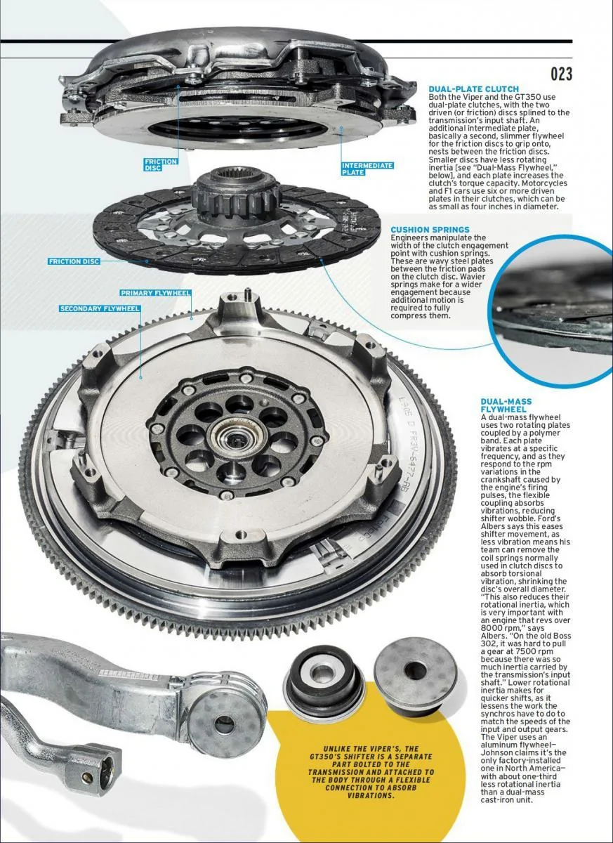

Also interested in the dual mass flywheel design. Is there an image of exploded view of this flywheel out there?
Here's some info showing the GT350 clutch and flywheel design.
