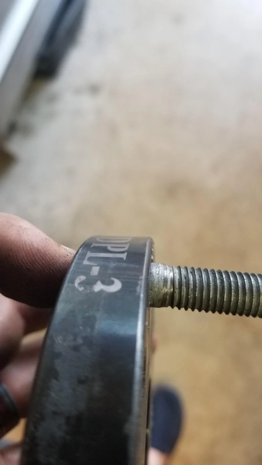

So the adapter for the rear diff. I asked the seller about the bolts that go from the adapter to the pinion flange. He said use the stock ones.
Well they fit in the hole and appeared to cinch the adapter down. Well they weren't. The shoulder of the stock bolts kept that from happening. Went to Lowes and they didn't have the M10x1.50 at all in a socket head.
Home Depot did. Going to re-clock everything back to the DSS lines and go from there. Not pissed about the 15 bucks in bolts but I am about the time it took to get it figured out. I have so much going on right now.

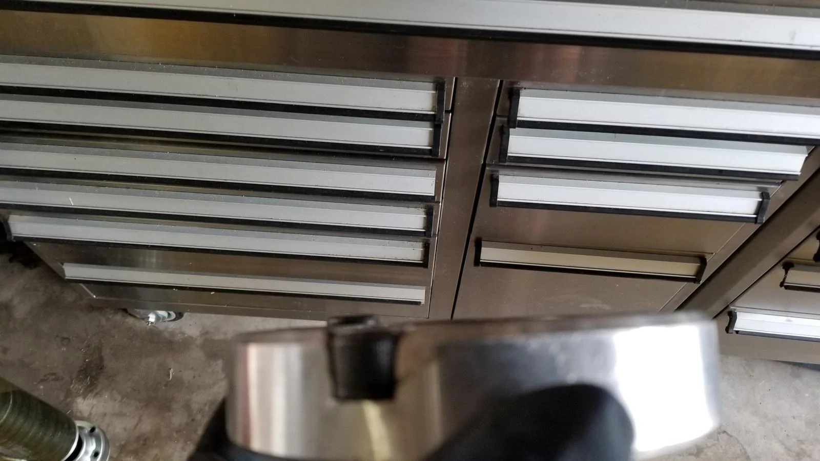

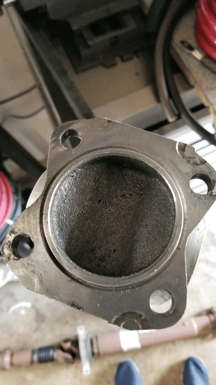

Well on the trans side the three bolts that go into the stock flange. Do not put the lock washers under the socket head bolts. The lock washers go on the nuts after you screw them in. If you put them under the socket head bolts then they stick out where there is interference between the shaft flange and the billet adapter. The previous owner had them like this and it wore three spots into the face of the flange. I caught that before installation.
You can see the witness marks where the socket head bolt was contacting the flange. The bolt in the foreground is correct. The bolt sticking up in the background is not and has the washer on it.
The second thing is make sure you get all the hardware. The socket head bolts needed for the rear adapter to pinion flange is M10x1.50x35mm.
Stock bolt shoulder interference.
