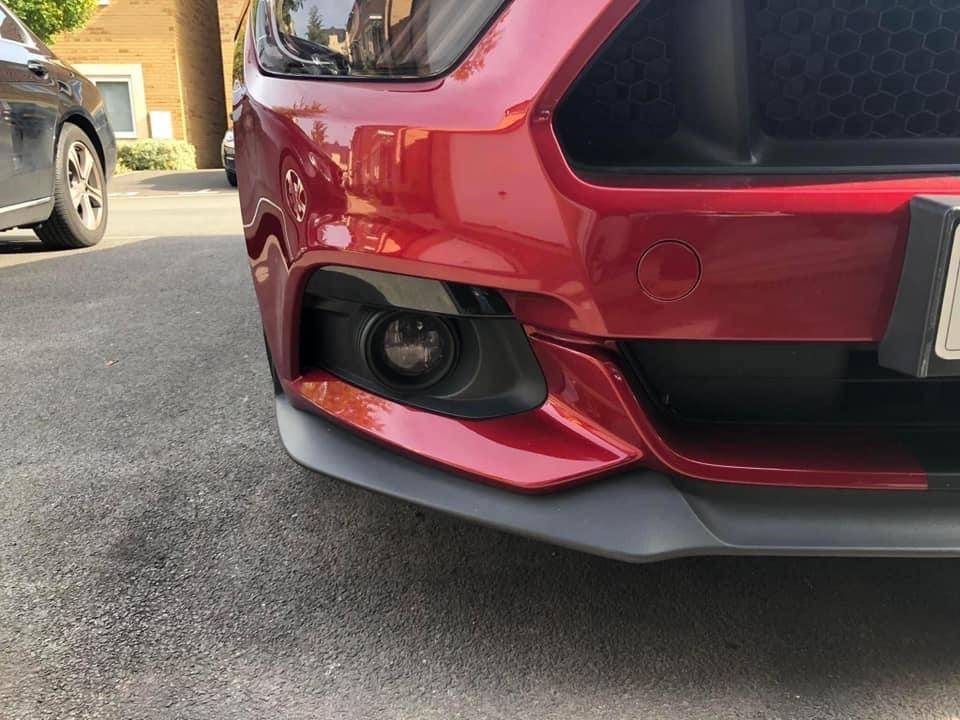

Hi
I bought some new LED lights to replace the clear turn lights. I went into forscan, managed to change it so both the fogs and turn lights/parking lights were on constantly but then I pressed something else and can't get them to come on until it gets dark then they come on. Anyone have an idea what the options should be under forscan?
These are the lights I bought;

It’s not that they don’t work. It’s that they did work, and then I changed a value and now they don’t 🤣😭. Might just be trial and error. Just a pain disconnecting Forscan every time you wanna check if it’s the right settings 😩🤣
