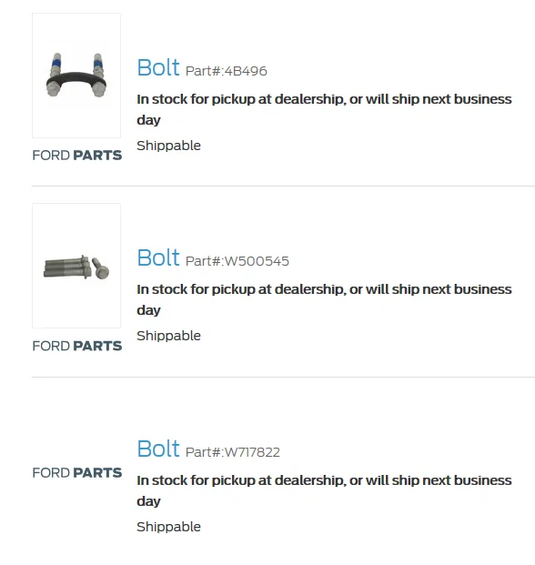

Not looking for a debate around re-use of existing vs. not, just looking per the "shop manual" calls for replacement of the following bolts after removal of the driveshaft, 2019 GT. Does anyone have a the actual ford OEM part numbers for the following
3 x driveshaft to transmission flange bolts
2 x driveshaft flex coupling to transmission flange bolts
3 x driveshaft to pinion flange bolts
3 x driveshaft to transmission flange bolts Torque: 81 lb.ft (110 Nm)
2 x driveshaft flex coupling to transmission flange bolts Torque: 35 lb.ft (48 Nm)
3 x driveshaft to pinion flange bolts Torque: 41 lb.ft (55 Nm)
Answering my own question, hopefully helps someone else...
