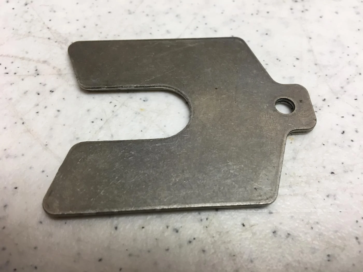

I shimmed mine down 1/8", BMR said I could go 1/4" if needed.

No. Its obvious when you look under the car there are 2 bolts on ea side. I had some special shims laying around. All you need are 4 washers same thicknesses with same support surface area as transmission pads to cross member. I would guess 3/4" or 7/8" flat washers would work fine. I will try and take pictures this weekend.

Finally tested this on my car today. Shimming down 1/4" helps, but not enough. Really disappointing. Now I gotta spend a ridiculous amount of money to ship this shit to shaftmasters...
