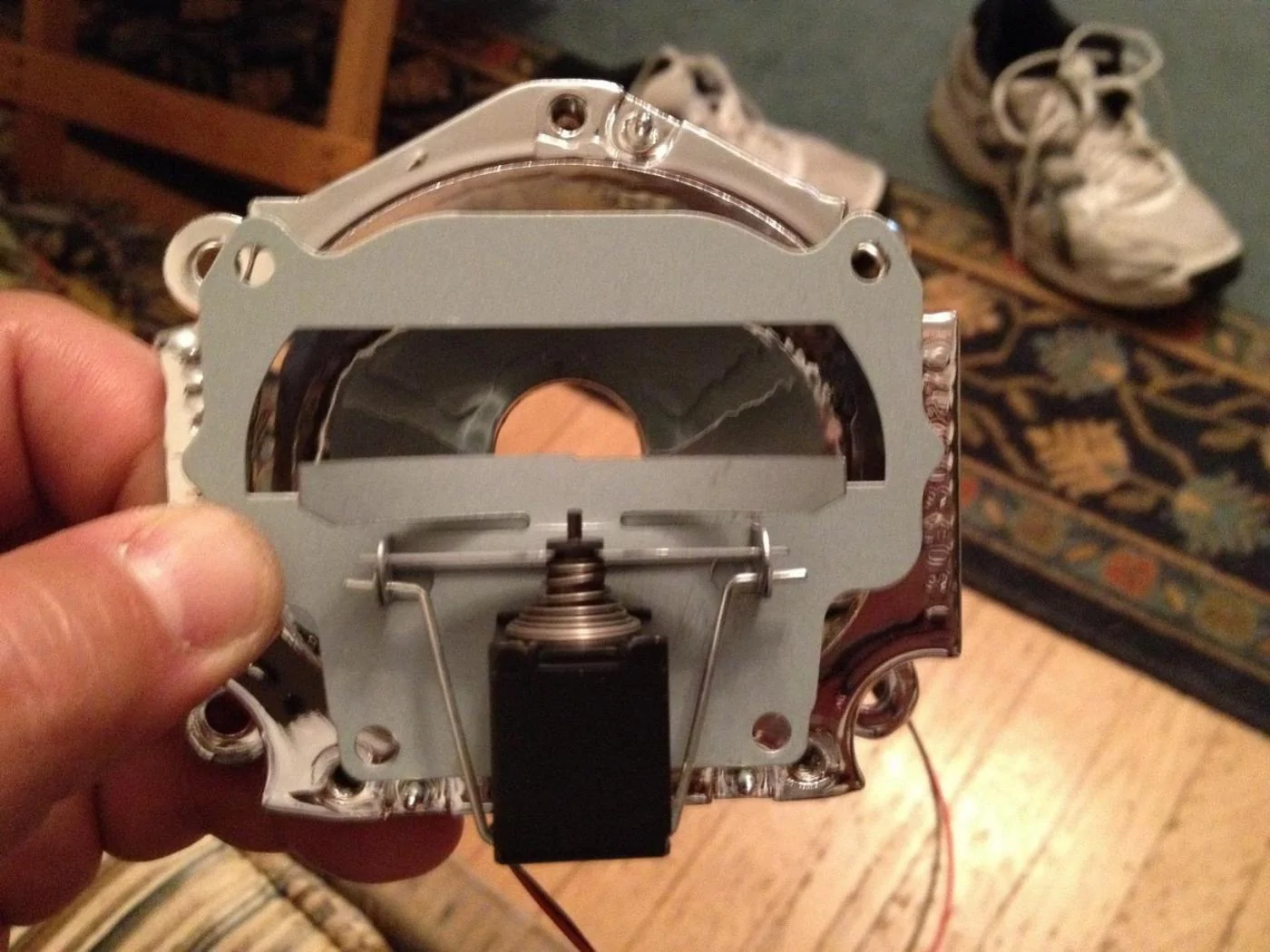

These projectors are bi xenon, which basically means the low beam and high beam are produced by one bulb
There is a little shield that blocks some of the light in the low beam position. When you select high beam, the solenoid (black box at the bottom of the pic) energizes and pulls the shield down. This allows full light to project and creates the high beam.
Most likely the solenoid is bad or the pivot for the shield is stuck. Definitely take it to the dealer as you won't be able to fix completely.
You might try smacking the top of the headlight to see if the shield will unstick until you can get to the dealer.
