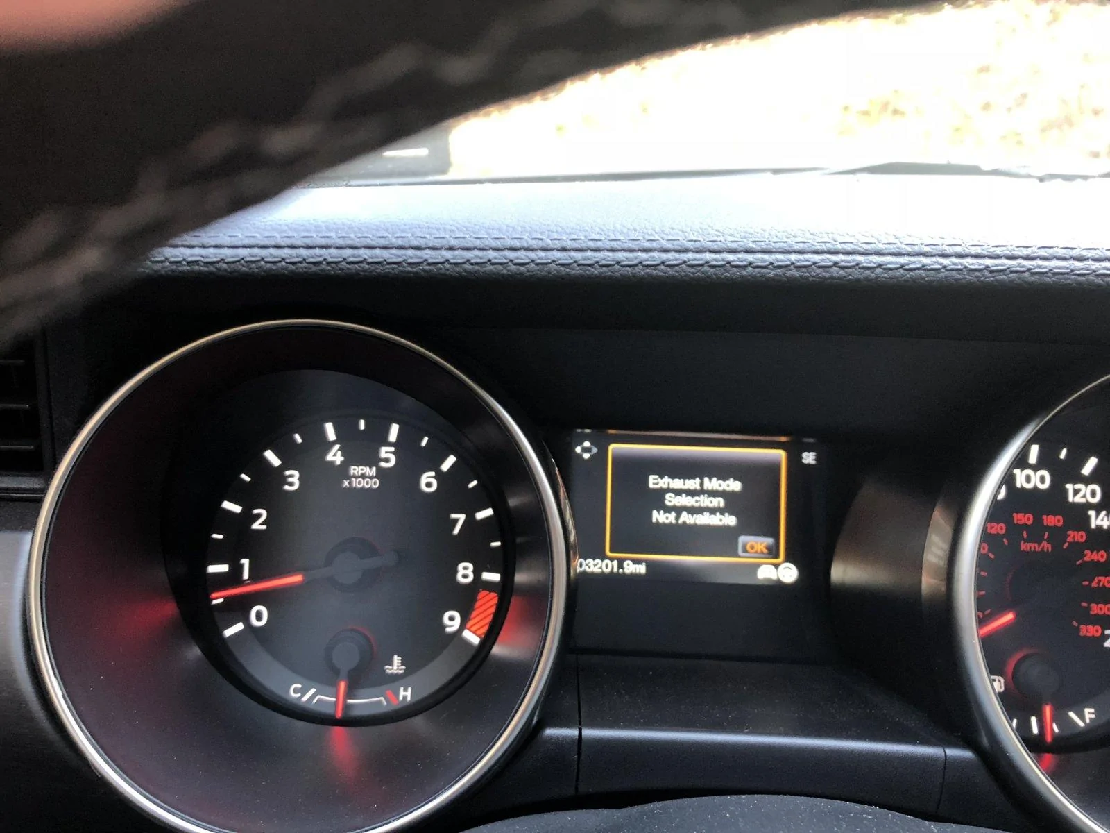

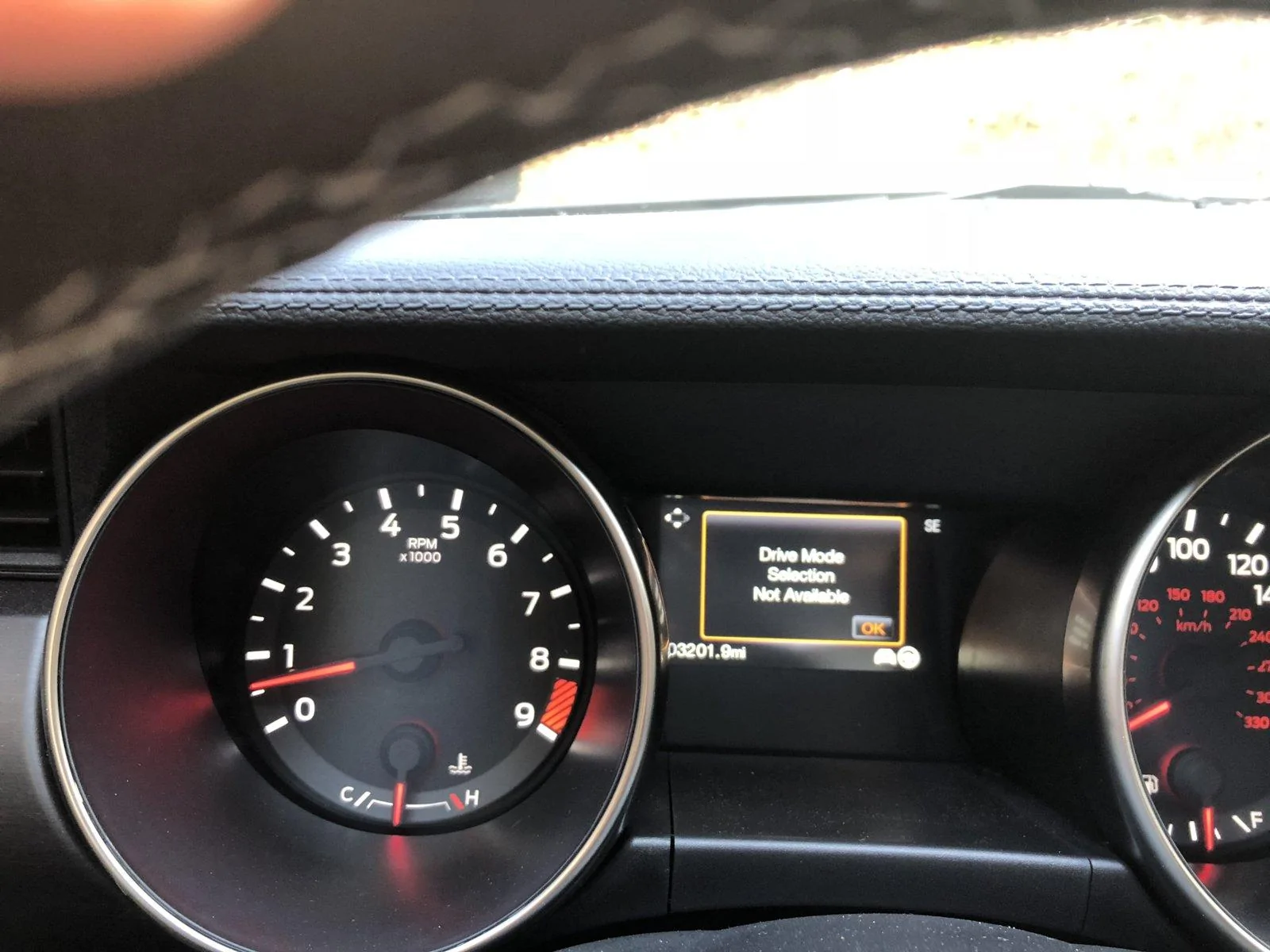

I know this is an old thread, but I’m having the same exact issue with my 2016 GT 350. I just dropped it off at the dealer for a second time. The Exhaust Mode Selection comes on when I turn the car on in the morning, and the Drive Mode Selection as well. I barely drive the car hence it only has 3k miles. Of course when I pulled in the dealer the car was fine... They’re keeping it over night hoping it’ll show the problem in the morning so they can get a code. Anyone here figureout what’s the problem? I see that it’s a recurrent issue with the GT 350...
