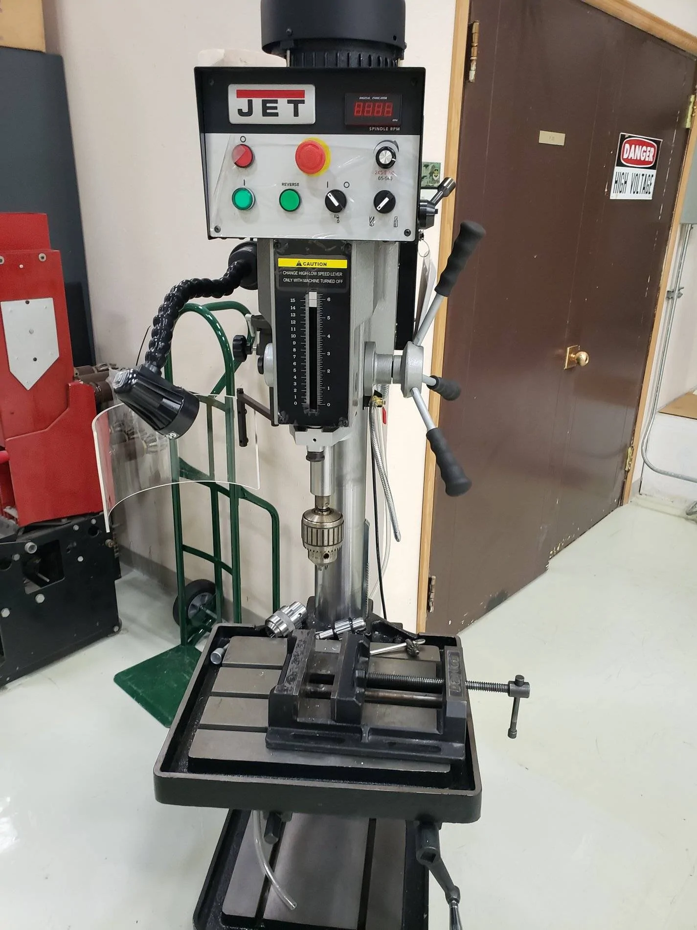

I'll be using my drill press....its got a setting for tap but I'll probably be using the tap wrench and doing it by hand....little more control....but I will be drilling out with the press.
I suppose I'll take a set of calipers and measure out how long the stem is....just wondering if people are drilling out the entire knob and that is working sufficiently
