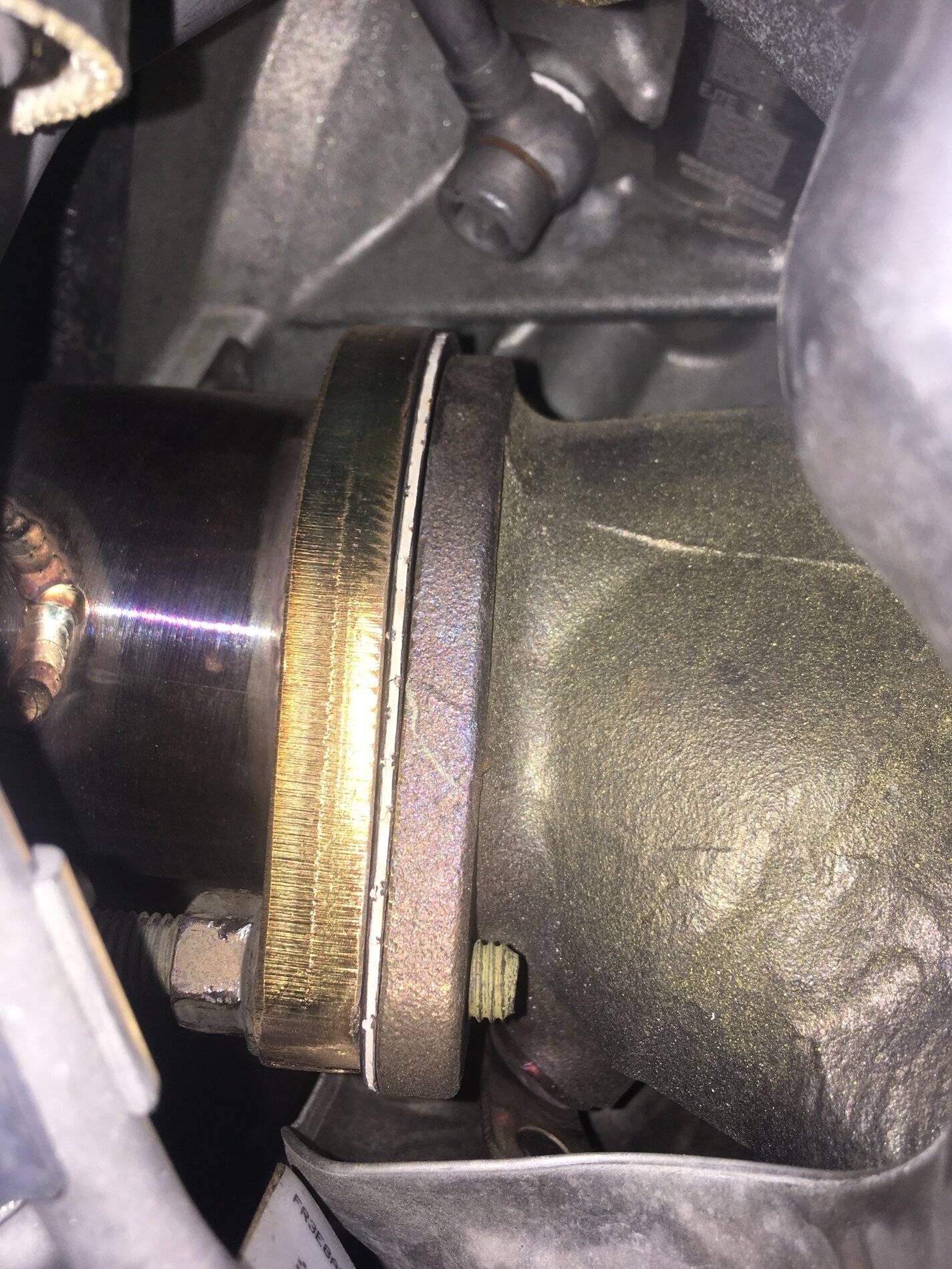

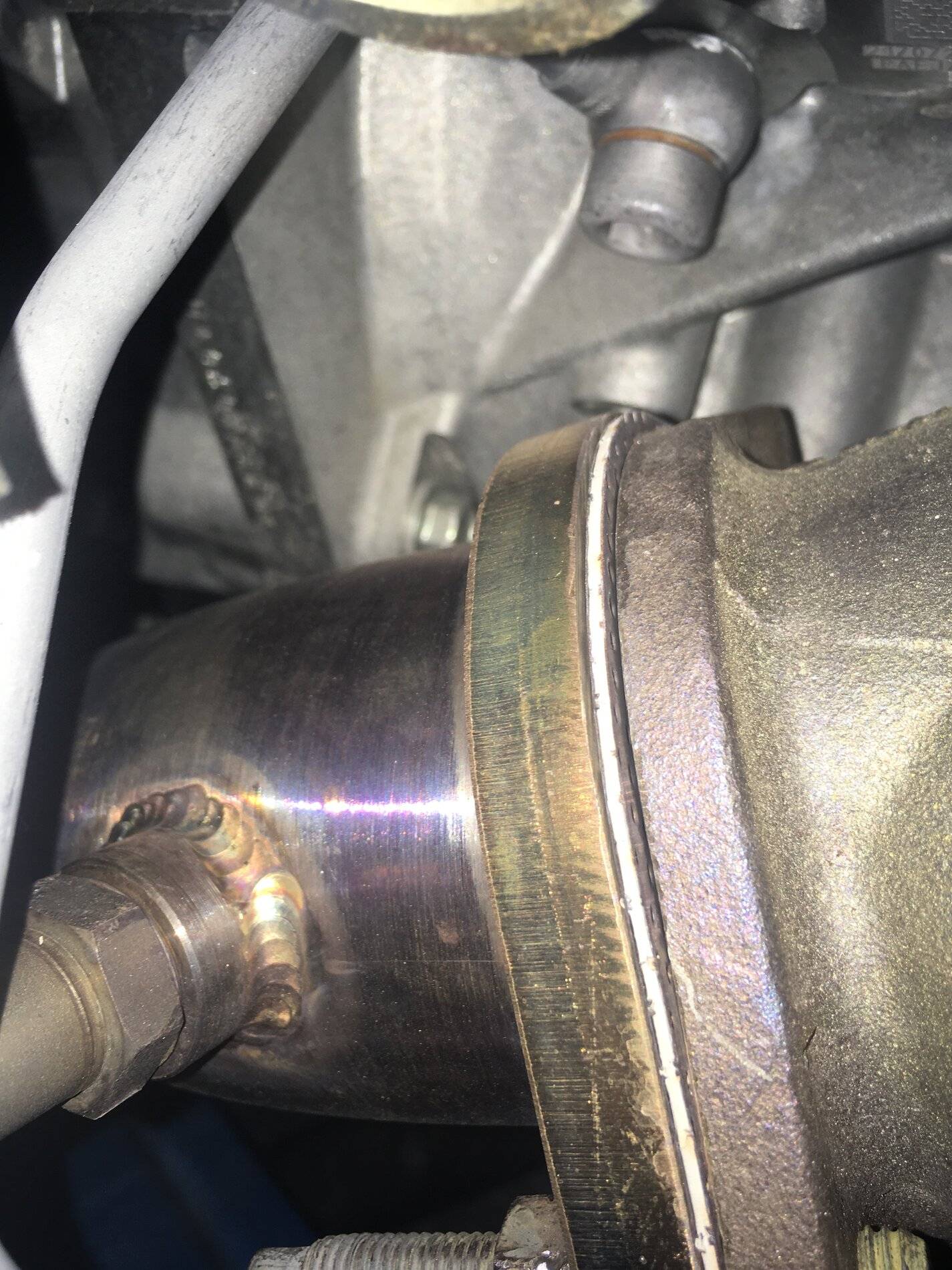

I have cvfab and im
Pretty sure I had it nice and
Tight during install, I feel like I’ve been smelling exhaust, I assume that gasket if leaking is by the ac vent on hood and can suck it in right? Would it have to be a lot? I put my hand over and near the exhaust, I may feel a hair of heat from the gasket on top,
But nothing I’d assume would be much.
If I do replace the gasket, is there a heavy duty gasket we can buy? Or should I just turn both the nut a turn or two see if tightens a hair
I’m weary of breaking those studsI was back
When I was tightening them
Up then too lol

I bet its my gasket, plus I read the gasket that came w cvfab, despite being a nice pipe, had a crummy gasket. I wonder if I can simply lose up the mid section of the Downpipe, (it is 2 pieces) then loses up the 2 nuts at the manifold, maybe I can push it back a hair, and squirt some of that gasket liquid on both sides?
do I do it on both sides of the gasket? since it would mate to both sides of exhaust metal

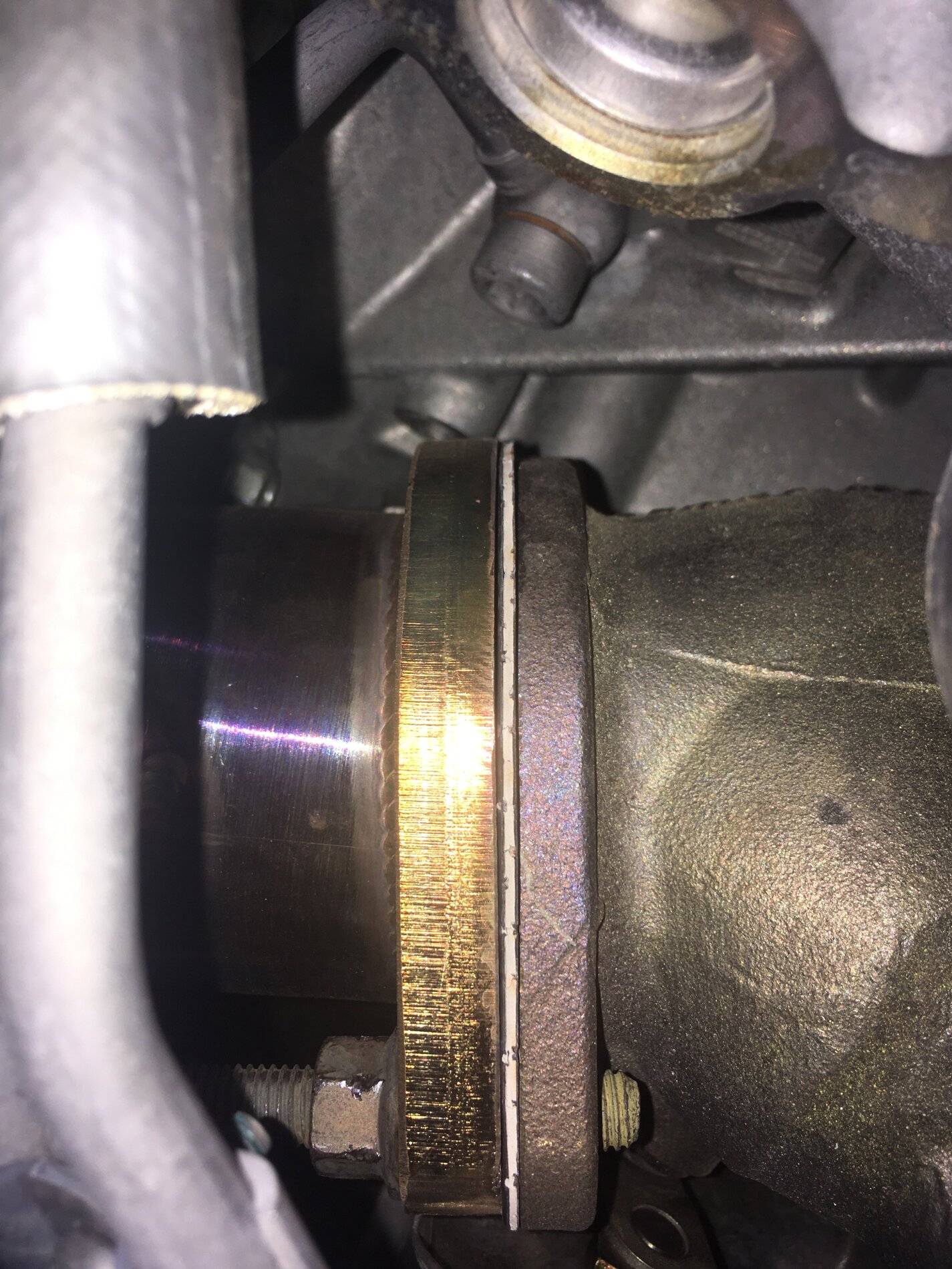

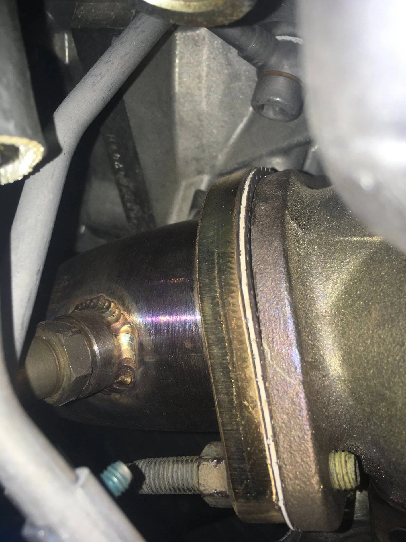

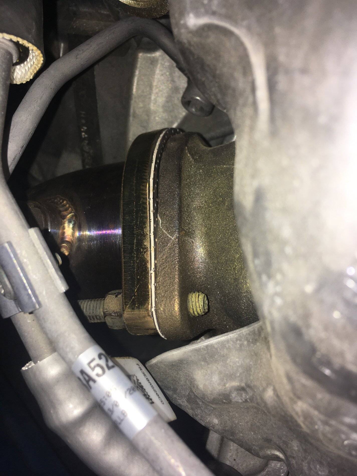

Looking at the photos, it may not be seated fully on top right in person it looked seated

looking at it in the light, it really looks seated well, im going to leave it alone for now, one day I will yank out the entire exhaust and do putty and ultra copper peramtex on everything. it could be my imagination eh, too much work for Friday. got to focus on the radiator first. maybe do exhaust in spring

It wouldn't hurt... Your setup is different than mine, you may be able to loosen it up and slide your gaskets out. Then use a lite coating on sealer (provided your gaskets are in good condition) and slide your gaskets back in place and tighten it back up.
Sorry, but I don't know the torque specs of the manifold bolts

is there a cheap co2 detector I can buy or whatever, and put it beside the gasket? Lol a sniffer type deal. see if its leaking.
its the fact that like 1/3 of my system is welded, so I have to remove the entire. y pipe out, to even release my downpipes, to scoot it back I think. there is 2 bolts on bottom of downpipes, if I lose that, I may be able to scoot it out a little, but im doubtful.
id have to do this work to find out it actually really wasn't even leaking

I guess you could use a little soapy water and look for bubbles as long as the exhaust system is still cold.
I found one (by accident) years ago while wearing wet gloves, but it was back at the muffler.
Just don't burn yourself and wear safety glasses, water boils quick on exhaust manifolds and they are prone to cracking if hit with cold water after getting hot!
