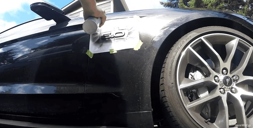

Step 1:
cut a rectangle in the paper a little larger than the emblem size and tape it to the car

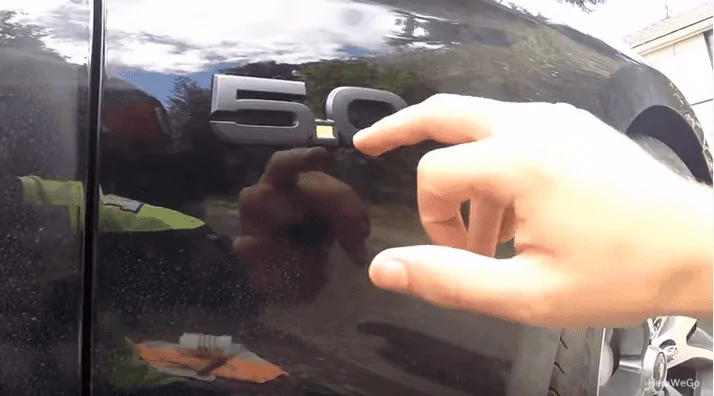

Step 2:
place tape over the "Point", press it into the corners and use a razor or shape knife to cut.

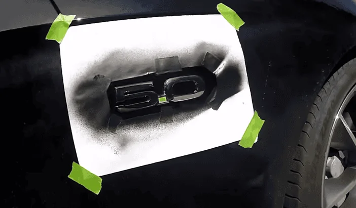

Step 3:
Paint. 1st coat get a 50/50 coverage and the 2-3 more wet coats after that. allow about 2-3 mins between coats.

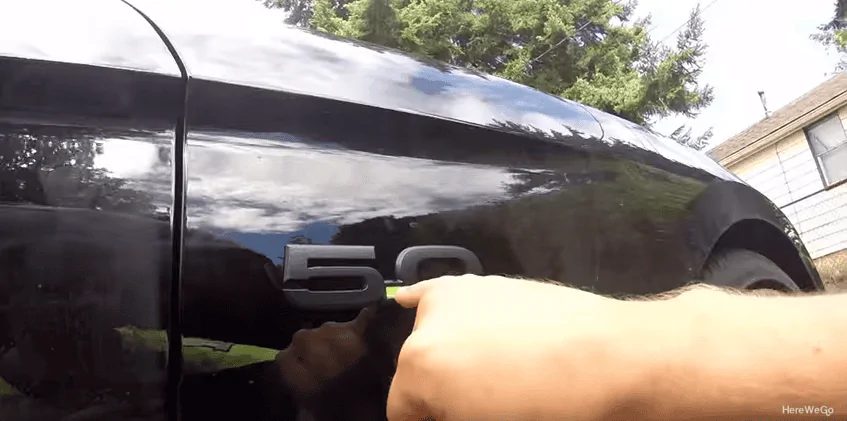

Step 4:
Remove tape from "Point" immediately after last coat is laid. This will allow for a nice straight cut around the point without having to worry about pulling up the plasti dip around the area.

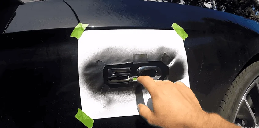

Step 5: (if you have a vinyl overlay for the point)
place overlay in point and you are done...almost

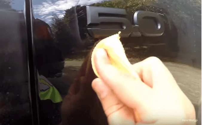

Step 6: clean up
Clean up any over spray by rubbing it with a micro fiber towel.
