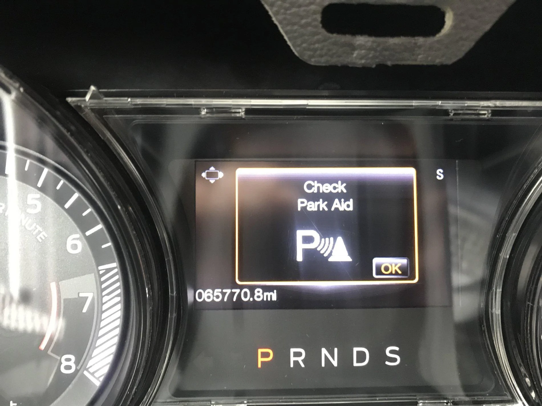

I just installed my premium gauge cluster with corrected odometer on my base model Ecoboost. Mycolor on the cluster works perfectly. I went into Forscan and made all the above listed changes, but I'm still getting the "check parking aid" message at startup. Any ideas or suggestions.?

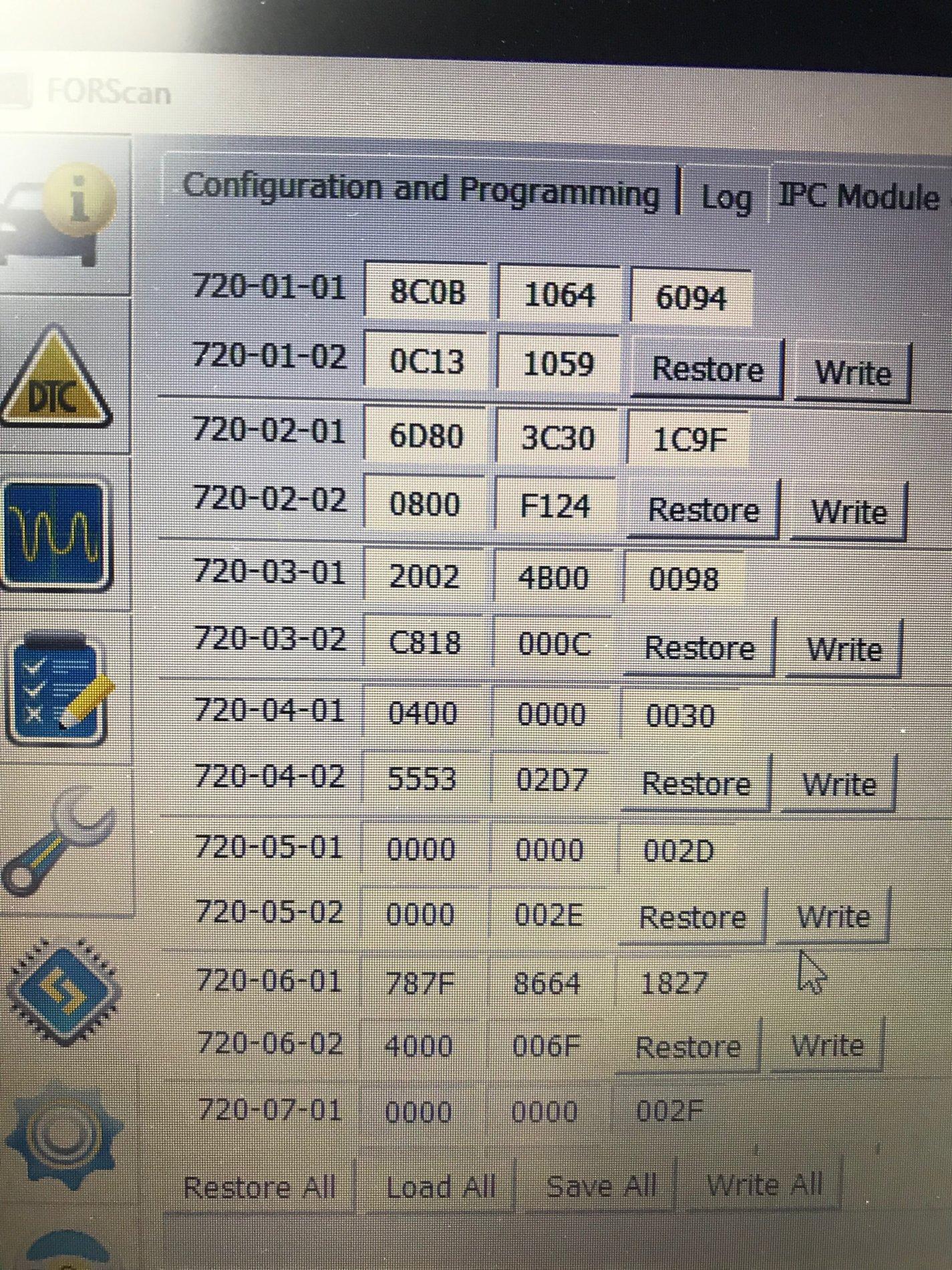

Well, I figured it out. I temporarily re-installed my original cluster and took a picture of the IPC as-built data. Then I put the premium cluster back in and compared the as-built data. There were several blocks that were slightly different, but when I changed block 720-04-02 from xxxx-02D7 to xxxx-00D5, the "Check Park Aid" message was gone at startup. Happy days!!!
