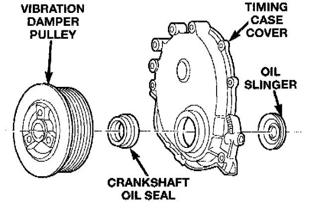

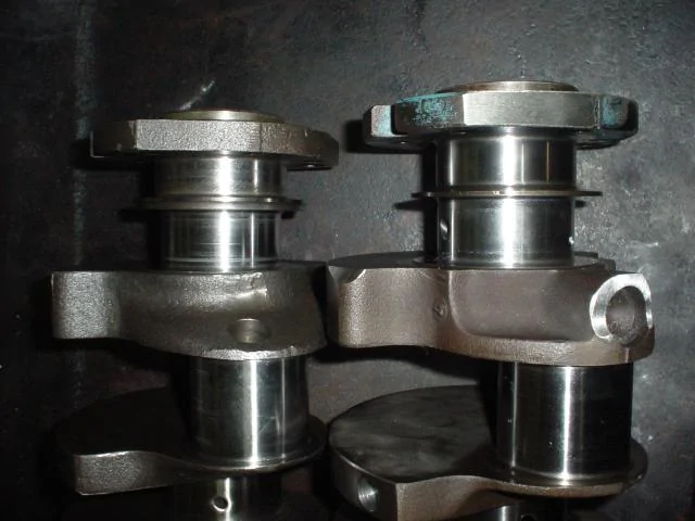

Seals, like everything else, are not 100% effective. Especially when shaft speeds increase. Increased speed is increased vibration which can create tiny gaps between the seal and the shaft. Mix that with thinner, warm oil, and some will definitely get past the seal. If you look at shafts that are designed for high speeds and heavy vibration (ie. crankshaft) you'll notice an oil slinger before the seal. It's job is to be a point where oil cannot pass without being flung back into the crankcase.
(The disk between the PTO flange and the last main journal)
