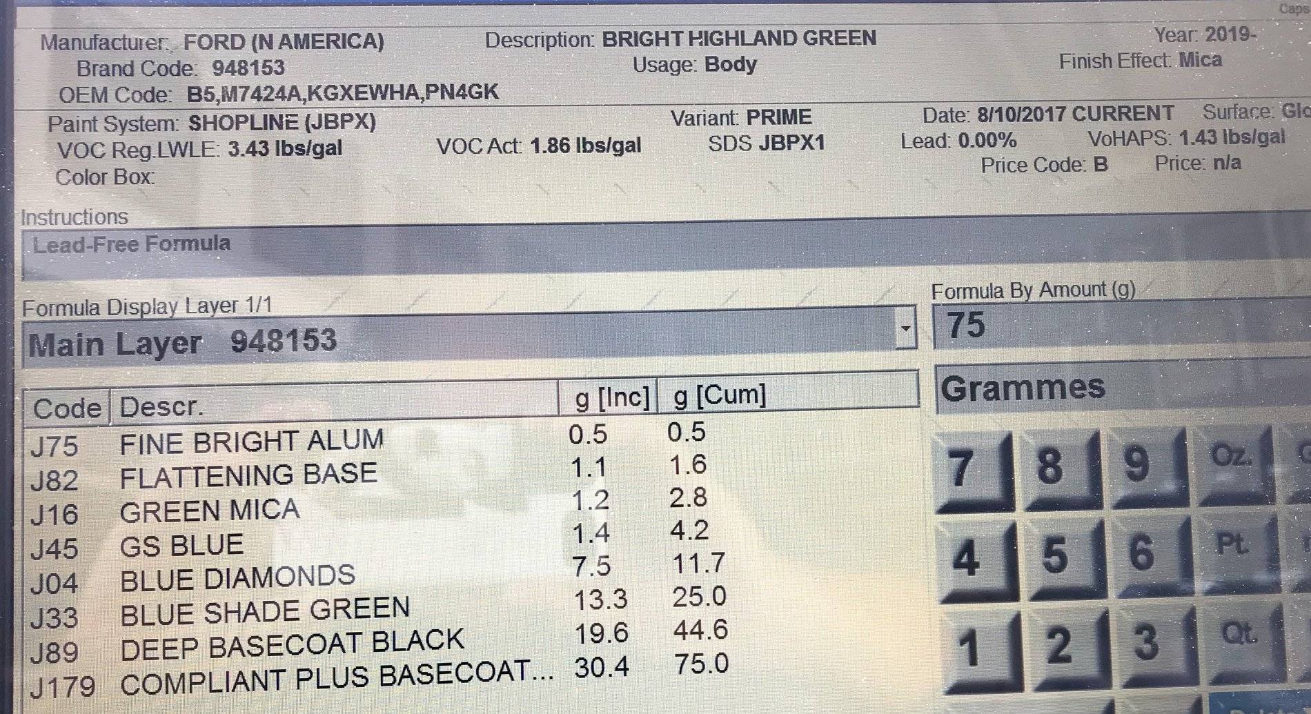

Thought I'd post this again... here's the formula for the Dark Highland Green for those that want to copy it.
I had advance auto mix me the color and it was a perfect match. They use Nason products and just upgraded to a even better product line.

What was their formula?? The same???
I never asked but I will stop by and see if he can give me a break down. I painted the lower side scoops. The dealership wanted know who painted it. I said I did and advance auto mixed it. He was shocked

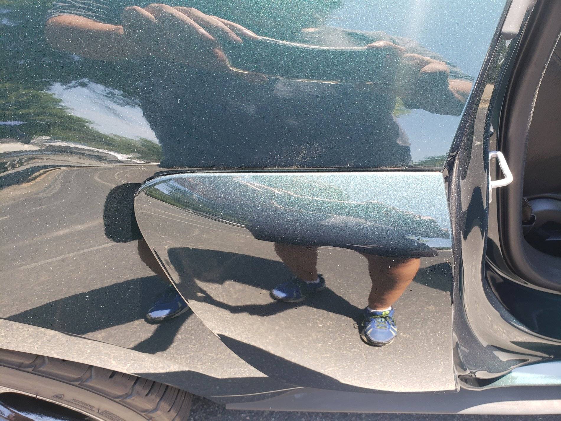

So you spray-painted it? Can you post pics? :D Thx. HATE all the plastic crap around the car; it'd look immensely better body-colored. But can't believe a spray-paint job can look OEM, but I'm looking forward to be surprised. Ha ha.
I did the painting outside did not wet sand it yet and of course the bugs landed on it. You will laugh i have a used jeep that I use as a oven lol it was sprayed in February I live in north carolina. My jeep heat inside can cook a egg. So I heat up the interior put the back seats down and lay the wet parts inside for a couple of hours. But the bugs love fresh paint lol
