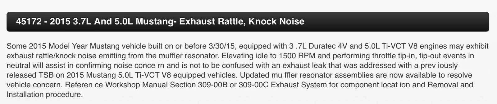

Here ya go, it *might* be your 2015 is one that may have this issue, per Ford SSM 45172:
Nah man nothing on this car is stock exhaust wise...Thanks for the input though
