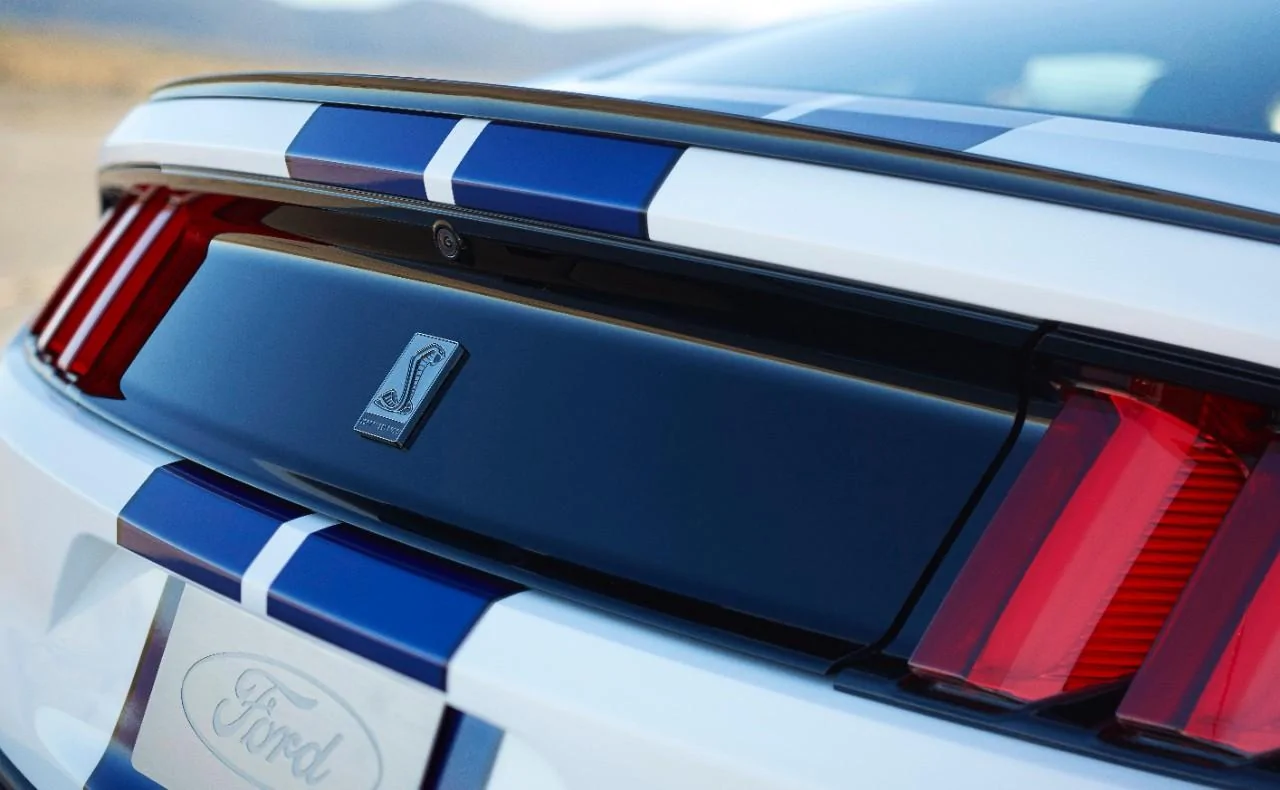

I need a new plastic decklid panel located between the tail lights. The one with the GT350 emblem centered on it. Can't find whether it's two part numbers or one, nor what the part numbers are. TIA

Let me know if you find it, I'm trying to find it also, mainly for the emblem itself, but I heard it comes as a set only. Need the regular silver GT350 one.

Correct, I took mine apart to get at the badge. No dice.Badge is heat staked to the panel.
It could be carefully removed and replaced though.

So the emblem is melted onto the decklid panel? Is that what heat staked means?
A plain decklid panel is available from Ford. Looks like you can get it online at $149. Until I saw your post, my thinking was that I could remove the emblem from my scratched panel with fishing line, and apply the emblem to a new plain decklid panel with the same black foam double sided tape that Ford appears to have used.
From what I understand, the GT350 decklid panel is only available with the actual decklid from Ford. You cannot buy it separately as Ford doesn't want the V6 and/or GT guys buying the panel, and slapping it on their cars parading around as impostors.

Yes, the two plastic post are melted down near flush with panel. They could be ground or filed flat and the emblem removed and replaced.

It is sold as one part, the badge is not seperate. New from a dealer is like 800, used ones can be found a lot cheaper on ebay or similar but don't come around too often. Part number is FR3Z-6342528-AH.
