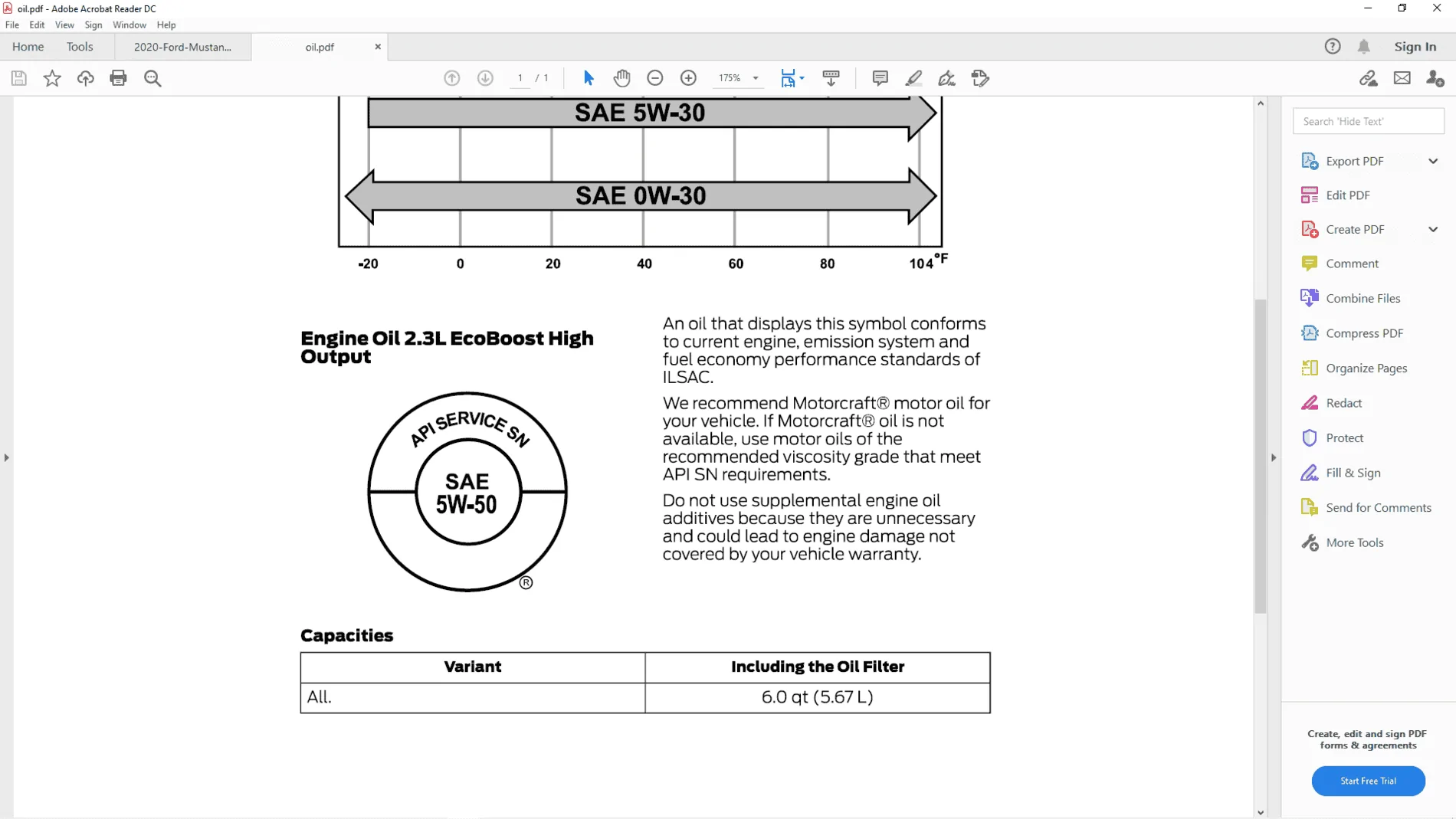

I'd go back and have them fill with the correct oil. If your car is a HO, then it requires 5-50w

I agree with this 100%. I posted after my first oil change they put 5w20 in my car when clearly the service tech wrote they were to use 5w50. I checked the paperwork and had them immediately change the oil and filter again.

There would not be any short term damage done by using the 5W-30. I don't know how Ford pushed the envelope on the Eco HPP, but the V8s with superchargers such as Roush, Whipple, etc require 5W50.
