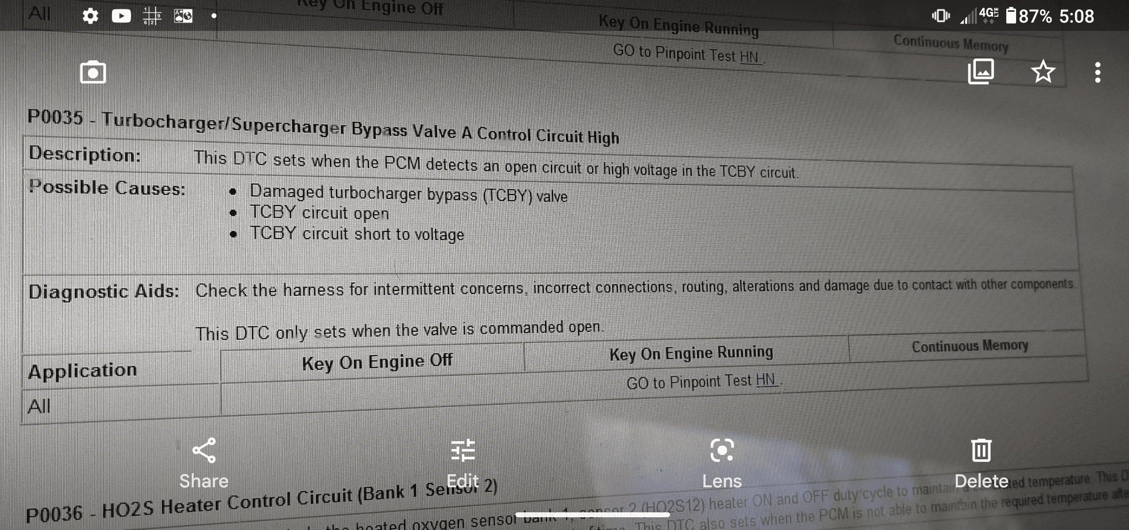

Before you replace you bypass valve, you may want to check a few things first. Here's some information from a Ford Repair Manual.

I will check that out as soon as I get a day off. Thanks CoyoteChase!
