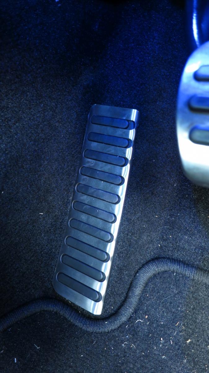

Installed mine last night, about 10 mins with the hairdryer on the foot rest. about 5 mins on the cover (with the tape peeled) and on it went. Held it firmly for about 30 second and then set up a few props to apply some weight to it. Seems like its stuck good!

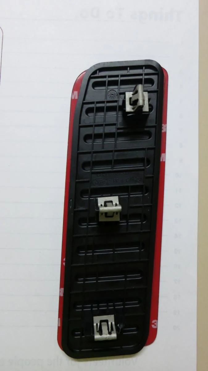

Yes heat and prep the footrest is the key, for mine i wiped it down with iso alcohol, used a heat gun on it for a few min to get it warm to the touch (also leaving it out in the sun will work, both the cover and the car) then peeled the 3m tape with tweezers and applied the cover.

easier if you pop off the pedal before you fix.
3 clips so easy to remove and refit once the cover is fitted.

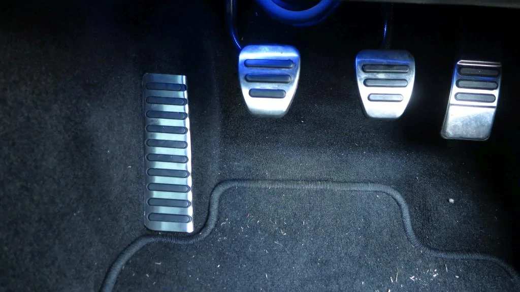

Finally got one sorted, although it took a bit of fettling to look, fit and stick how I wanted it to :
WD :like:
