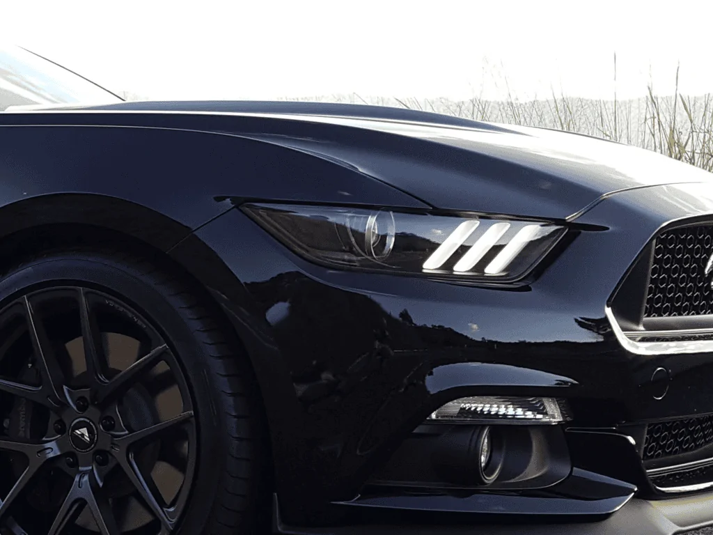

You will love them! This is mine, I alsoblacked out the reflector and chrome except for the last ring.
Thanks for the tip about the Sika vapours.
I've traced the wire colours from the various lights, and found almost no relation to the colours in the DD instructions??!! Did you keep notes on what colours you connected to?

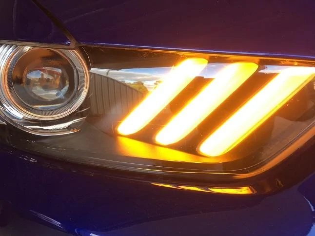

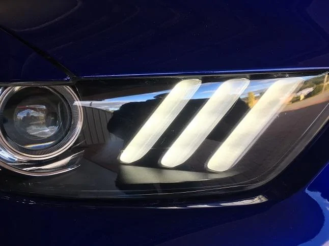

DIY tri-bar DRLs done
- and only one piece left-over! (That's a pass mark isn't it?) The left-over piece (see blurry photo) looks like something that tidied-up a bit of wiring harness somewhere (can't be vital :)).

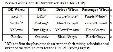

Revised wiring for DD switch-back kits for RHD
Below is what I believe are the wire colours I ended-up connecting to on my Aussie RHD car. Can anyone else confirm these colours ? (If so, I'll let DD know so they can update their wiring schedules).

Thanks Makis, knowing your experience now, I would have soldered them while I had the bumper off and be done with it once and for all. (Having said that, swapping the red and white over to make them work correctly wouldn't have been such a simple exercise :))

No problem. After installing them I also had to swap the red and white over to make them work correctly, but I did it from the top and through the wheel well liner. Not an easy task indeed...
They have been told several times.
