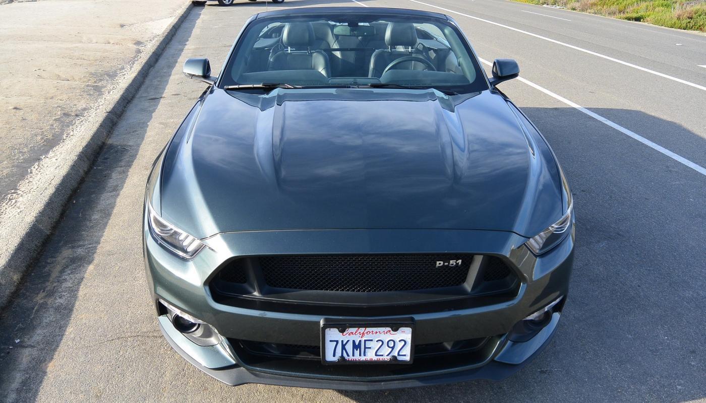

I would 110% do this again than fork over $600+ to RaceMesh.
This is why I decided to do my own.
Read plenty of comments like this about the Racemesh product being overpriced, but then I started trying to bend my mesh and thought "hmmm, I can see why they're so much now!". :lol:
That Goop stuff is available here in the UK but it's about $25 a tube! :crazy: Still, gonna have to go with the proven solution.
So big thanks for the write-up. :thumbsup:

Came out flawless!! Looks great brother! No worries about not bending the mesh. It'll hold just fine!
Great work and excellent Writeup!
