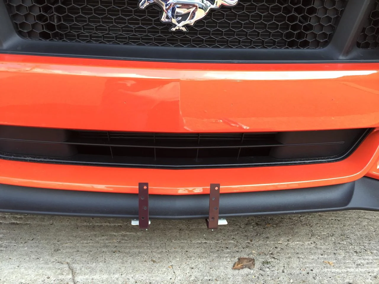

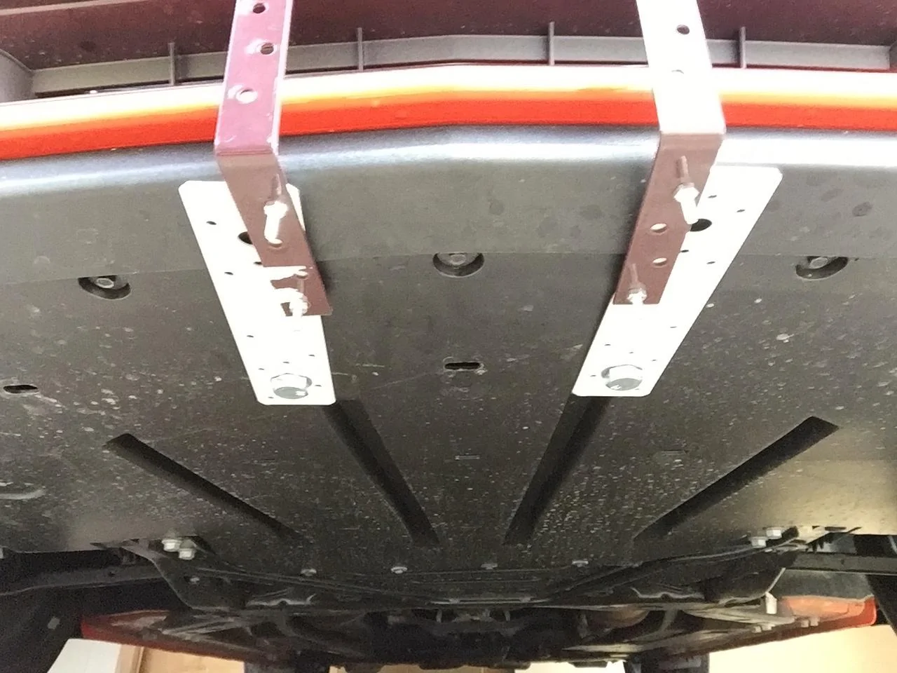

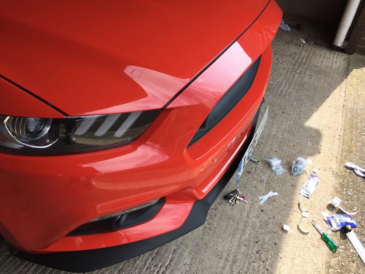

So i've had tens of people message me asking how i made my front plate holder.
It's incredibly simple, i certainly couldnt justify importing one from USA for £100+.
In total this cost me £11 and about 20 minutes. In an ideal world you'll need two L-shaped brackets, two bolts/washers/nuts. I couldn't find an L bracket long enough so i had to make my own (hence the white and brown parts).
And then double sided sticky pads for the uprights to mount the number plate itself.
It's really simple.
ps. I have a custom plate i will be swapping these out for. Can anyone tell me where i can get similar plates cut to those in the photos? I like the borderless design, and its on metal not plastic. Any help would be much appreciated as I can't find anything online.

What specifications are those L brackets?
or ideally, what would be the ideal specification? (mm x mm)
width is irrelevant.
length needs to be 16cm from screwhole to the L-bend
