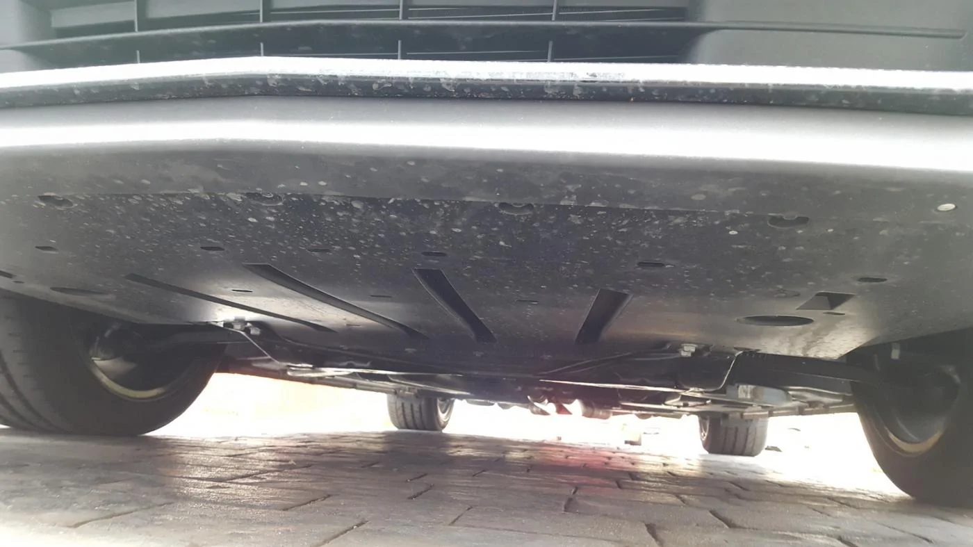

I was about to order a sto-n-sho, but I'm glad I checked under my car first because I have a completely different tray and screw hole locations and no rubber airdam! Instead of two closely located screws in the middle, I have three very widely spaced screws.
This tray looks completely different to the American cars and even older Euro cars. Change for 2016? :confused:

He does but he may have a different under-tray. I can't be the first to suddenly realise that the entire airdam is missing.

My 2016 has the airdam and probably those holes (only looked once).
Maybe it's something special for you UK folks?

We have the performance pack as standard right? These should fit but Bens defiantly looks different. Perhaps they have cheaped out on our under trays?

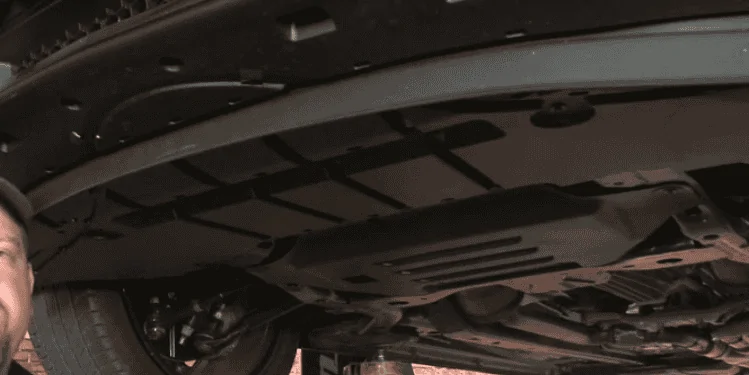

If you look at the second picture (Bill from CJPony) you'll notice a wave indent in the plastic, on some cars the rubber airdam follows that curve rather than the rubber airdam which you can see, wish I could locate that video.

Hey lads just FYI i fitted the CjPony Sto 'N Sho to mine within a week of getting the car, even though we have a different under tray it does still fit,
You need to put it on back to front from the video,
so the single hole (originally the rear) screws into the screw hole (with the supplied spacer) in center at the front, then you need to drill two holes in the undertray for the two holes now at the rear of the plate holder.
I hope this helps, i can't offer pictures at this time as i am away from the car for a bit, as soon as im back i put a picture up of how mine is fitted if my description wasn't good enough

Never occurred to me to put it on backwards :doh:
I guess I assumed the locking pin was only on one side.
Might have to import one, then. Though I've recently stuck my square plate to the middle of the bumper and it actually looks fairly decent.
