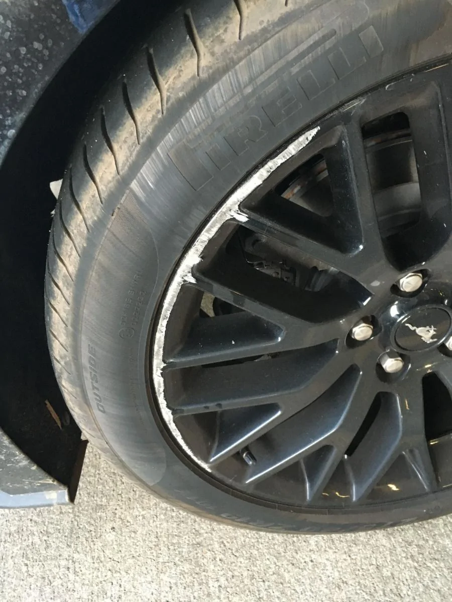

Question: what's the paint color code to match these wheels? I have a nick I want to take care of.

Check to see if there is someone in your area who specializes in wheel repair. I lightly scratched one of my Advan AVS Model F7's. It was only $75 to have fixed and was perfect.

Yea I have a guy that can do it, have some friends that have a body shop and a guy that does their stuff. Price seems like it should be reasonable there if I go that route.

Thats a good number on that wheel man,
It can be fixed, sand paper some elbow grease and your ganna want some spray gloss black and clear.

There is no Ford black wheel touch up paint that I could find under Ford Accessories. I have used black nail polish. For minor scuffs it seems to cover the blemish

It happens. I did it right after I got my Velgens. It was really due to laziness. I could have backed up a little but instead was like screw it I'm fine... not realizing that I do have wheels that extend out. I just took a black sharpy and covered it up. I will eventually sand it back down and hit it with some paint. You can't even tell into you're less than a foot away.
You could take some 300 grit and 600 grit sandpaper and smooth that out and try to find a high gloss black paint to touch it up. Just mask off all the wheel that isn't damage minus a tab bit to blend into. Stuff index cards around the lip/tire to block it from getting hit with paint.

OP..Yeah, just find a replacement. I touched mine up as best I could but we all know we are nuts about our Stangs and half ass wont cut it.

This... I had mine repaired for $60!

the repairing it yourself rout might seem daunting but its surprisingly easy and you have to be superman to tell. I actually repaired mine with one of those touch up pen things. wet sanded it with 2000 paper, and went at it with universal gloss black pen. if youre a foot away from it maaaayybe you can tell

Professional wheel repair technician.
You will never know it was damaged and repaired.
