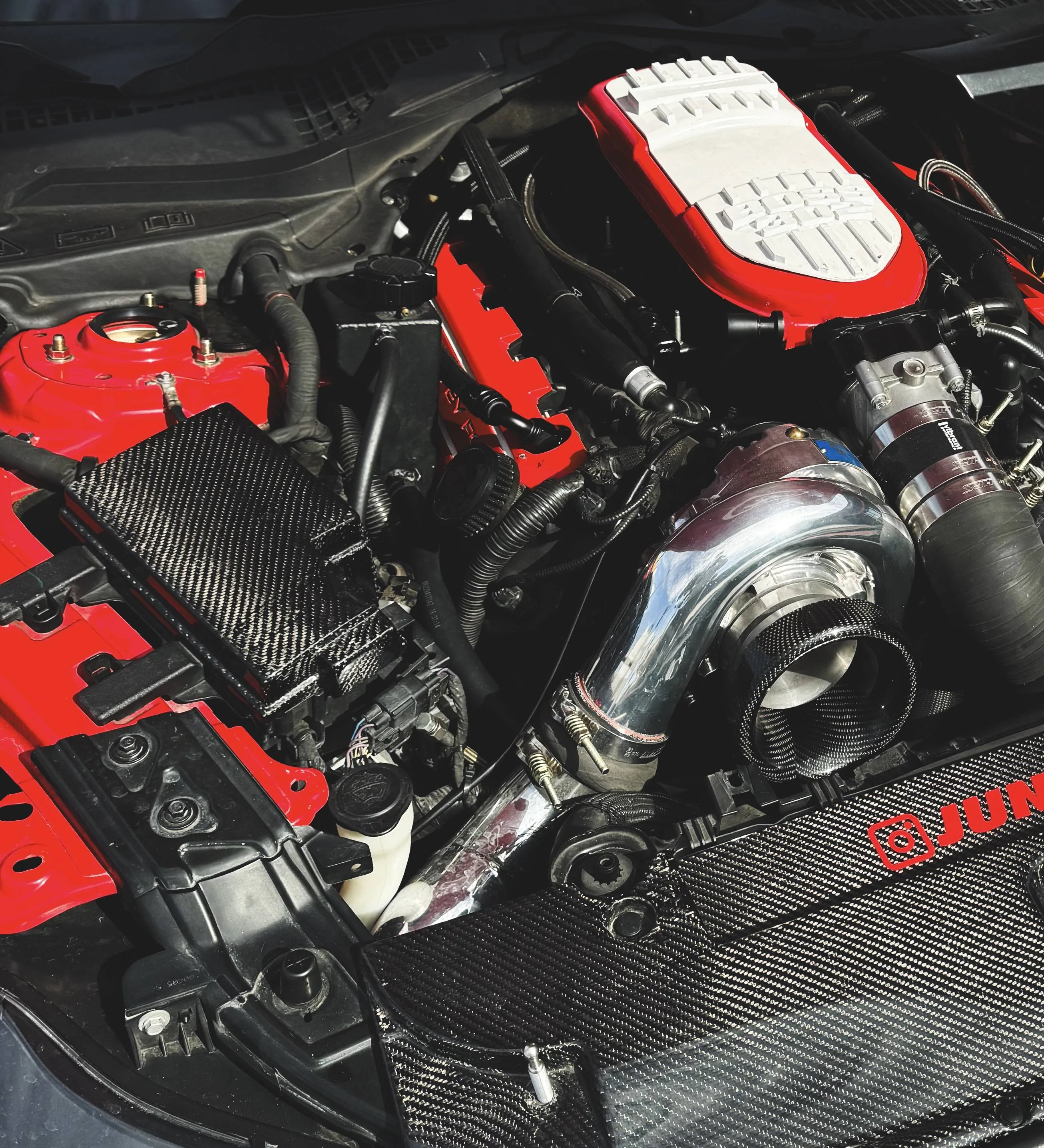

I have the same crankcase breather. No issues with clearance. Super simple.
Lovin the look!! Do you run only one of the breathers or are two needed (one on either side)?
