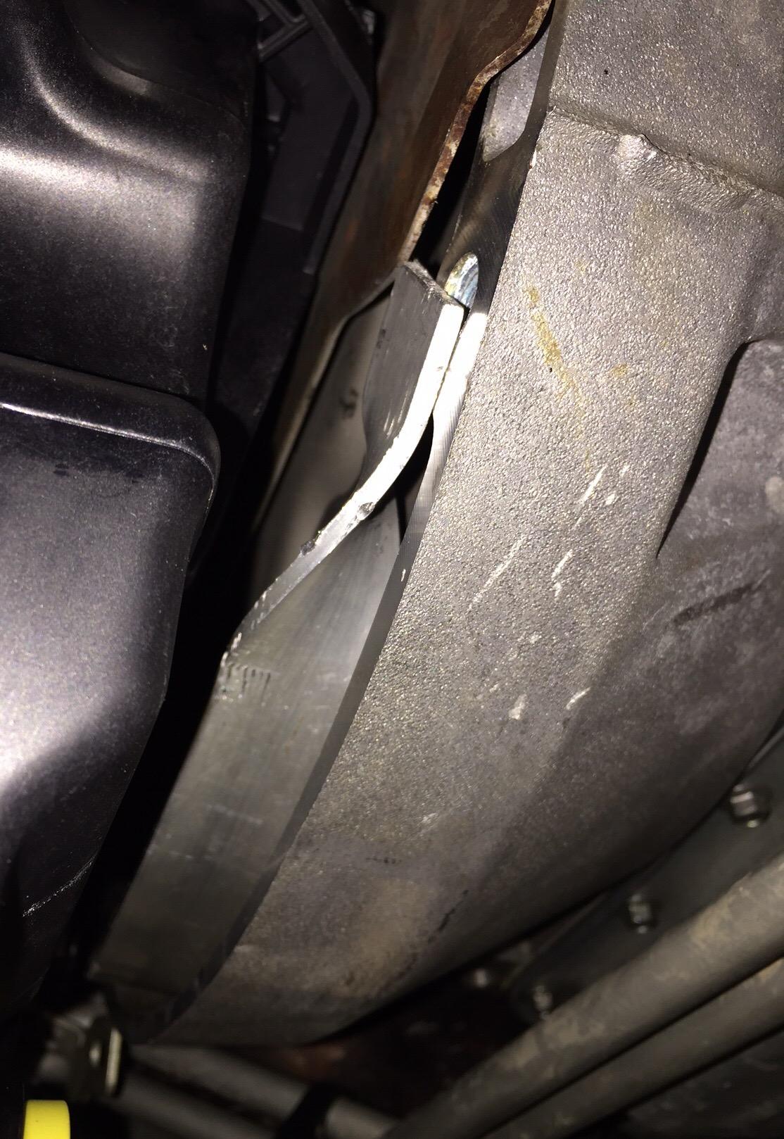

sigintel
Nov 24, 2015
2,051
1,080
Republic of Texas, God's Country
Ray
2018 GT

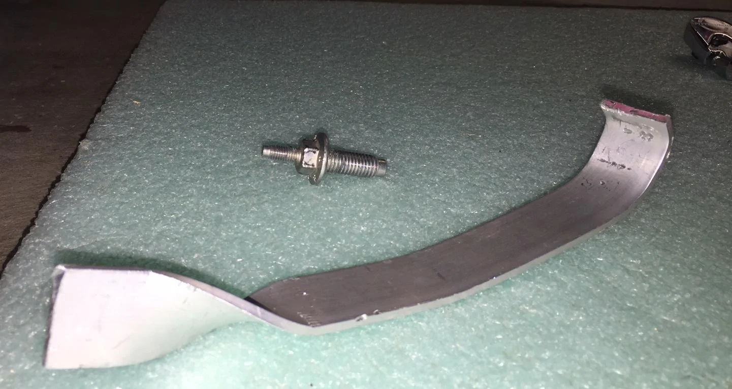

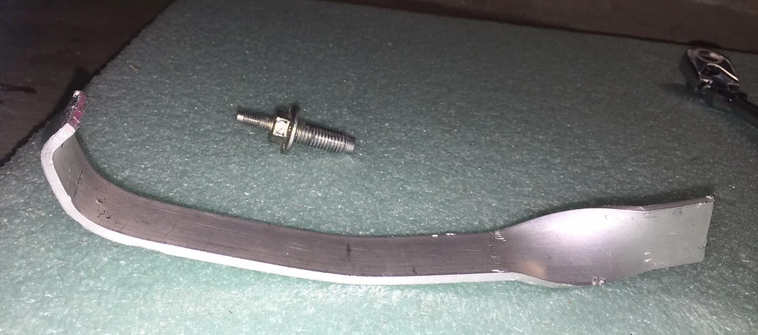

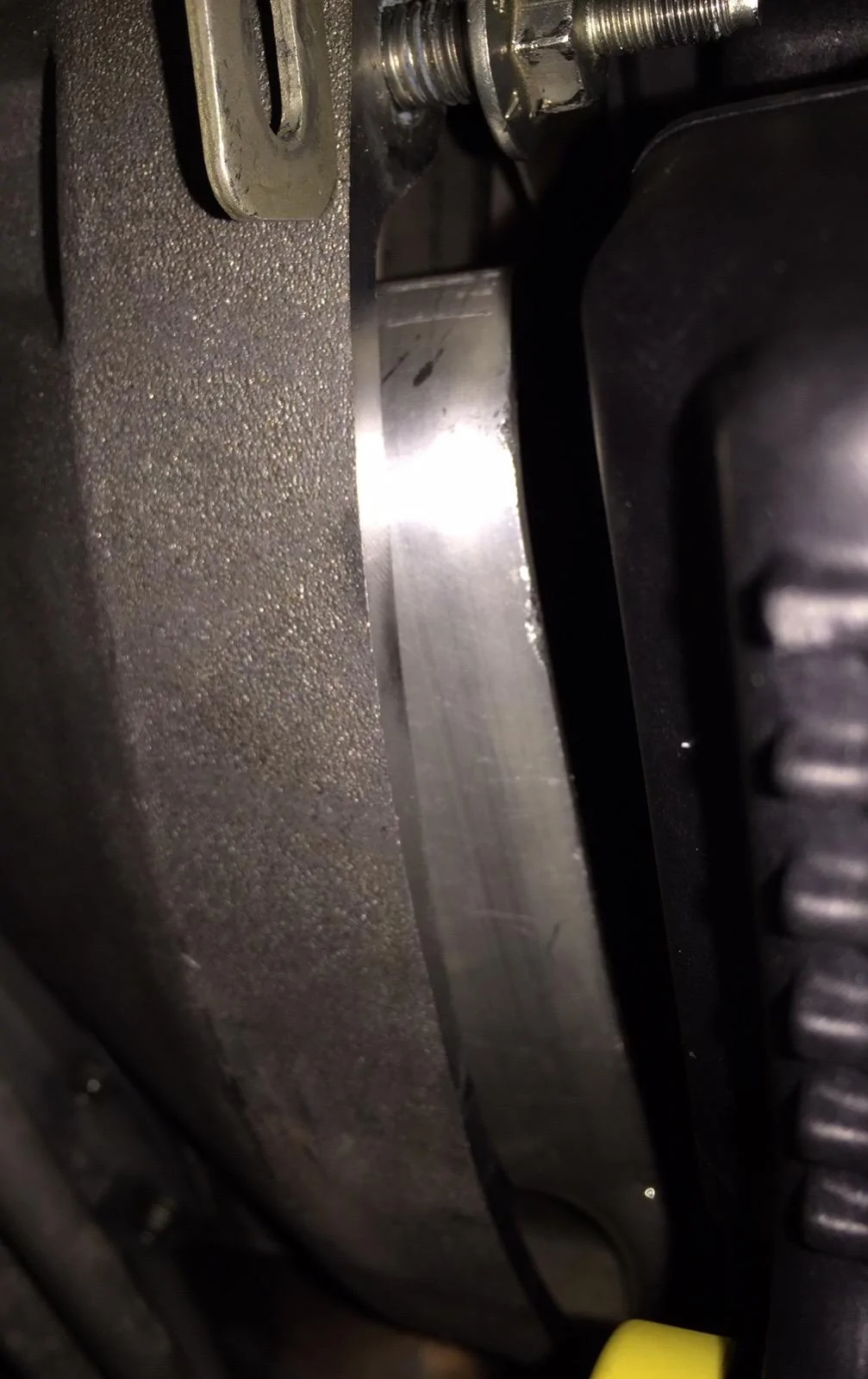

Auto? Remove the flywheel/bell housing cover easily.
Bend a piece of hardware store Aluminum strip in a 6 inch piece in somewhat of a Z shape so end of z engages a flywheel starter tooth and bend keeps piece tucked into bell housing.
