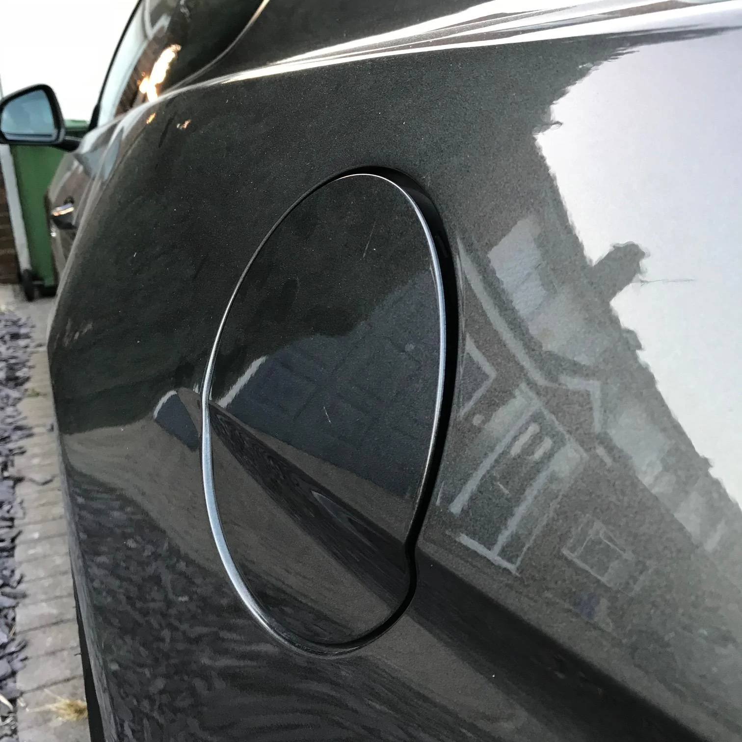

Hate to post these kinda threads but seeking advice/reassurance/peace of mind.
1. went to fill up tonight and as I opened the petrol cap/door it kinda clicked and felt like something snapped. Now it doesn't seem to sit as flush as it did before; couple mm out at the top and couple in at the bottom, very noticeable to me at a glance. Checked old photos on my phone & it was definitely nice & flush before.
To save me faffing around and posting a video. I found an old one from some US guys; https://www.mustang6g.com/forums/showthread.php?t=32636&highlight=gas+door+hinge
20 seconds in - mine moves like that now & isn't as smooth as before. Has anyone else come across it? Consensus on that thread seems to be its an easy dealer fix, but the thought of going back in to Ford scares the sh1t outta me quite honestly - especially for a simple thing! Just wanted to see if anyone else has had this in the UK...

fill flap fix yourself just buy the part and do it safer than trusting ford.

Ditto the advice on the flap. Talk to Dave about exotic box fluids.

Caught a youtube vid last night where a guy had taken off the door/hinge assembly. I'm all for DIY but it looked like a bit of a pain in the ass & not really something I would like to try myself. That said, I sure as hell wouldn't take it back to the last dealership I went to. I remembered this morning that Ford in Hungerford are well set up for the Mustang & have good experience. Not sure if they will do warranty work :shrug: I'll give em a call I think. Very convenient for me as I work a 10 min drive away.

For reference, this is the fuel door now...as you can see - sticking out slightly at the top & the opposite below.

Update: taking it in to Ford Hungerford for an initial look Thurs/Fri. Provisionally booked in for the warranty work 26th July - giving them enough time to grab the part :)
Appreciate all the posts re gearbox - feeling better already! Glad to have learnt that the fuel door thing is an easy part swap too.
