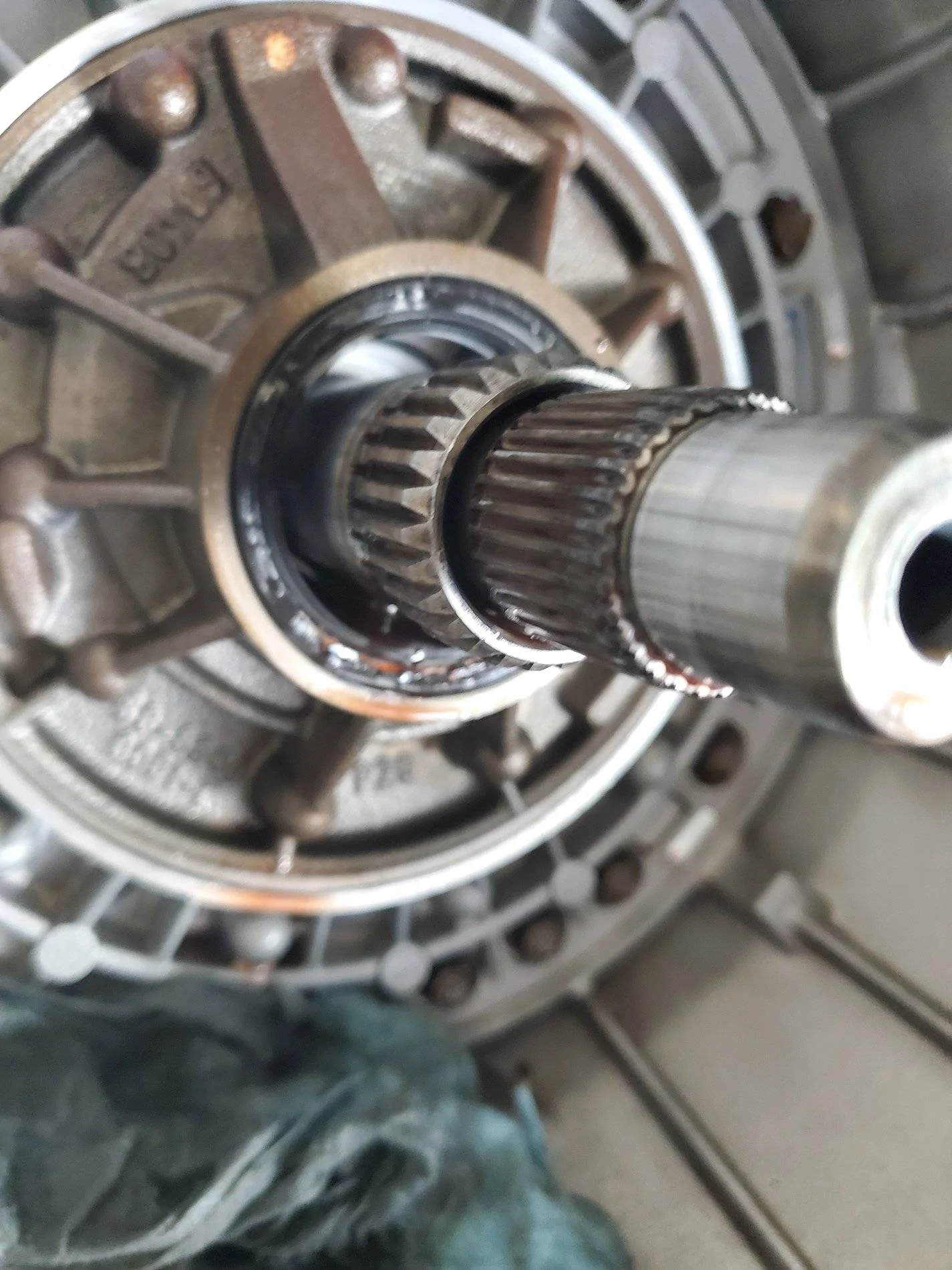

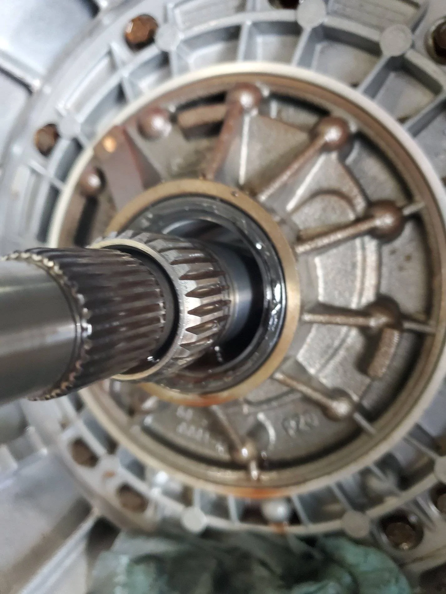

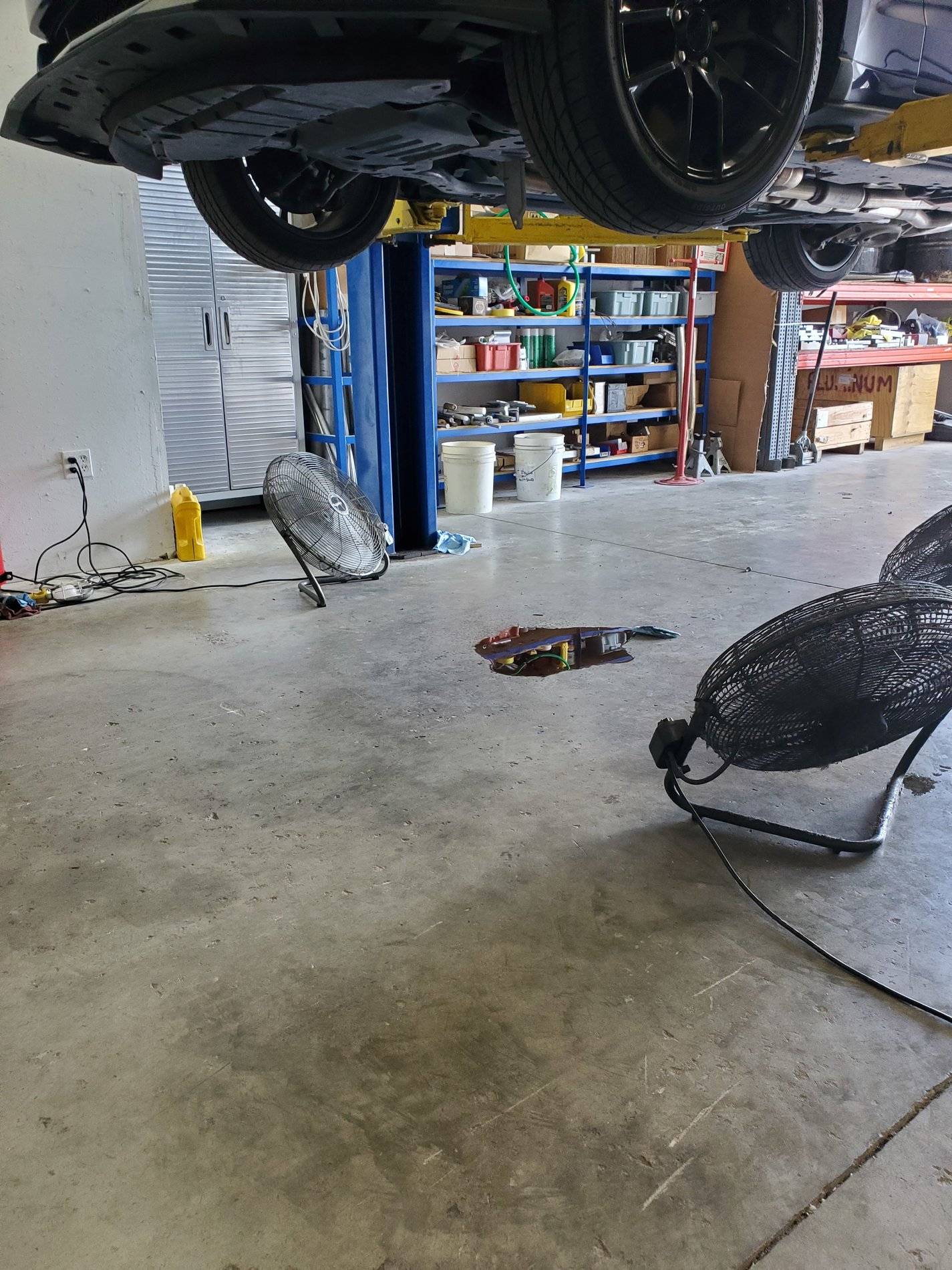

Got converter in & it tore the torque converter seal. They had to take tranny back out. After inspecting it appears wrong 1 was sent. Hopefully FTI will give me the correct 1 or refund $. Bought it from @LethalPerformance on 2/19/2019. Yes I sat on it but part has been sitting in box whole time. Lost $ on install/putting stock converter back in.

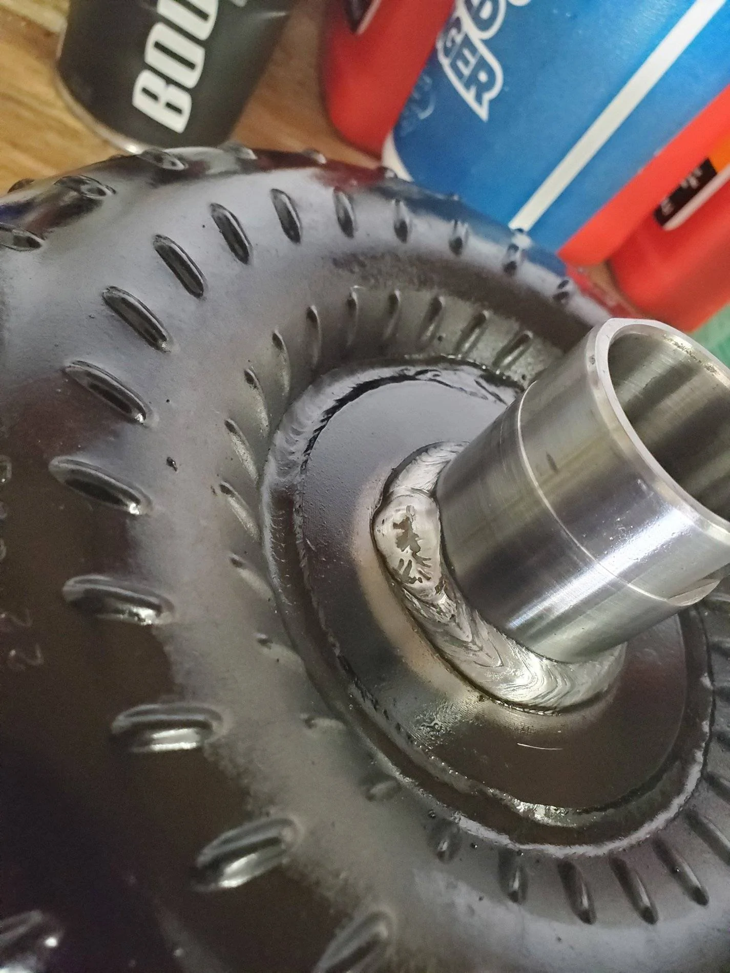

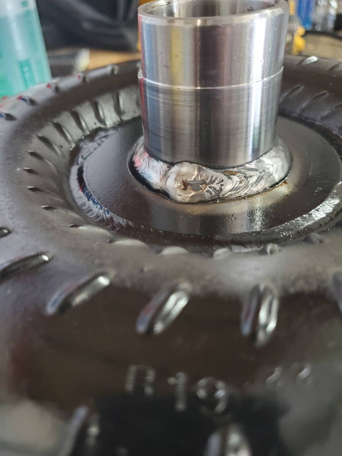

Here are some pics.

@gameovergt same exact thing happened to me. When i called FTI, they blamed faulty install, said i had an early model 6r80, then they finally said kiss off. Was a pain in the ass getting my money back. I lost the cost of install also. Key dimensions were different versus my Circle D converter. FTI sold me a shit converter and thats a fact.

just got off the phone with John @FTI he asked me to email pics of the converter which I did.

Update: just for email from John Boxell, can't tell the converter is bad from pics. Wants to know if I want to send back in for check? said I am out $ for the install and just refund & asked how to proceed.

Dalton FTI's sales person is admitting its bad in emails, says will fix for free. But I have to ship back to them at my cost & I also lose the cost of install.
